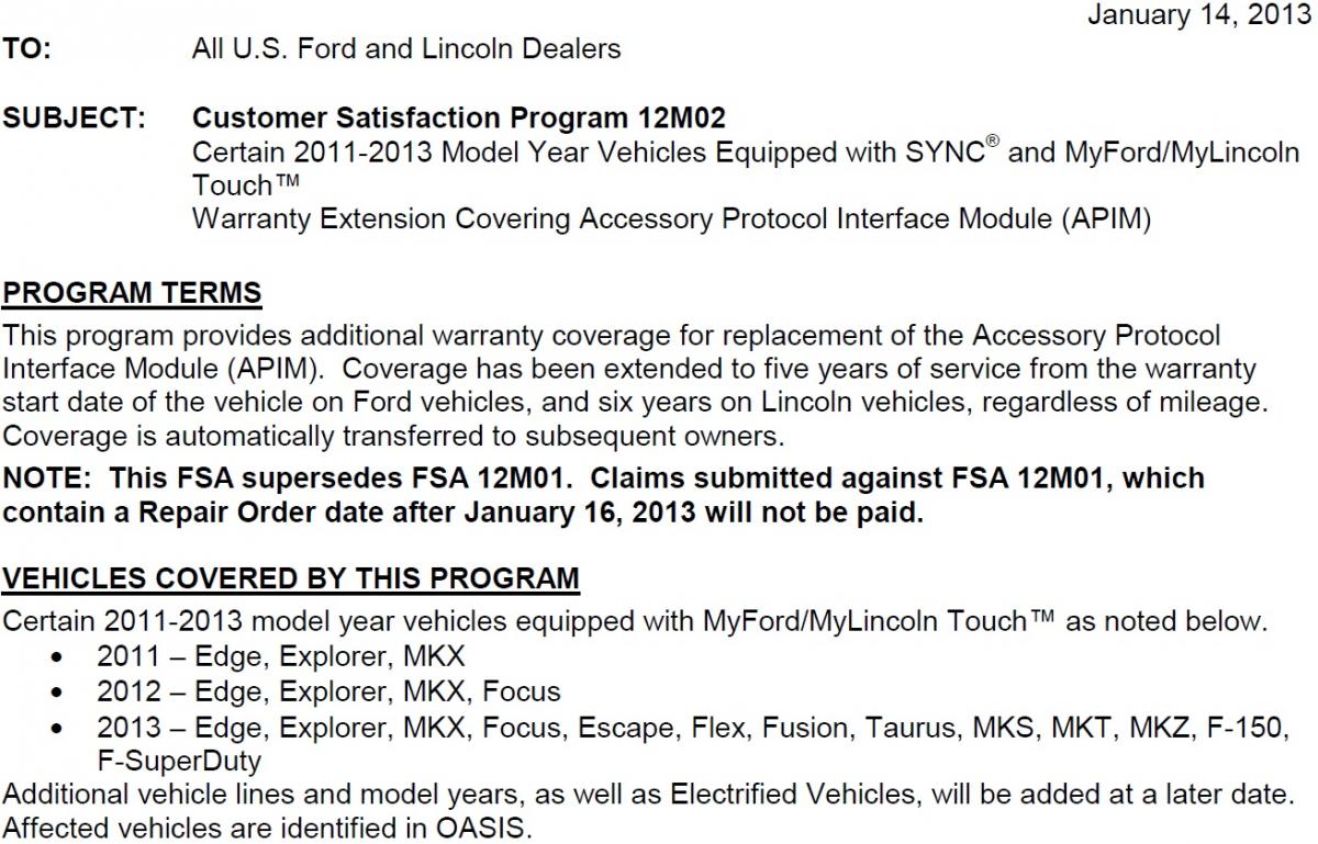

This thread is strictly for parts questions, as in which parts fit my car, what is the cost, etc etc. :) THAT Benny can help with!
http://www.fordedgeforum.com/topic/10937-employee-pricing-on-all-parts-accessories/
As to your question, please find attached the document for 12M02
so unfortunately, it does not look like your Edge has APIM warranty coverage anymore.
If you use owner.ford.com, you can check outstanding actions/warranty extensions for yourself.
https://owner.ford.com/tools/account/maintenance/recalls.html
