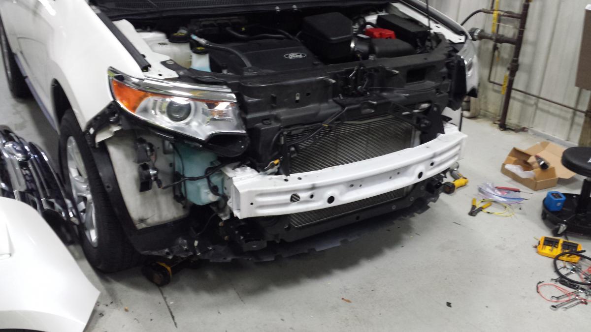

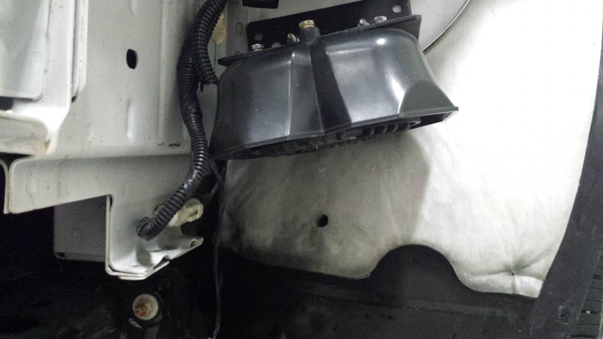

With research that I have done, I am planning on taking the front bumper cover off to make it easier to access and mount the siren speaker. I appreciate the videos and info. I want it all concealed for the most part. I will post pictures and such as I move forward. Thanks again!

I had about 6.5 hours or so into it....I had some trial and error in the speaker location with the bumper cover.
