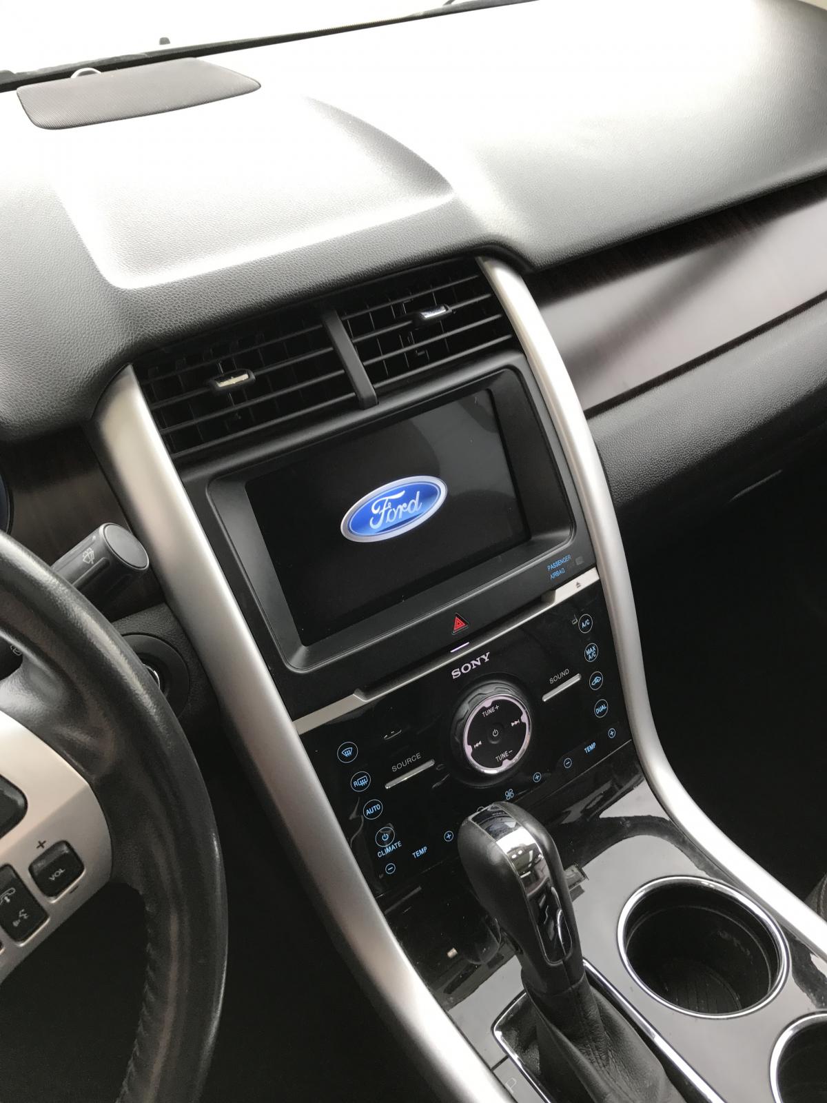

Hi everyone. After following the guys over at 2GFusions on how to install Sync 3 in a 2013-2016 Fusion, I decided that would be the first modification to my Edge once I got it this weekend. I knew I'd get the car so I already had the radio purchased and ready to go - and good thing I did because the Sync 2/MFT system actually died before I even got the car. I believe the APIM was shot.
Anyways, I scored a basically new/barely used Sync 3 nav unit off eBay for a great price ($480). It still had the protective cover that says "to be removed by customer" on the display. As of right now, it works flawlessly and I see no issues whatsoever.

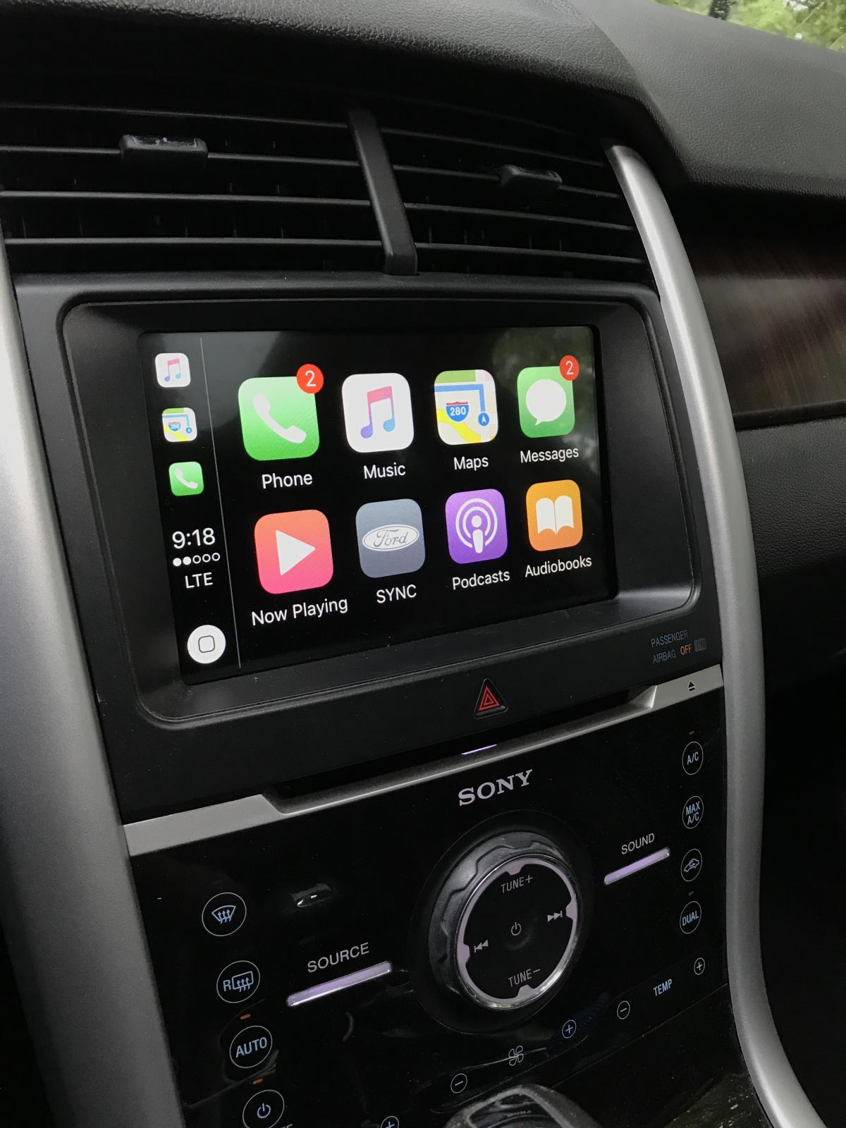

Sync 3 dual USB port - this is needed because it has Apple CarPlay authentication chips. When using the current/old USB and SD card hub, Sync 3 will give you an error message every time you start the car. But I do believe it still works for Android Auto and other USB functions despite the error message.

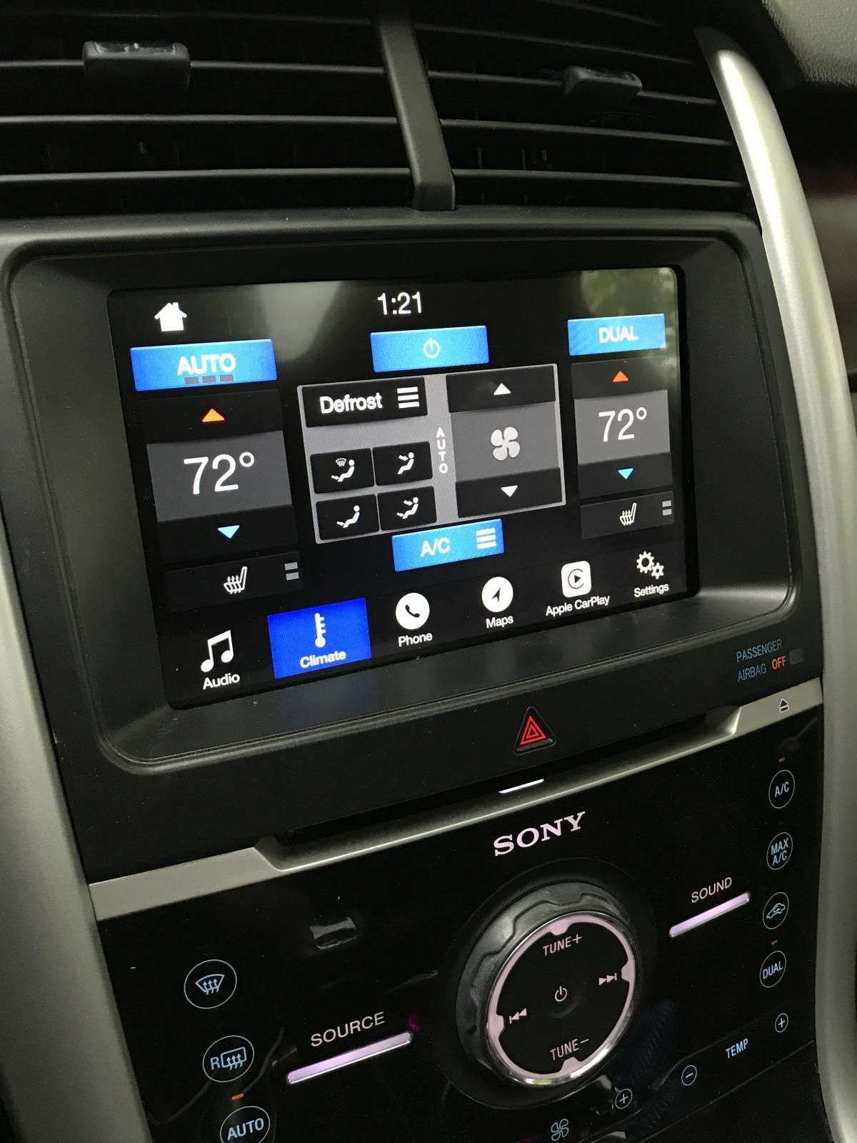

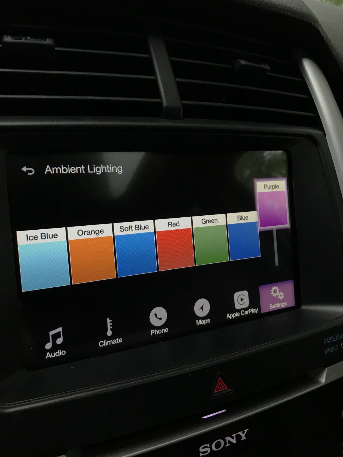

Once you get it installed, it will need to be programmed to your vehicle to make sure all functions operate correctly (climate, heated/cooled seats, ambient lighting, etc.) I managed to tinker enough with mine using FORScan software and an OBDLink MX adapter, but it did take about an hour of trial and error and I think I got lucky because I really had no idea what I was doing. When I first installed it, the climate screen was unresponsive, the heated seats buttons were gone, there was a Vehicle Charge screen (must have came from a Fusion Energi), and I had no ambient lighting options. But after a while of messing with the as-built data, I finally got exactly all the features my Edge has, and got rid of the charge screen.

If only it were that easy! Unfortunately, even inputting your own AB data from that website will not get Sync 3 to fully work. Some of the values just don't carry over from Sync 2 AB data to Sync 3 - however, I think using your own AB data is a good start. I spent a lot of time comparing values from my 2012's AB data and values from a 2017 Edge equipped exactly the same as mine (albeit with heated steering wheel and cooled seats) and managed to eventually tweak it enough to be 100% compatible. It takes trial and error though.
In todamgood4U's case, his Edge already has all the same options mine did, so he did not need to program anything when he got it. It was completely plug and play. But in most cases, you will need to tweak the AB data to get everything working 100%.
