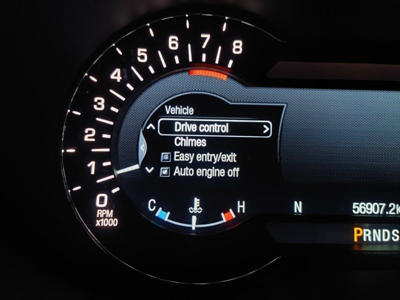

Sunnyorlando Report post Posted November 8, 2022 On 10/29/2022 at 6:16 PM, Sunnyorlando said: Hello all... I'm familiar withe BCM changes using the VW group VagCom (Ross Tech) interface. Many options, some now I'd like to see if I can change similar option in my Edge. Are there Forscan settings for these: > Set default audio volume when ignition turned on (via ignition or audio sys on) > Always display gears on dash by the tach (or anywhere). Had this in VW, shows the transmission gears as they change, not just when using paddles. > Flash center brake light when braking - attention getter > Close windows with remote (already opens front). > Open/close all windows not just front. > Sunroof - open shade only half way (to the bar or so) and be able to open sunroof. > Control footwell accent light intensity These to start, thanks. I'm adding a solution to one of my questions above - just figured it out. > Control foot-well accent light intensity, no forscan needed >> I was fiddling around the other day and while playing with the color options fro the accent lighting, I noticed that the accent color picker squares also slide up and down - because its a dimmer control! I'm kind of surprised nobody had figure that one out... On to the next one. Share this post Link to post Share on other sites
redden18 Report post Posted November 8, 2022 48 minutes ago, Sunnyorlando said: I'm adding a solution to one of my questions above - just figured it out. > Control foot-well accent light intensity, no forscan needed >> I was fiddling around the other day and while playing with the color options fro the accent lighting, I noticed that the accent color picker squares also slide up and down - because its a dimmer control! I'm kind of surprised nobody had figure that one out... On to the next one. I guess because everybody knew that since Sync 2. Share this post Link to post Share on other sites

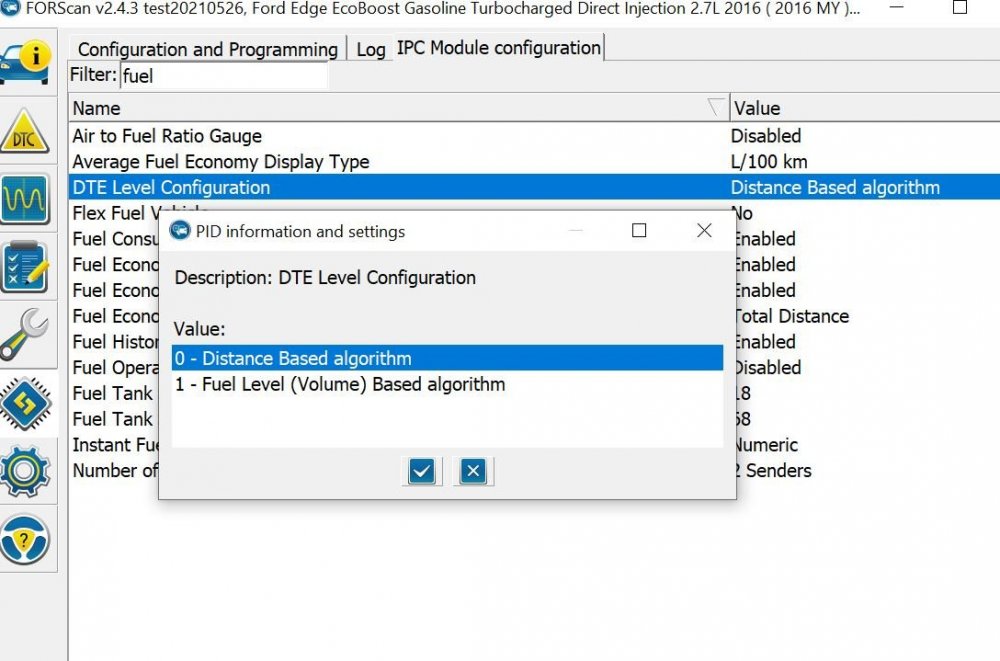

Sunnyorlando Report post Posted November 18, 2022 @omar302 how is it that you screenshot shows v2.4.3 but the Forscan site is on 2.3. I don't see the search box in 2.3.49 (current v as of 11/18/22) Share this post Link to post Share on other sites
onyxbfly Report post Posted November 18, 2022 (edited) 5 hours ago, Sunnyorlando said: @omar302 how is it that you screenshot shows v2.4.3 but the Forscan site is on 2.3. I don't see the search box in 2.3.49 (current v as of 11/18/22) Not wanting to speak for Omar, but I think he may be running a beta version. I'm sure he will chime in when can and let us know. Edited November 18, 2022 by onyxbfly Share this post Link to post Share on other sites
vega Report post Posted November 19, 2022 (edited) 2.4.3 was a beta which was released, but then taken down due to abuse by novices who bricked certain modules. For a while, you could request a link if you had an extended or life time license. This 2.4.3 allows you to program modules. 2.4.7 is the latest but if you want to flash anything, it is preferred and recommended that you use a VCMII or VCMIII to do so. I do and have had no problems You can find download links to the 2.4 series here: https://forscan.org/forum/viewtopic.php?f=13&t=19552 USE AT YOUR OWN RISK. 2.4.6 may cause problems and 2.4.7 will cause problems. 2.4.3 is best for now. Remember, Use a VCM not the Elm if you are going to program to be sure. . Edited November 19, 2022 by vega 1 Share this post Link to post Share on other sites
omar302 Report post Posted November 19, 2022 @Sunnyorlando Yes, it is a beta version just like what @onyxbfly & @vega stated. But the search box should be there in all versions. I'm surprised it is not showing for you. 1 Share this post Link to post Share on other sites

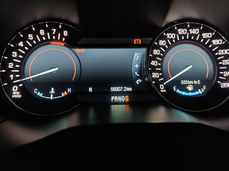

Sunnyorlando Report post Posted November 19, 2022 I kind of figured it may have been a beta version, but when I didn't see it on the site then I wasn't sure. Often beta versions are offered to be downloaded. After the search box, don't know whatwas happening. So I uninstalled.and reinstalled and now it's there. I've successfully tweet some of the settings on some basic things only while I familiarize myself with a tool. Things that have worked for my '17 Edge sport that are from my original list are: > Rear wiper swipe when in reverse if front wipers are on. > Lane change flashing turn signal from three to four flashes > Side mirrors tilt on reverse > Roll up windows with remote > Emergency horn from remote control from one click to two clicks. This was annoying because I already accidentally turned it on with one click several times. So I'm glad I was able to change that one. That's all I've played with for now. Now that I understand more about the tool I'll be working on trying to get some other features set up and see how that goes. Q - anyone know if the halogen high beams can be activated to complement the hid high beam? Currently the halogen high beam is used for DRL only. I'm wondering if it can be activated so it comes on with high beams because the hid high beams are not really all that good at all by themselves. Thank you all. Share this post Link to post Share on other sites
