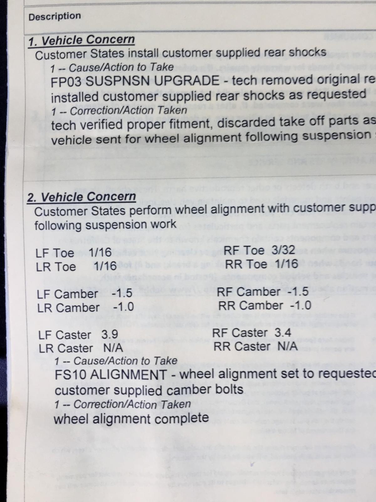

Xtra Report post Posted March 4, 2018 Finally got the car back with the Michelin Pilot Sport 4S tires installed I like the ride and in the wet they have very good traction. While I was at it I also had the car aligned and had the front camber bolts installed that Mikula recommended . The new bolts allowed an alignment by Galpin Auto Sports Performance Department that will work better in the canyons than the stock setup . I will post the alignment numbers later. I can't wait to get in the canyons on a dry day to see what the PS4S tires can really do . Share this post Link to post Share on other sites
Mikula Report post Posted March 4, 2018 Finally got the car back with the Michelin Pilot Sport 4S tires installed I like the ride and in the wet they have very good traction. While I was at it I also had the car aligned and had the front camber bolts installed that Mikula recommended . The new bolts allowed an alignment by Galpin Auto Sports Performance Department that will work better in the canyons than the stock setup . I will post the alignment numbers later. I can't wait to get in the canyons on a dry day to see what the PS4S tires can really do . Did you go with a bit extra negative camber in the fronts? Share this post Link to post Share on other sites

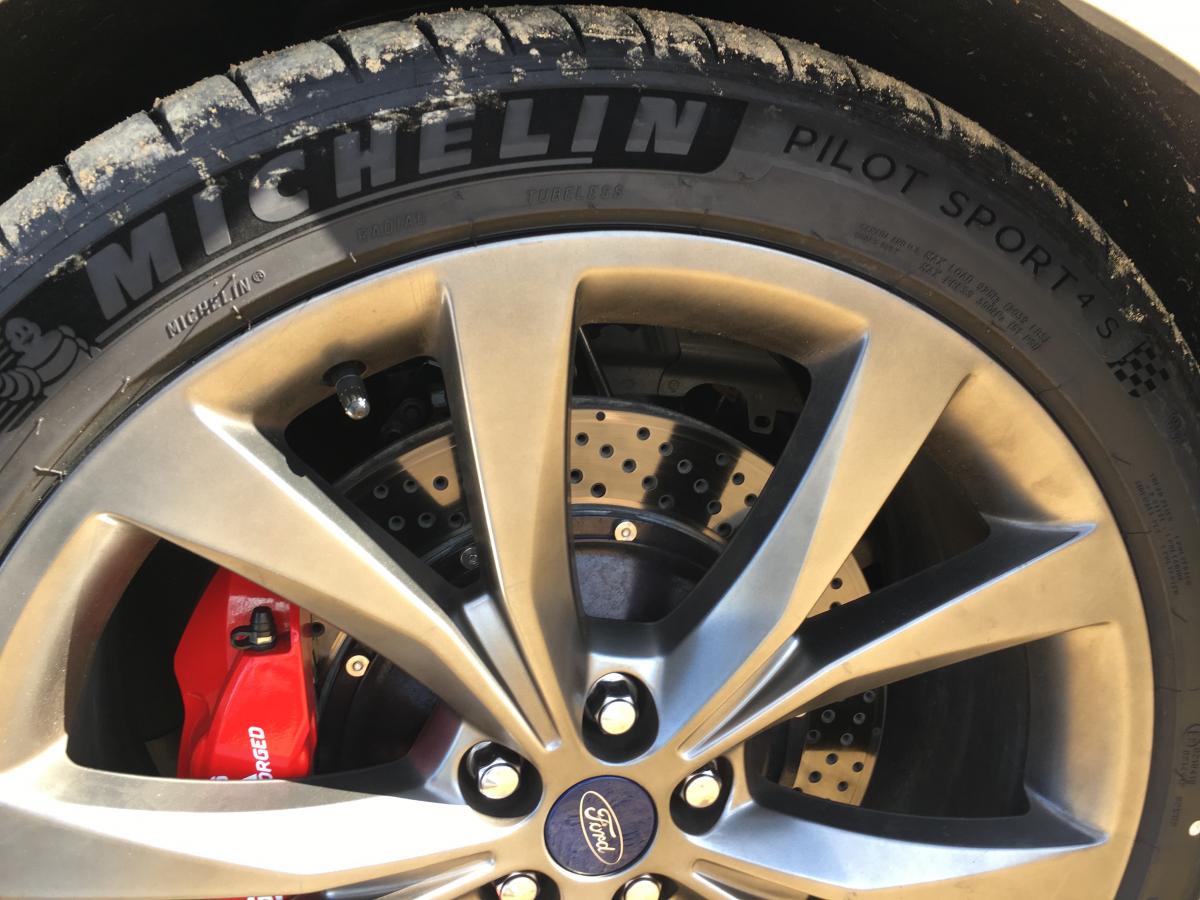

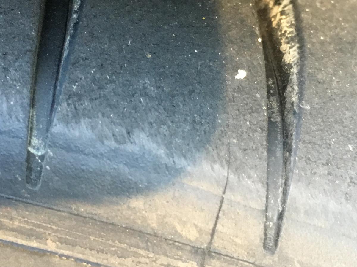

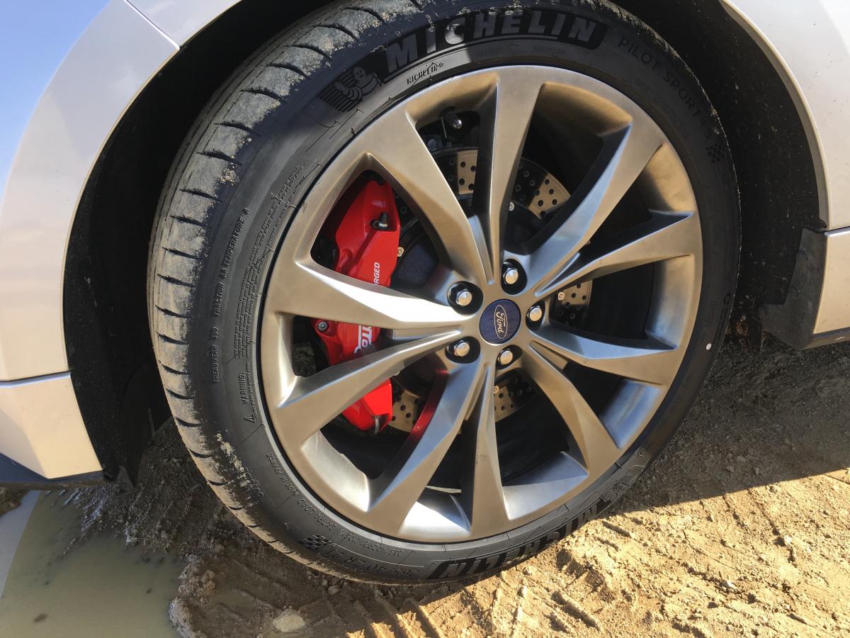

Xtra Report post Posted March 5, 2018 (edited) Ok then.... I just got back from a test run. The new tires, alignment, new rear shocks, transmission flush and the V3 tune have just paid off with huge improvements. My old best time ever was a 1:07 and that was what I thought was the max possible. I ran that 1:07 at the end of last summer after I had been running almost every weekend. I just ran a 1:04 the first time out with the new set up :happy feet: . I have not run that road in a couple months and am very rusty. I could only get one run in as the CHP showed up to spoil the party. The PS4S tires kick butt and the V3 tune has them begging for traction coming out of the corners. My old Scorpion tires use to squeal through the cornrers , now my tires squeal coming out of the corner when I get back on the gas. I would recommend the PS4S to anyone looking for a great summer tire. Here is the chassis set up : Michelin Pilot Sport 4S 265/40R21: This is how they look after a run, sticky stuff : Edited March 5, 2018 by Xtra Share this post Link to post Share on other sites
Xtra Report post Posted March 5, 2018 (edited) Almost forgot, the tires squeal through most of first and second gear now under hard acceleration. No rubber patches or smoke, just this bitchen sound of the tires fighting for grip. . It might have been the condition of the road that caused it because the road had just dried out from some overnight rain. Edited March 5, 2018 by Xtra Share this post Link to post Share on other sites

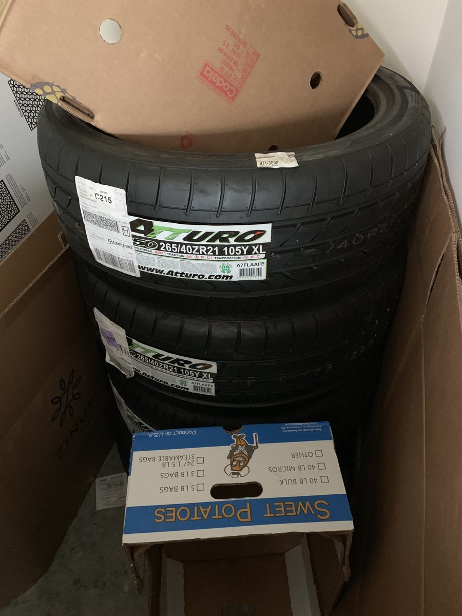

1004ron Report post Posted December 6, 2021 (edited) On 7/5/2019 at 9:54 AM, onyxbfly said: Thanks for sharing! That's a great deal. I wish they were all season tires. The best price on these now is at Walmart for $153.74 and tires bought from them they'll fit for $15 each. Atturo AZ850 Performance Tire - 265/40R21 105Y - Walmart.com I'm going to buy a set now, but will only need to install in about 6 to 8 months. Edit: What's the waring about not to buy from Walmart or Amazon? Online Dealers - Atturo WARNING: DO NOT BUY ATTURO TIRES FROM AMAZON, WALMART OR OTHER UNAUTHORIZED DEALERS. Edited December 6, 2021 by 1004ron Share this post Link to post Share on other sites
onyxbfly Report post Posted December 11, 2021 On 12/6/2021 at 12:39 PM, 1004ron said: The best price on these now is at Walmart for $153.74 and tires bought from them they'll fit for $15 each. Atturo AZ850 Performance Tire - 265/40R21 105Y - Walmart.com I'm going to buy a set now, but will only need to install in about 6 to 8 months. Edit: What's the waring about not to buy from Walmart or Amazon? Online Dealers - Atturo WARNING: DO NOT BUY ATTURO TIRES FROM AMAZON, WALMART OR OTHER UNAUTHORIZED DEALERS. Those are some sharp looking tires. If they perform half as good as they look you should get your monies worth! Share this post Link to post Share on other sites
