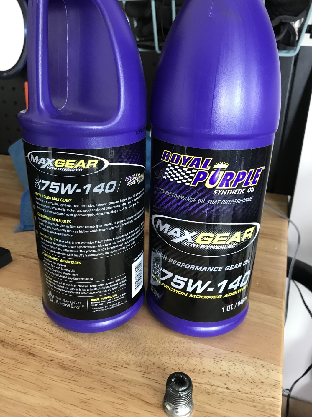

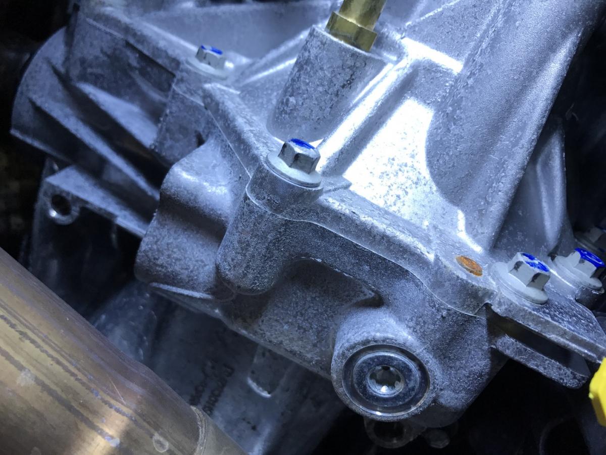

Today I changed engine oil, oil filter, and PTU oil at 5,200 mi.
The PTU oil change was real easy with the drain fitted on these later models.
As can be seen in the photo, the oil blacken the paper towel and there was a few filling attached to the drain plug magnet.
I used Royal Purple 75-140 synthetic, and will most likely change it every 10 ~ 15K

I would actually pull the fill plug and take a small sample to investigate before I went to the full change out. RP is supposed to be some good stuff. It might have a lot longer life then the factory stuff.
Thing is if you go to that much effort to check it...why not change it? (especially if you have a drain plug)

I have a 2016 EDGE with AWD, when did Ford start putting a drain plug in the PTU?
You don't say which model Edge you have.
As far as I know, Ford started installing the drain plug from 2015 in the Sport, but have no idea if this applies to the other models.
