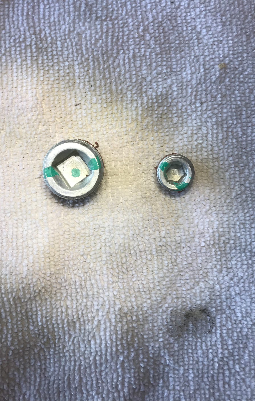

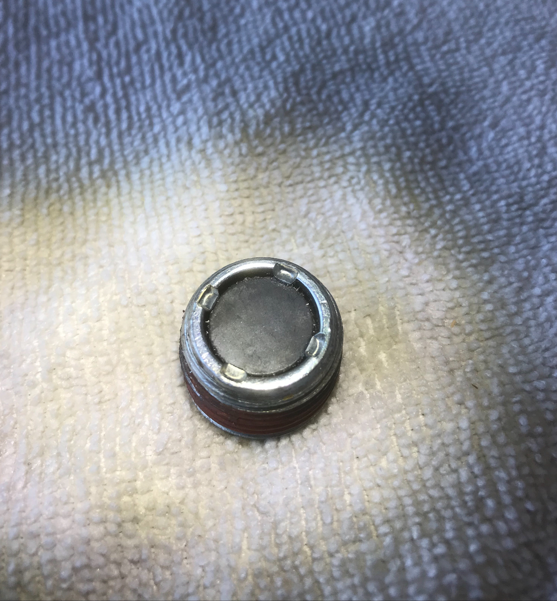

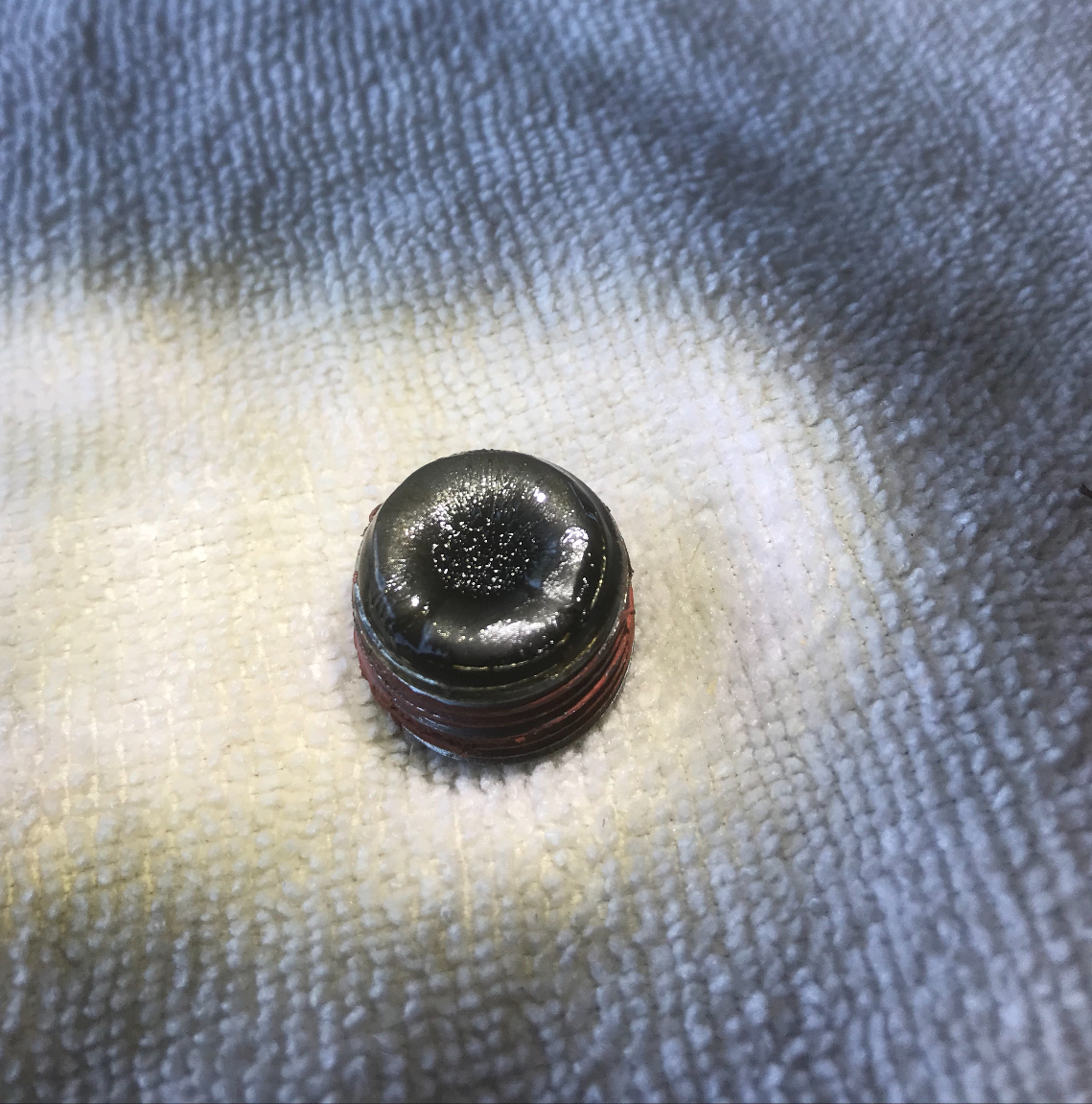

Tightanium Report post Posted May 28, 2018 (edited) The Sport had the only CONFIRMED drain plug at that time, the others also are now confirmed.I have a 2016 Tightanium 3.5. It does have a drain plug. The fill plug has a magnet on it also. The dirty plug has lots of metal on it. Edited May 28, 2018 by Tightanium Share this post Link to post Share on other sites
1004ron Report post Posted May 28, 2018 I have a 2016 Tightanium 3.5. It does have a drain plug. The fill plug has a magnet on it also. I'm pretty sure that only my drain plug has a magnet. Good to hear that all models now have drain plugs - wonder if Ford is still claiming them to be lubricated for life. Share this post Link to post Share on other sites
Tightanium Report post Posted May 28, 2018 The small plug near bottom is a drain plug. Share this post Link to post Share on other sites

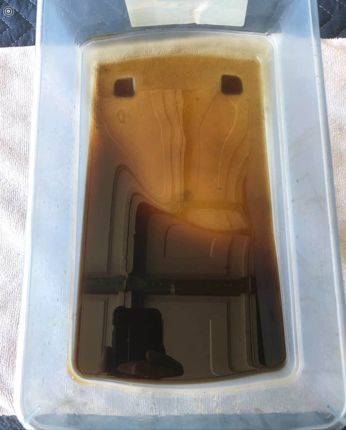

Tightanium Report post Posted May 28, 2018 A little more then 11oz came out. In my opinion the fluid was ok at almost 28k miles. On my car its not to hard to do so no big deal to do it every 30k. But it probably would last longer. The size difference of plugs also. Share this post Link to post Share on other sites
1004ron Report post Posted May 28, 2018 (edited) A little more then 11oz came out. In my opinion the fluid was ok at almost 28k miles. On my car its not to hard to do so no big deal to do it every 30k. But it probably would last longer. The size difference of plugs also. Your oil looks better than mine did at 5K and 15K, and sure doesn't look like it was in need of a change. Your PTU looks different to mine and to @JSchneid His casing looks very different and his plugs are the same type of torx T50 as mine, with the drain on the underside. Odd that there's all this variation. Edited May 28, 2018 by 1004ron Share this post Link to post Share on other sites
Tightanium Report post Posted May 28, 2018 Your oil looks better than mine did at 5K and 15K, and sure doesn't look like it was in need of a change. Your PTU looks different to mine and to @JSchneid His casing looks very different and his plugs are the same type of torx T50 as mine, with the drain on the underside. Odd that there's all this variation. I was surprised how good it looked also. Maybe build date or plant has something to do with the different ptu’s 4/16 Oakville plant is mine. Share this post Link to post Share on other sites
