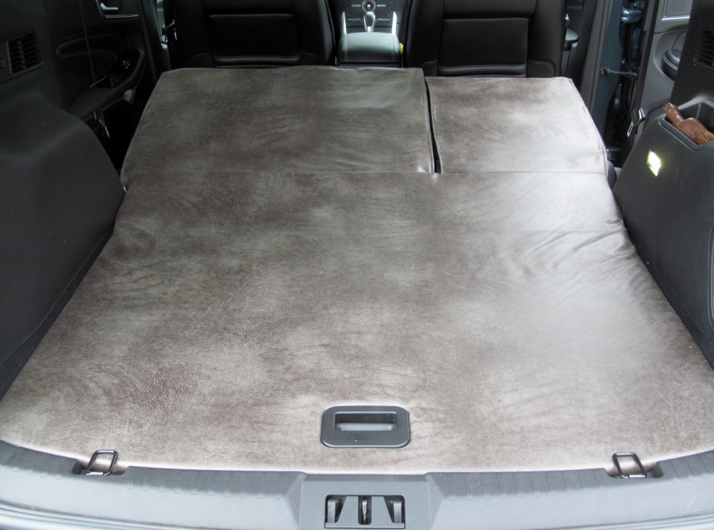

I hated that the seats didn't fold flat, so here is what i did for my dog. i made a platform and posted about it on this site. it was a nice weight reduction as well.
http://www.fordedgeforum.com/topic/22816-2016-sport-rear-seat-delete/
  • Like 2

everyone is different. I enjoy projects like that. I was a welder/fabricator for years, and just recently started to try working with wood. it was a saturday project that i'm 100% sure my dog does NOT appreciate. like your pup, i'm sure she could care less!
side note though, if you ever build a platform, don't cover it in a waterproof outdoor material. sounded like a great plan at the time. give it a little gas from a red light and she slides all the way to the hatch no matter how much she tries to dig her nails in. learned that one the first week!
