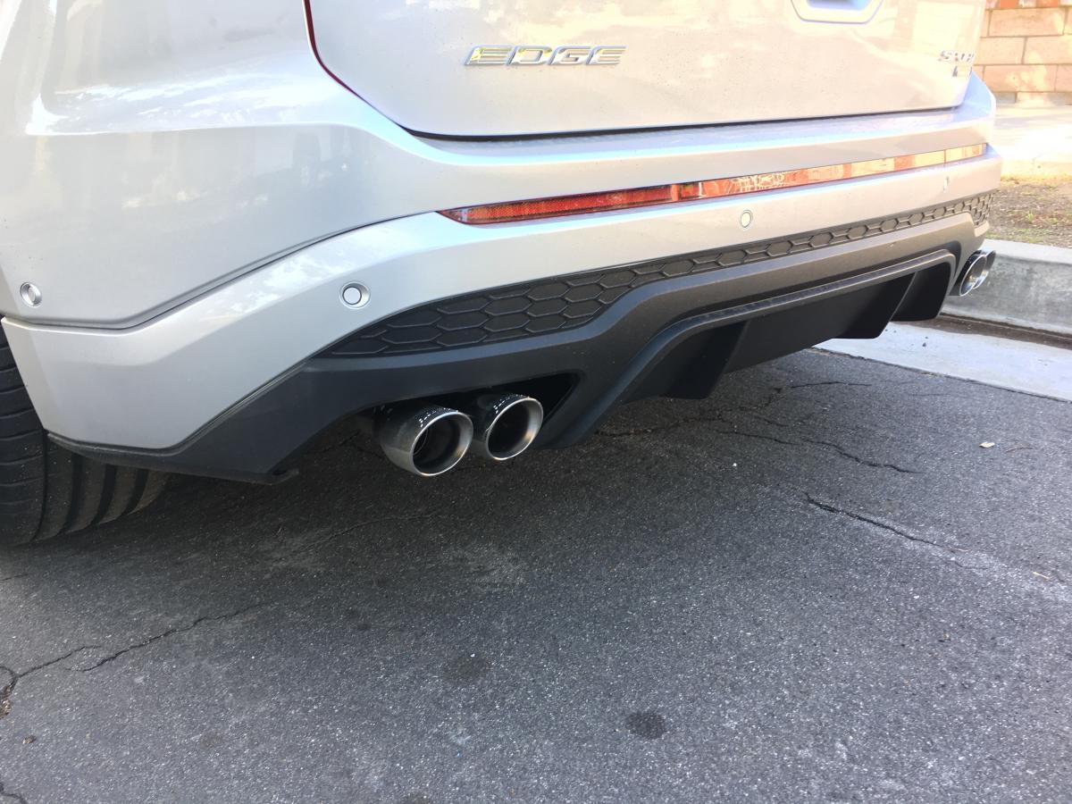

In this one photo you can see a H&R Blue Coil Spring, the MRT Axel Back Muffler and the mods to the exhaust pipe for the new Duel Flowmaster Tip . You can also see where the clips were cut away that held the stock chrome bezel. And last but not least new Michelin Pilot Sport 4S Tires.
It was raining and dark when I picked up the car so I only have the one photo, I will post More photos and give a report when the sun decides to shine and I can test it out, so far I like the sound and looks of it.

did the tips actually help with sound? I don't have a before/after for obvious reasons, but just curious in your case.
Yes it is quieter in the cabin over all as now the sound is exiting out beyond the bumper instead of under it. I drove hard today so I did not have the drone happen yet. I will have to get some passengers in it and take a road trip to see if the drone is gone. But overall It is an twofold improvement, custom looks and better sound.

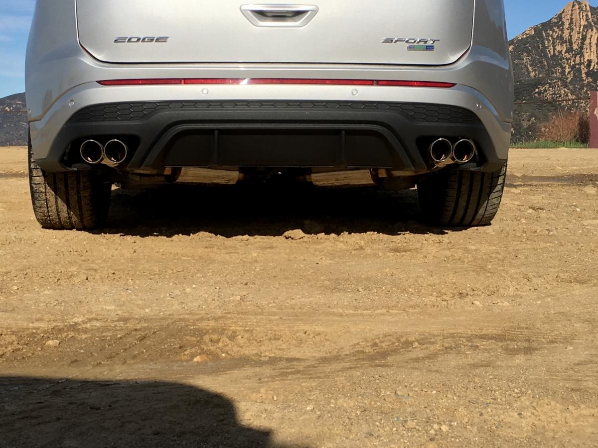

those look fine in there! sure 3.5" would fill it more but those certainly don't look too small. I'm sure nick would disagree though. I think he's putting 4- 5 gallon buckets for quad tips back there.
:hysterical: :hysterical: KIds around here put a single huge 5 or 6 inch fart can on their ricers, but a 5 gallon bucket... Lol :)
Just looks better with all the void filled in imo
Now I see what you are talking about filling up the space does look good in the photo. And when I look at my 3 inch in comparison they look small. For my taste a 3.5 would have been plenty. But while my car was in the shop another guy had 4 inch quad tips installed on his car, it was not a Edge. They were the ones with the blue tip fade on them and they looked awesome. They fit perfect and made his car look bad ass aggressive. When I saw those tips on his car it had me rethinking mine. I am happy with mine and now others have different combos to look at if they are considering quad tips. Mine at 3 inch , Mikula at 3.5 inch and yours will be the largest yet at ??? It will be cool to see what you come up with. I am sure it will look great when finished because no matter what size you pick, quad tips are a cool upgrade. :2thumbs:
