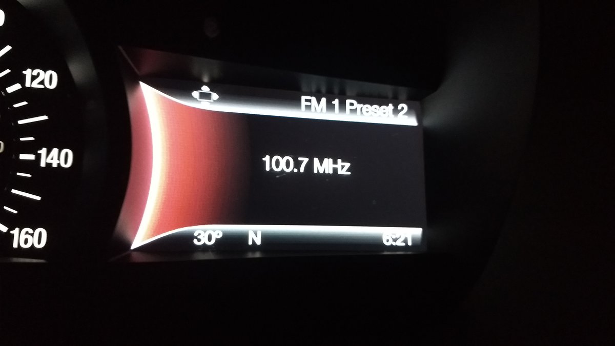

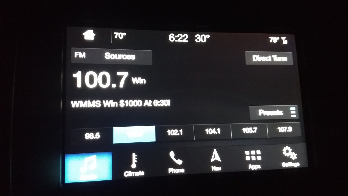

Can anyone with a 2015-2018 Edge confirm if they get the Radio Data information on the right screen of the instrument cluster?
Is this while the center display is showing the radio channel info?
2 hours ago, lildisco said:
All i get
Maybe then my IPC needs updated software!

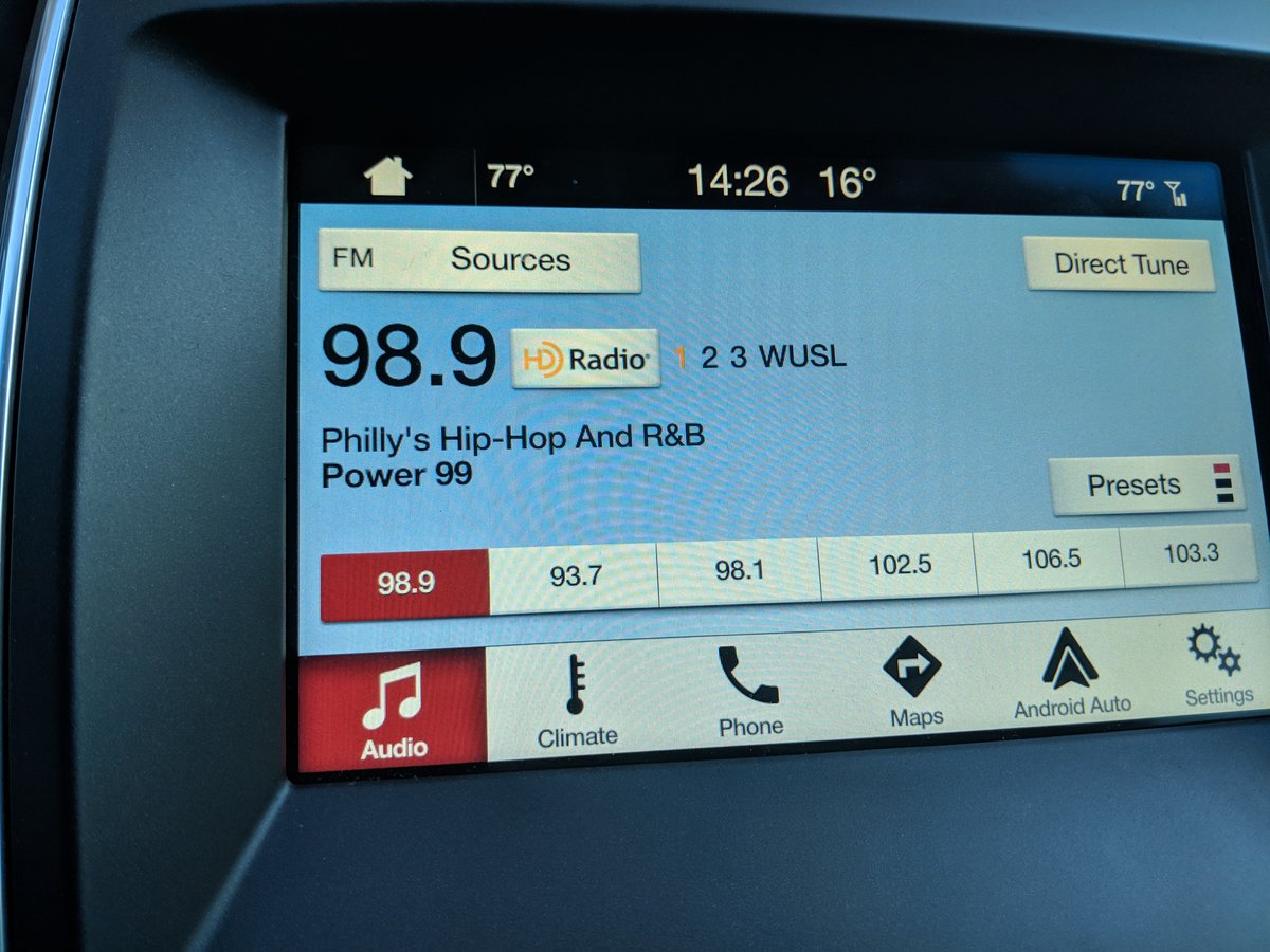

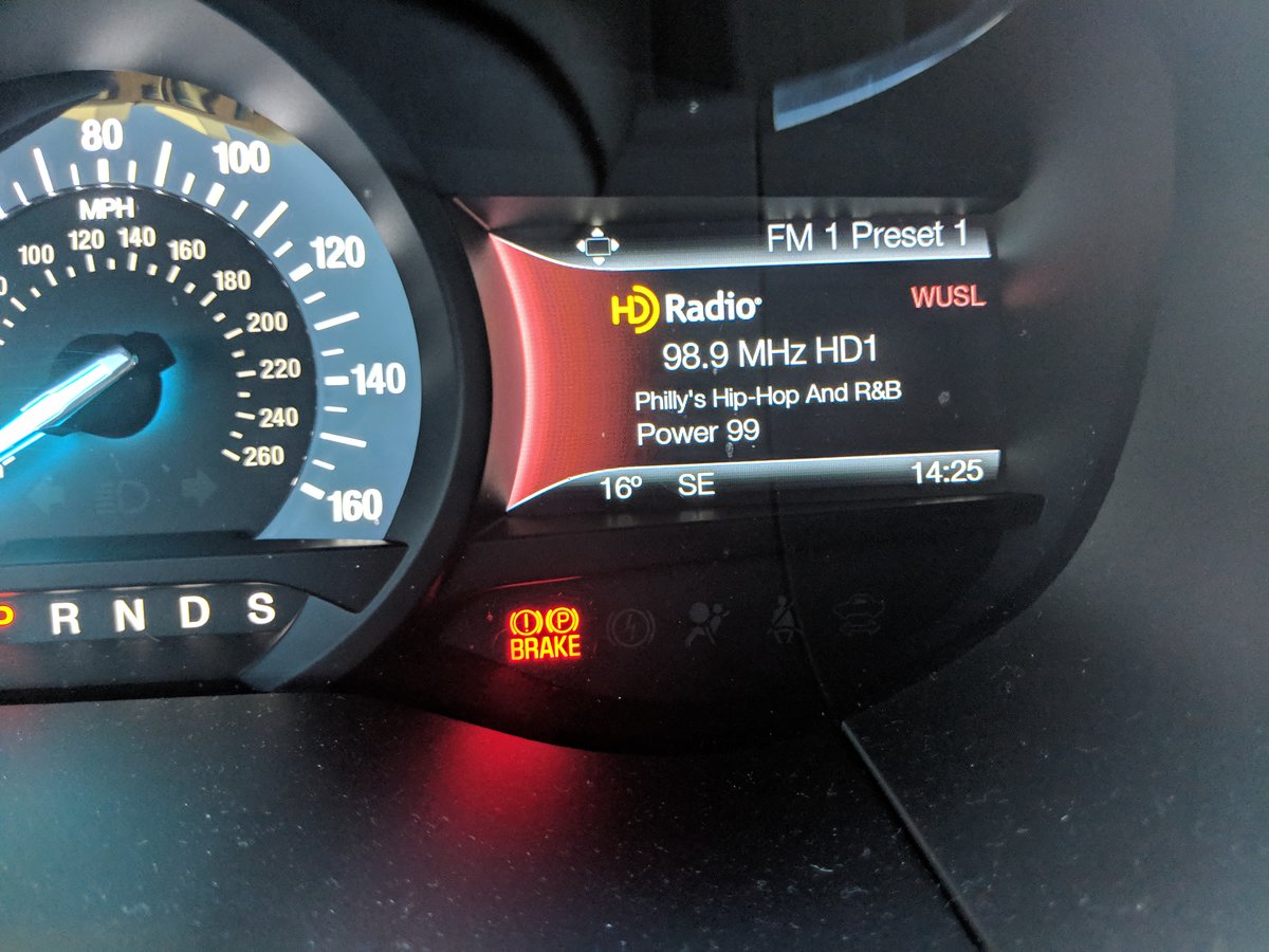

It could be a HD Radio thing. I've never heard 1 in my area. I know that they're around, just i live so far from a major city that i don't think i get good reception.
  • Thanks 1
Living far from a city is why you haven't seen any HD Radio stations - they're all or nothing.  HD Radio is a digital broadcast so there's no fading or hiss like traditional FM when you are at the edge of the reception area... it will simply cut out altogether when the signal becomes too weak to process.
HD Radio does allow additional metadata to be broadcast compared to RDS.  It is not uncommon to have album art along with artist, title and track information displayed when listening to an HD Radio broadcast.
BTW, the HD in HD Radio doesn't mean High Definition as one would expect.  It's simply a brand name and there is no improvement in sound quality other than the fact being digital reduces background noise.  The bandwidth available for the digital signal could have been used to broadcast higher quality sound but North American broadcasters chose to use the extra bandwidth to provide additional channels instead.  So you're really not really missing much.
HD Radio is not commonly used outside North America.  The similar DAB and DAB+ systems are used in most of Europe and a few other countries around the world.
  • Like 3
