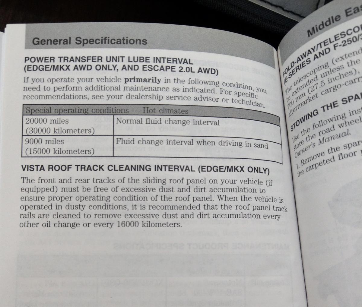

With my Edge Sport (Middle East - Hot Market version) there is a PTU oil change interval recommendation by Ford, 9K or 20K miles based on operating conditions (attached).
Also, there is a PTU temperature sensor and I can get the reading through ForScan. But I do not know what would happen if the temperature goes high, a light in the gauges or warning message? I don't know.
