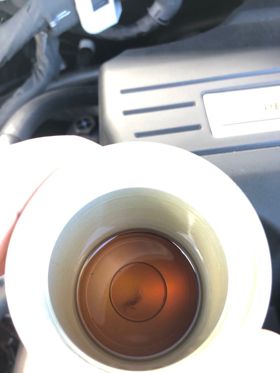

Rimcrim Report post Posted March 4, 2019 Installed a JLT Catch Can on my new 2019 Edge at roughly 50km, and I just checked it at 1600km to see what was inside. Quite a decent amount of oil, and a few particulates in there sunk to the bottom as well. Very glad I put this on when it was new to prevent all of this from going back into the engine. 3 Share this post Link to post Share on other sites

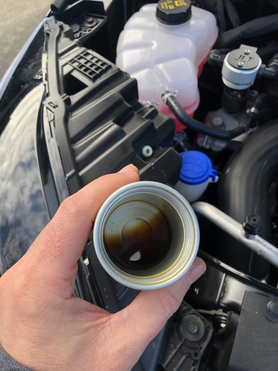

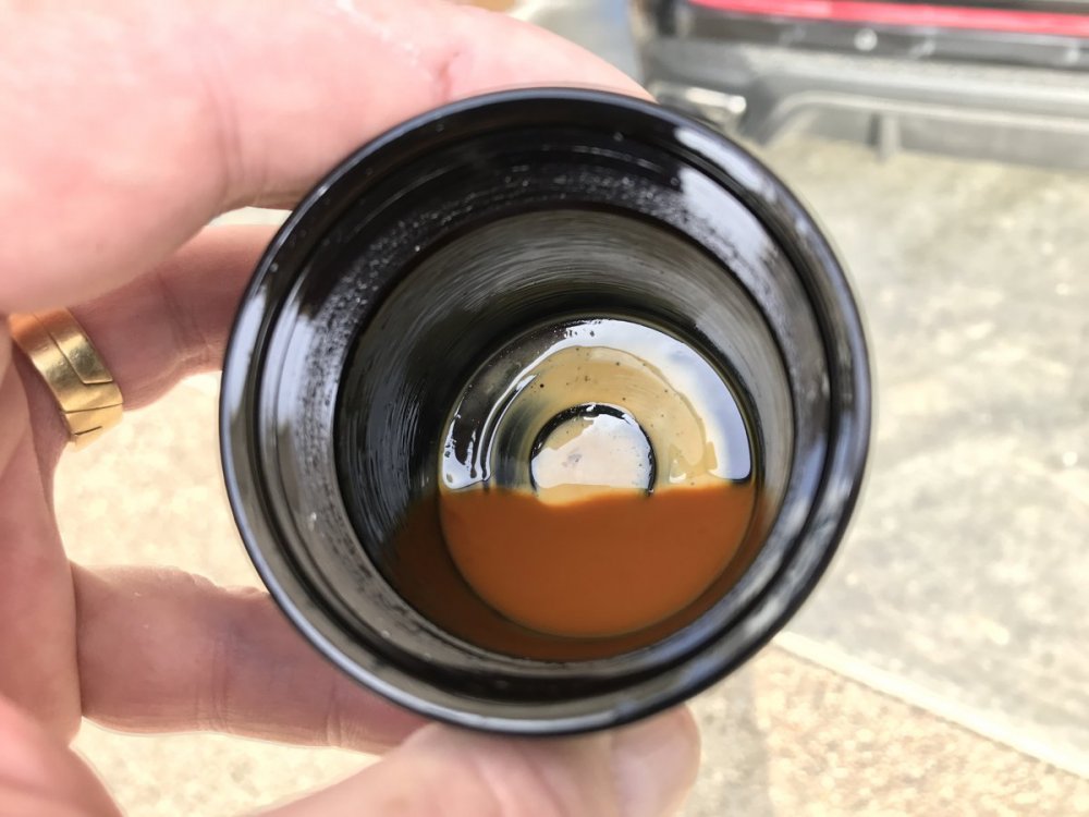

handfiler Report post Posted March 16, 2019 On 1/6/2019 at 7:04 PM, 1004ron said: This is what I find in my JLT 3.0 can after around 500 miles. I can't resist checking it when I check my engine oil level. Mine would be 3/4 full in 5-7 days when the temperature got down to -20 C. Mostly due to the hot vapors condensing in an ice cold catch can. In my application the can was further from the motor. On the edge it's in a good location as it will be kept warmer from the engine heat. 4 Share this post Link to post Share on other sites

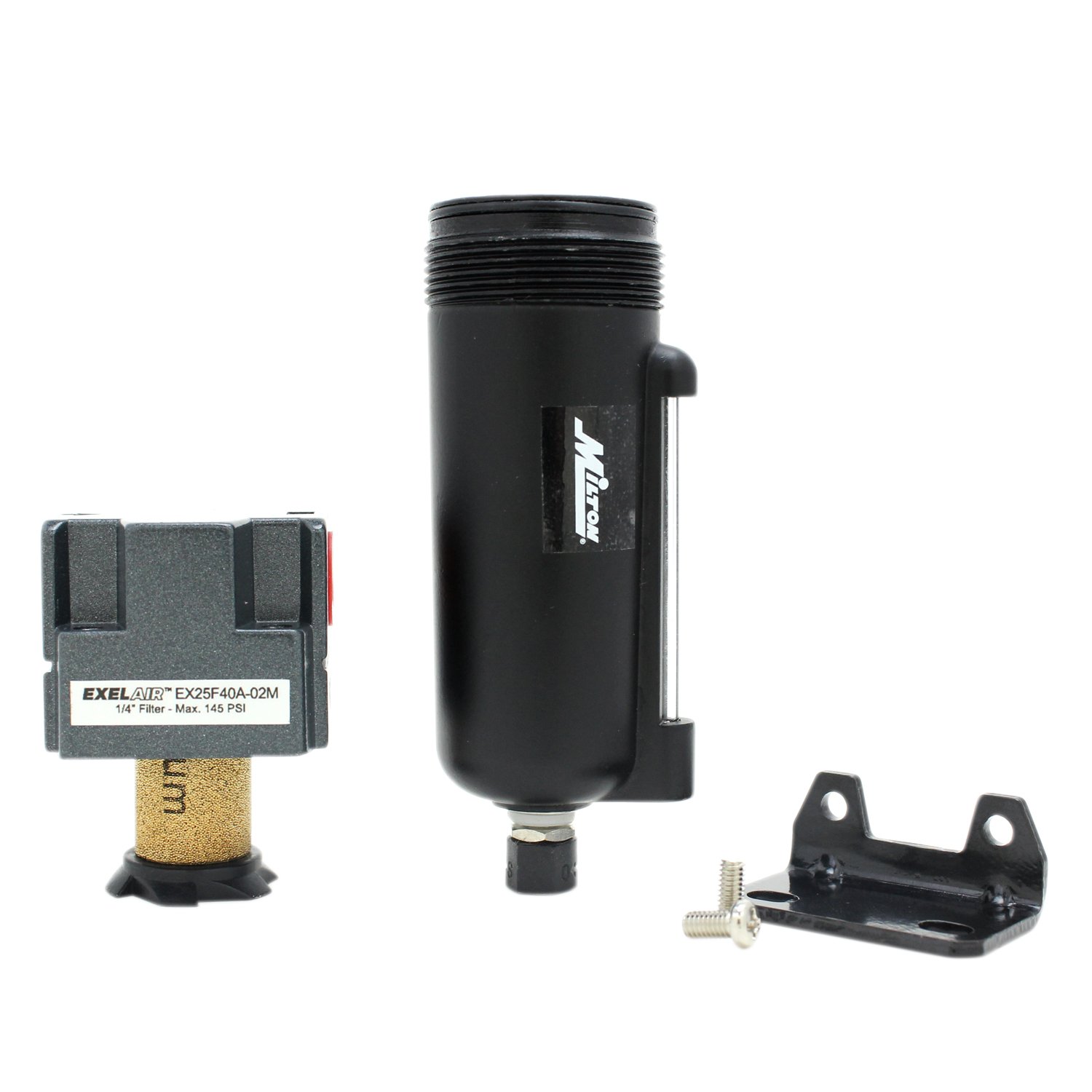

1004ron Report post Posted July 6, 2019 Anyone have experience with the Steeda Catch Can? The one in this image just doesn't look right to me. Share this post Link to post Share on other sites
Project_Edge Report post Posted July 6, 2019 (edited) Thats my oil separator. I got it for my Focus and decided to use it for my Edge. I bought another oem hose and cut the hose off to use the connectors. It's working well so far. I use the drain button at the bottom to drain onto a rag as I see it build up. Steeda sells replacement filters as well. I have a message in with them about how long a filter lasts. Awaiting a response. Edited July 6, 2019 by Project_Edge 1 Share this post Link to post Share on other sites
1004ron Report post Posted July 6, 2019 (edited) 36 minutes ago, Project_Edge said: Thats my oil separator. I got it for my Focus and decided to use it for my Edge. I bought another oem hose and cut the hose off to use the connectors. It's working well so far. I use the drain button at the bottom to drain onto a rag as I see it build up. Steeda sells replacement filters as well. I have a message in with them about how long a filter lasts. Awaiting a response. I have a few concerns with that style, the sintered filter once wet with oil, which won't take long, will present a air/gas flow restriction and from then on its going to be less effective and increases the potential for crankcase pressure to increase. If I was to use the compressed air filters, I'd drill a few holes in the sintered filter and wrap it with the course pot scourer. The other odd thing is the size. Catch cans like the JLT rely on a gas/air flow direction change with gravity, a course filter like pot scourers, and a housing that will promote condensation - low gas/air pressure drop. Also, those compressed air filters are really cheap - don't know what Steeda charge, and if they make any modifications to the standard air filters, but is doesn't look like it. https://www.homedepot.com/p/Husky-1-4-in-Air-Compressor-Filter-HDA70403AV/100027474 This one with a higher cfm rating and metal bowl at $26 would be a better option compared to the Steeda. https://www.amazon.com/EXELAIR-Milton-FRL-Mini-Filter/dp/B01MEGKUIK Edited July 6, 2019 by 1004ron 1 Share this post Link to post Share on other sites
