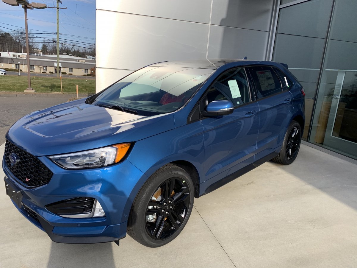

Not sure if the adaptive LED headlamps was resolved yet, but a car I was looking at today shows that it has adaptive headlamps: https://www.mitchellseligford.com/new/Ford/2019-Ford-Edge-Windsor,+CT-134e4be60a0e0ae73012ecebd6ec3d38.htm?searchDepth=1:1
That is the exact car I test drove. I ordered my car through that dealer and it should be in any day now.
