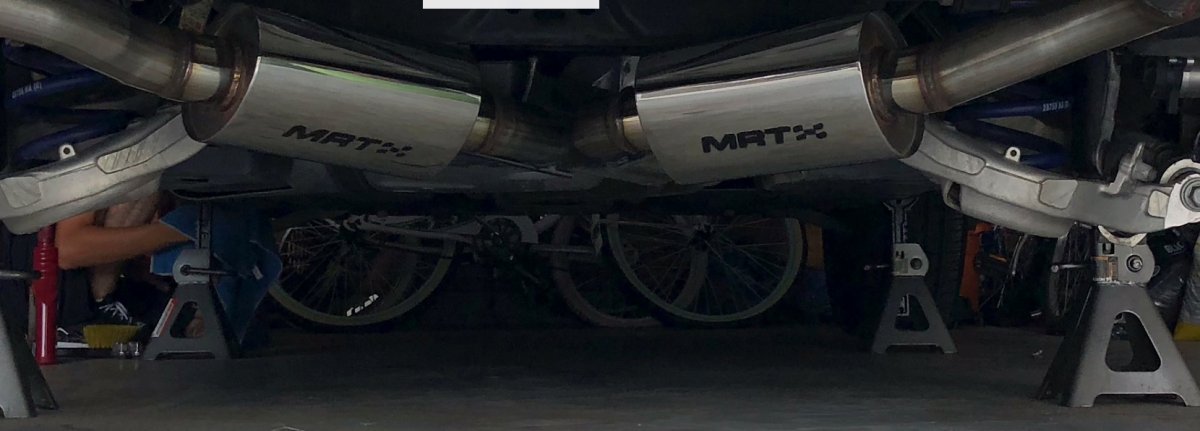

I bet this would sound awesome with the MRT Axle Back mufflers.

So this is what I got back from Zury when I asked him about making the cat back section:
Good morning, so we do everything custom to the car. We wouldn’t be able to produce and ship. If you are located close we can definitely do the this section but would need the vehicle. It wouldn’t require getting the downpipes/hiflo cats as well. I’m not too familiar with MRT exhausts, but whatever we make would be able to mate to current setup. If you have any further questions give us a call or text at 4435173810
Those were resonators provided by the customer.
Which sucks because I would love to have this section.
