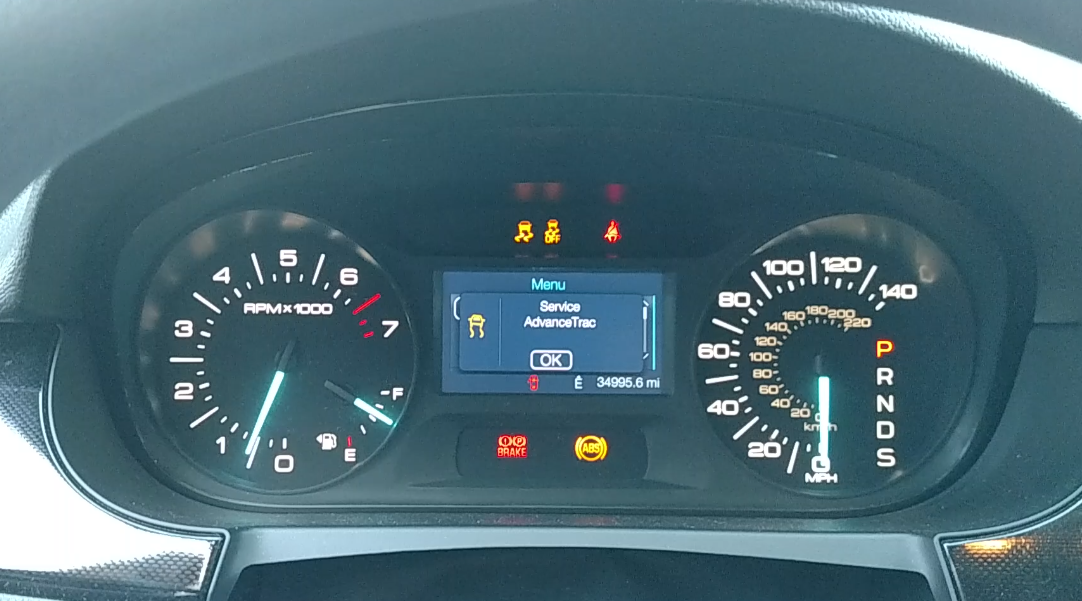

Yes, definitely an understatement! I don't have a YouTube account, and the videos are 90MB each, too big to post here. Basically, after disconnecting/reconnecting the battery, I could start it and move the shifter, but all the dash lights were on and stayed on, and it cycled through "Engine On", "Service AdvanceTrac", "Shift to Park", over and over again. All of those warning lights would not shut off as they normally do once the engine is running.

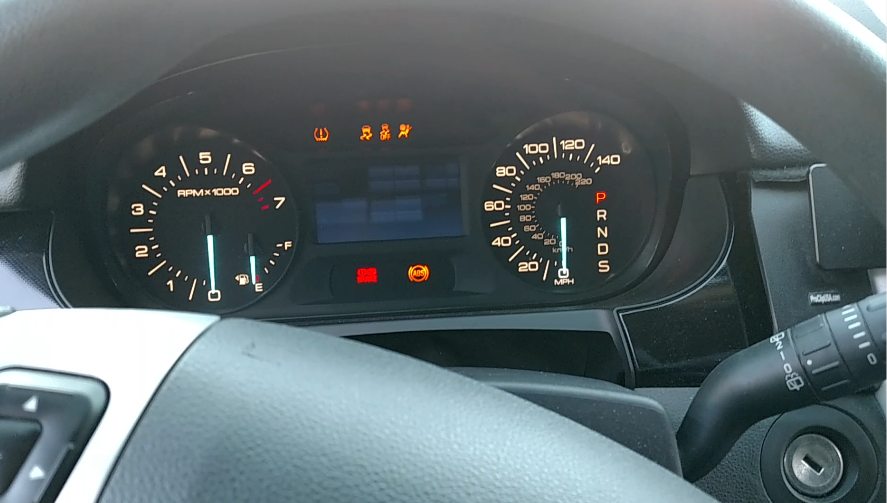

The second image, where one can see that the key is out, shows the lights as they would cycle every 3-4 seconds on and off, with the key in my hand.

AdvanceTrac and other warnings, with all dash lights on after disconnecting-reconnecting battery.PNG
Dash lights on and cycling over and over again, key NOT in ignition, before I disconnected-reconnected the battery.PNG
