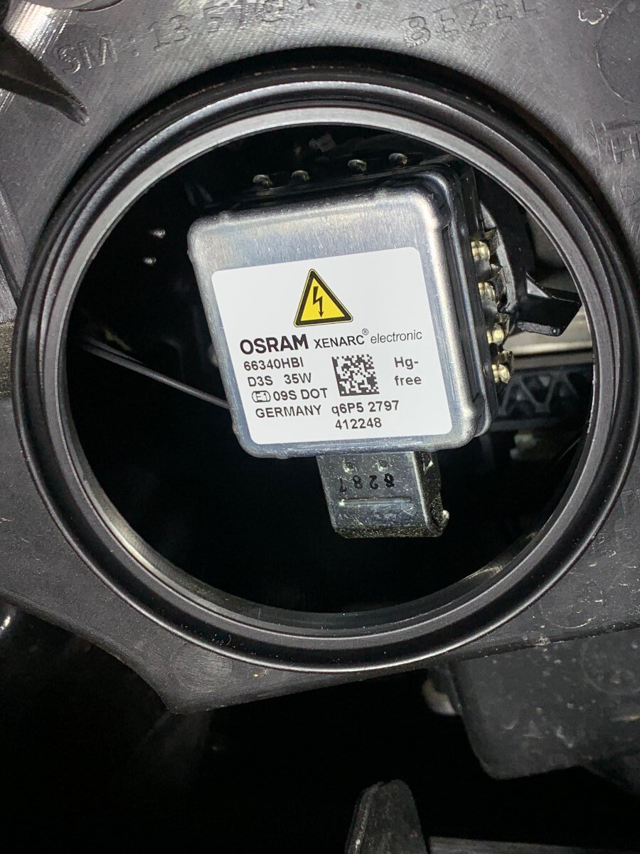

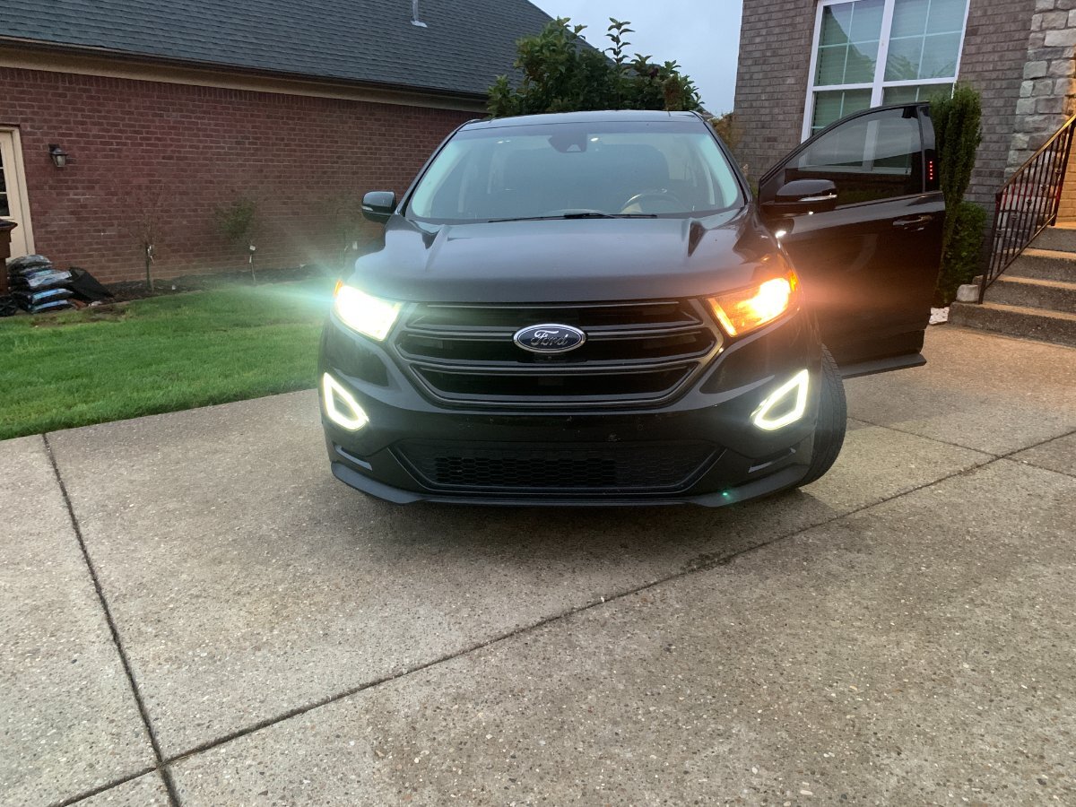

Ryanbai Report post Posted March 30, 2019 Hi there, Mine 18 edge sport has the d3s hid and the drl is h15. Hope that helps 1 Share this post Link to post Share on other sites
