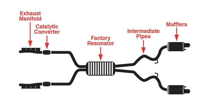

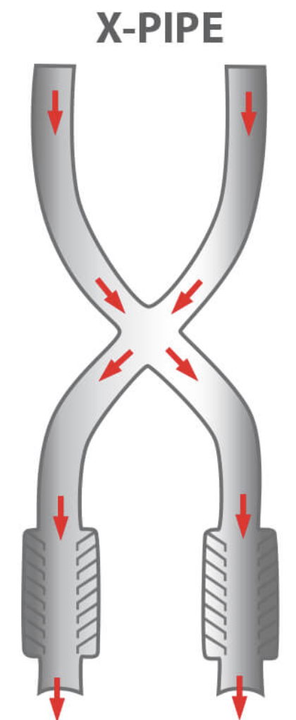

Basic exhaust system shown. Edge has one 'suitcase' muffler, not two as shown. The Resonator helps to control the sound by slowing/expanding the exhaust. Without it, you might get a drone sound which is not pleasant. Some don't care about the drone.  The x-pipe 'crosses' the two exhaust flows and replaces the resonator. Should reduce back pressure, increase performance.
If you look at MRTs page, it lists the axle-back exhaust with a '2' drone.
