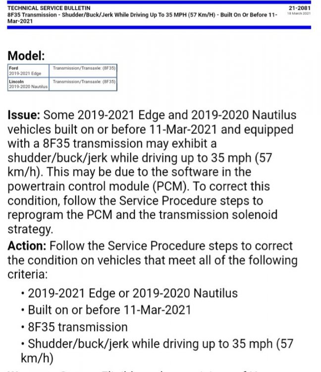

Breez Posted March 20, 2021 Report Share Posted March 20, 2021 Ford has come out with a new TSB. Quote Link to comment Share on other sites More sharing options...
IcyFridge Posted March 20, 2021 Report Share Posted March 20, 2021 6 minutes ago, Breez said: Ford has come out with a new TSB. Details? Quote Link to comment Share on other sites More sharing options...
Breez Posted March 21, 2021 Report Share Posted March 21, 2021 TSB-21-2081 1 Quote Link to comment Share on other sites More sharing options...
Toby99 Posted March 22, 2021 Author Report Share Posted March 22, 2021 Breez, Do you have a link to where you found this TSB? My dealership says there is no record of this TSB in Ford's system and it is not currently assigned to my VIN. Quote Link to comment Share on other sites More sharing options...
Breez Posted March 22, 2021 Report Share Posted March 22, 2021 (edited) Sorry, can not share link. I just checked and it is there. These aren't assigned, the vin has to be ran with symptoms of concern. Edited March 22, 2021 by Breez Quote Link to comment Share on other sites More sharing options...
Toby99 Posted March 23, 2021 Author Report Share Posted March 23, 2021 (edited) I understand. I've talked to the dealership. After convincing someone to call Ford, it has been confirmed the TSB is for my vehicle. Not really sure what the problem was but initially the system showed nothing for this TSB. Will get an appointment scheduled. Thank you for posting the information. Edited March 23, 2021 by Toby99 1 Quote Link to comment Share on other sites More sharing options...

barrowrk Posted June 27, 2021 Report Share Posted June 27, 2021 2019 Edge. TSB 21-2081 installed yesterday. MUCH improved performance. It had really gotten worse lately. Was especially bad after first starting the car after sitting in the hot Florida sun for a few hours. Will update this thread after a month or two, but I'm optimistic right now. 1 Quote Link to comment Share on other sites More sharing options...
