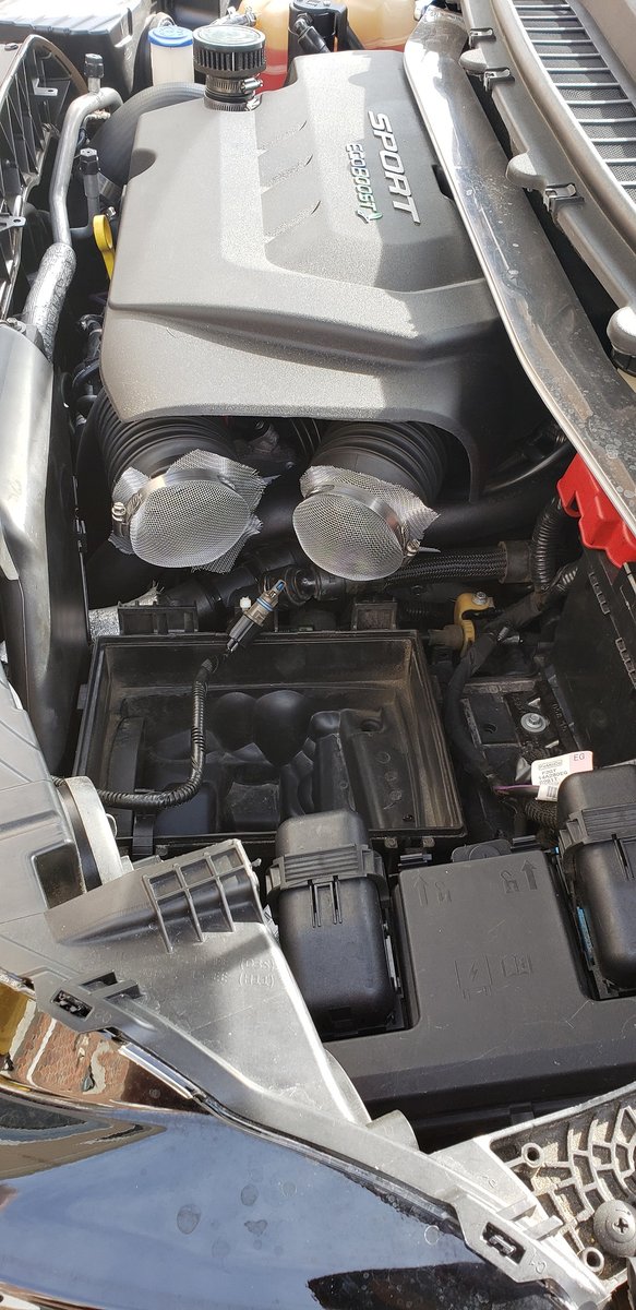

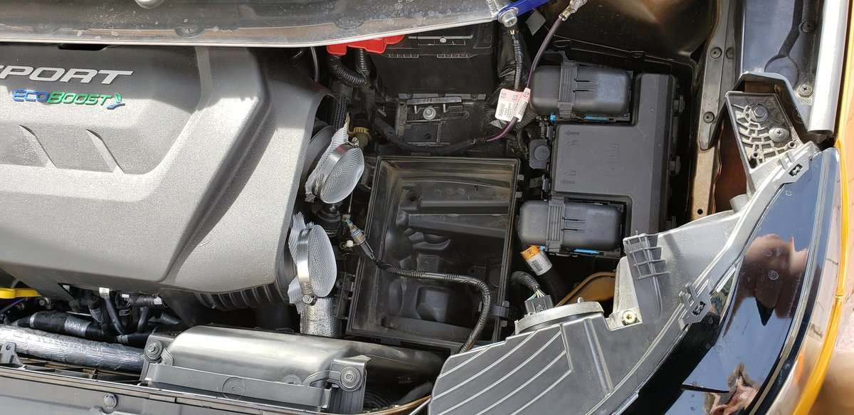

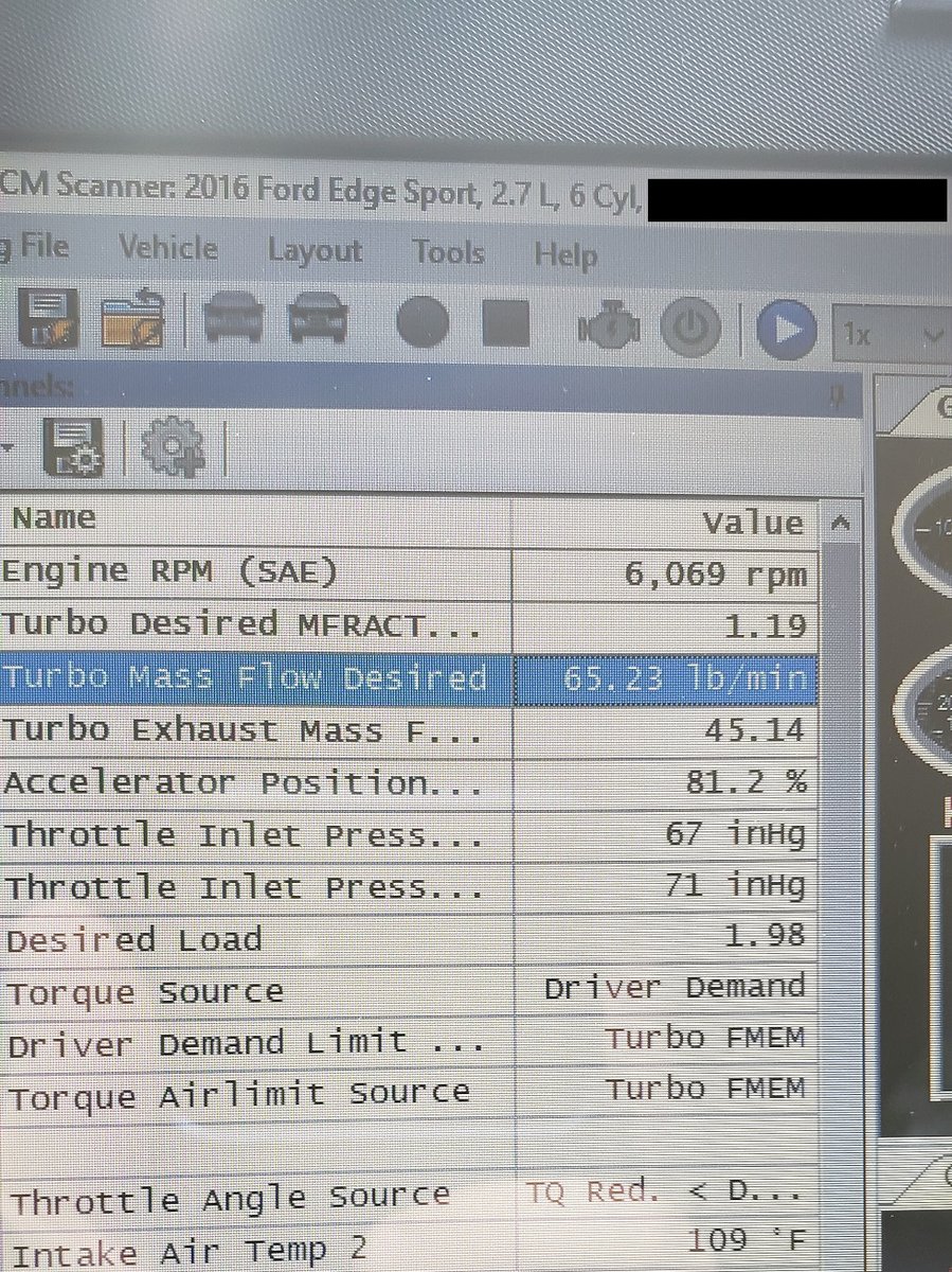

Special_K Report post Posted June 11, 2019 (edited) Good day! Lets just rip the band-aid off, I am here to once again hash and discuss the pros, cons and ideas of possibly fabricating an intake for the platform, but with a twist....... I HAVE NUMBERS!!! So having an edge that is demanding alot of air (catless, custom turbos, etc) I figured why not test on our specific vehicle as it will exaggerate any results! So here we go: Decided to test a theory, less restriction = more power, but heat will defeat the power gained by less restriction. So to test this I took the top of the air-box off and left the bottom half in to still provide some "Cool" air to the intake area. I put some aluminum screen over the intake as a two dollar proof of concept, to protect the motor from sucking in foreign objects, and connected the intake sensor and mounted it near the intake for an accurate measurement. Now for testing sake we did both logs, on the same stretch of road, in drive, with TC off, from 0-100 and on the same day. Was able to get a log with stock airbox and about 15 min later with the screen. NOTE: During these test a K&N Dropin was used in the stock airbox, and the screen was used for 10miles to just test a theory. Now for observed results: Stock airbox with drop-in filter: Start boost air temp 102 End boost temp 148 Max turbo flow 66.4 lb/min at 23.2 PSI Screen "Filter": Start boost air temp 115 End boost temp 141 Max turbo flow 65.2 lb/min at 19.3 PSI Observations: With the screen filter we did notice a higher starting temp than using the stockbox however when WOT the temp quickly dropped BELOW the stock air box lowest recorded temp by 4 degrees and ended at a lower temp. The biggest note here is the drop in pressure with the same flow! The car did feel slower, this is due to the incoming air being well beyond tuned safety limits, and is noted in the log. We have sent both logs to BCB for review and input and they will be getting back to us soon! I have included images for observation and discussion. As soon as i can figure out a way to post view-able logs i will doing so. AND DISCUSS! - Special thanks to @snmjim for letting me test this theory! Edited June 11, 2019 by Special_K 2 Share this post Link to post Share on other sites

WWWPerfA_ZN0W Report post Posted June 11, 2019 Longterm, not a good idea to leave the screen in place as a lot of c*** will make its way into the engine. Better served by extending the snorkel to the signature light/foglamp area, that WILL enhance performance, not by a lot, but possibly shave a tenth off the 1/4 time. I assume the airbox is sealed from the engine bay, whether to the hood or in OEM fashion. Might want to play with insulating the inside. If you want to improve airflow, you can dimple the inside of the custom intake (like a golf ball) as well as the throttle body/plate. True duals to the turbos are definitely a plus, feeding more air plus some "improvement" in sound. Hard pipes would look nicer, but not necessary since not on the boost side. A dropin K&N/K&N-style filter will likely be all the improvement you need as far as the filter is concerned. Of course it does not add bling to the engine bay 3 Share this post Link to post Share on other sites
Special_K Report post Posted June 11, 2019 5 minutes ago, WWWPerfA_ZN0W said: Longterm, not a good idea to leave the screen in place as a lot of c*** will make its way into the engine. Better served by extending the snorkel to the signature light/foglamp area, that WILL enhance performance, not by a lot, but possibly shave a tenth off the 1/4 time. I assume the airbox is sealed from the engine bay, whether to the hood or in OEM fashion. Might want to play with insulating the inside. If you want to improve airflow, you can dimple the inside of the custom intake (like a golf ball) as well as the throttle body/plate. True duals to the turbos are definitely a plus, feeding more air plus some "improvement" in sound. Hard pipes would look nicer, but not necessary since not on the boost side. A dropin K&N/K&N-style filter will likely be all the improvement you need as far as the filter is concerned. Of course it does not add bling to the engine bay I did forget to mention that we did the screen for all of 10 miles to test a theory ? What i cant get over is the turbos maintaing close to the same output but with 4 psi less.....means they are trying less and less load on the motor. We tried "porting" the stock airbox with a 2.5" pvc plumbers nightmare down to fender well....... results were so little we never even posted that fail. Im not to worried about the Turbo inlet Pipes (TIP) as much as the airbox as it is only sucking from a 9sq/in hole......thats alot of air to shove through that tiny hole! Ill update the OP with the fact that we are using a drop-in K&N. Thanks for the input!!! 2 Share this post Link to post Share on other sites

Special_K Report post Posted June 13, 2019 Just heard back from Casey at BCB from the logs comparing the stock airbox vs the screens. I quote: "very interesting with the intake removed. there is quite a big pressure drop across the stock airbox it looks like. turbos not working nearly as hard to compensate" So that is good news, means we are on the right track! 3 Share this post Link to post Share on other sites

Special_K Report post Posted June 14, 2019 18 hours ago, Special_K said: Just heard back from Casey at BCB from the logs comparing the stock airbox vs the screens. I quote: "very interesting with the intake removed. there is quite a big pressure drop across the stock airbox it looks like. turbos not working nearly as hard to compensate" So that is good news, means we are on the right track! To expand further he called back yesterday to tell me that at 5000 rpm with stock air box the wastegate was at full duty cycle, with the "intake" we still have about 22% left in the wastegate at the same point. 4 Share this post Link to post Share on other sites

WWWPerfA_ZN0W Report post Posted June 15, 2019 On 6/14/2019 at 6:17 AM, Special_K said: To expand further he called back yesterday to tell me that at 5000 rpm with stock air box the wastegate was at full duty cycle, with the "intake" we still have about 22% left in the wastegate at the same point. Does he have graphs to compare where the difference starts manifesting? Is it all through the range, or after 2500 rpm, or ...? Kinda like dyno sheets 22% is a LOT. Share this post Link to post Share on other sites
