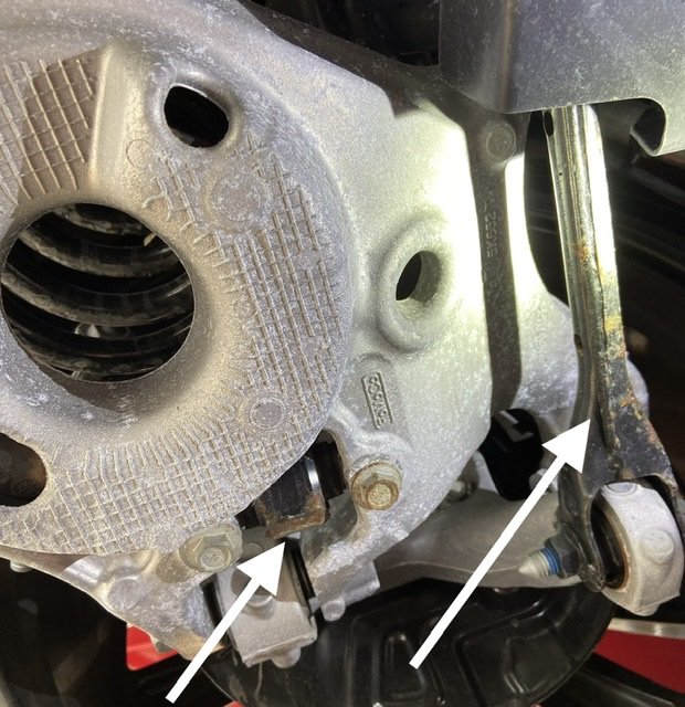

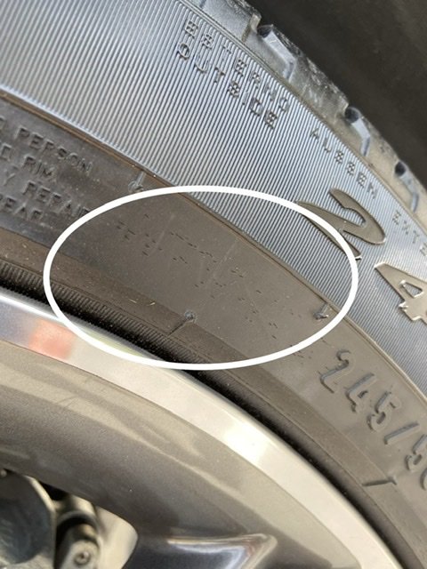

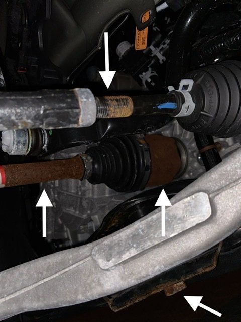

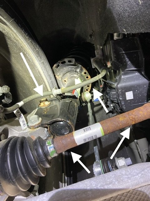

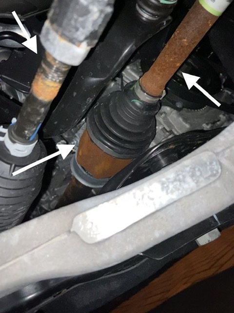

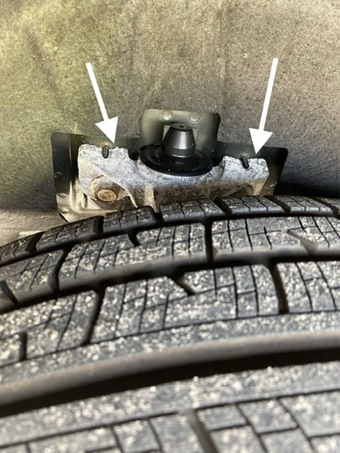

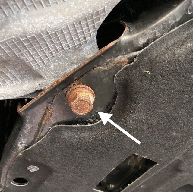

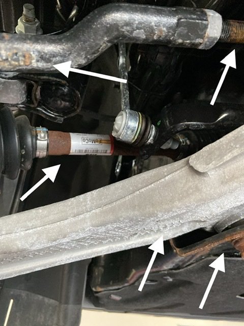

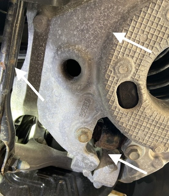

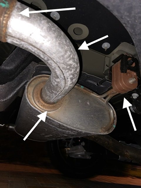

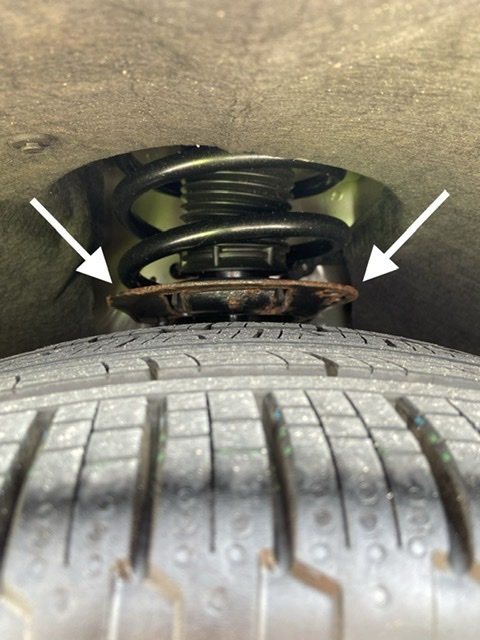

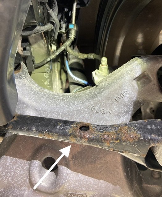

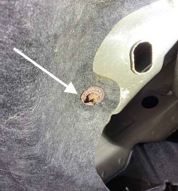

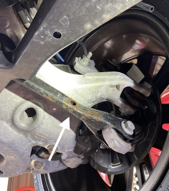

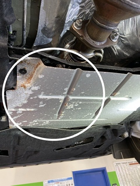

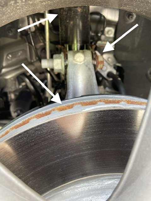

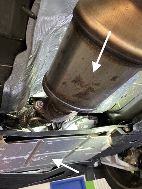

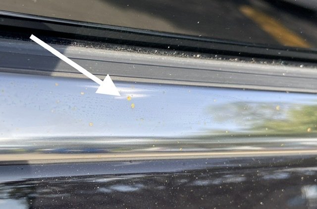

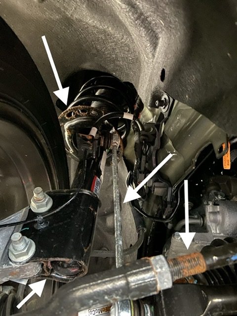

Since bringing it home, I’ve noticed some issues with minor cracks in the outer parts of all four tires, visible rust in the wheel areas, rust and corrosion underneath the vehicle after my mechanic inspected it, and rust on many parts of the outer trim all around the vehicle.
I’m bringing it in for service this week and I’ve spoken to Ford corporate, the sales manager, and service manager to document everything.
I’m not sure if I’m overreacting, but this doesn’t seem to be normal for a brand new car. Attached are all the pictures of what I’m describing, and it seems to be more than just surface rust.
To be honest, I don’t want Ford to replace all the tires, trim and various parts...I want a new vehicle. My Ford dealership explained there could be slight surface rust, which I totally understand, but some of these pictures look way worse than surface rust and corrosion. Ford corporate explained there could be a way to get it swapped for the same type of vehicle at my dealership, but that only happens after inspection.

First - it’s not really a brand new vehicle.  It’s been sitting on the lot for almost a year.  That’s why it was $3k cheaper.
Unless there was some type of flooding at the dealership (which I doubt) that is normal for a 1 year old vehicle sitting outside.  Because it’s not being driven there was no engine heat to dry things off so it rusted a little faster but still looks like normal surface rust to me.

Some parts look way more rusted than normal surface rust. Also, it seems to have gotten up high into some parts, but not inside the vehicle. How could that happen with rain?
What do you think the best course of action is? Regardless of what caused it, I don’t believe it’s acceptable to have to keep all this rust and corrosion that looks worse than vehicles that have been in use for years. I also don’t believe all my tires should have these cracks in the sidewall, that dies not seem safe.

There's a few items such as the drive shafts, CV joints and brake rotors that are not painted and will always get some surface rust fairly quick, but the other painted suspension parts are quite typical for areas that salt the roads - quite possible that it was driven by the dealer or driven to the dealer on salted roads and never rinsed off.
In the photo of the brake rotor it looks like a bolt that's not fully tightened - got another photo of that?
It would be very difficult to stand your ground with the dealer on the superficial rust, but would admit, not something I'd like, and many dealerships have similar discounts on vehicles that don't show those signs, and don't believe that's behind the discount you got.
It most likely sat on a dealers back lot, which many are not paved. Sitting for a long period of time on a dirt lot does not allow things to dry out as quickly as if it was on cement. Dirt retains moisture for quite awhile.
Just have your vehicle sprayed with some oil-based anti-rust product and it should slow down if not stop the surface rust problem. Most of the parts you pictured aren't made of stainless steel or are unpainted so they all tend to get surface rust even when brand new, sitting on the dealer's lot. Also just driving in the rain is enough to make surface rust appear but no need for concern, as they all do that sooner or later. ;)
