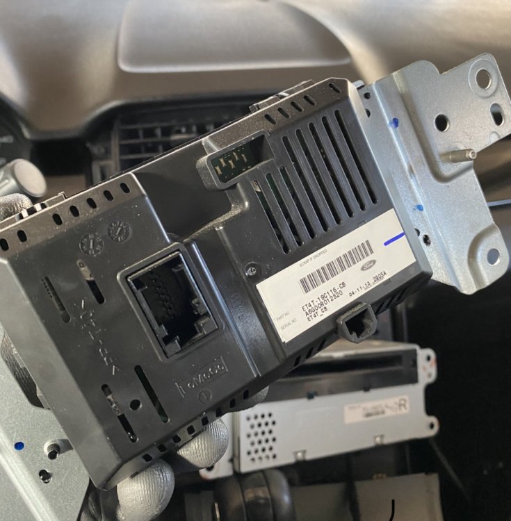

Hello, thank you for your help and kindness. I see you upgraded from a 4.2 inch screen. I intend to do the same on my 2014 Edge SE. I’ve purchased everything I need for the sync 3 upgrade including the wiring harness. My problem is I don’t know the location of the sync module in the 2014 Edge SE. I’ve searched online and looked under the dropped glove box to no avail. The factory harness/plug-in that goes into the back of my 4.2 inch screen  does not fit the purchased harness receptacle(too small, see attached photo 1). I watched a video from 4D tech similar upgrade for 2015-18 and the purchased harness plugs in at the sync module, located under the glovebox, but this module isn’t present under my 2014 SE glovebox, or I have not been able to locate it there yet. I removed the glovebox but found nothing similar/no module, at least to the bet of my observation.  Also took out the radio(ACM) and there isn’t any separate sync module in the center dash.
I see that the 4inch screen appears attached to some plastic part similar to the APIM attachment in models factory equipped with the 8inch screen. Is that the APIM for the SE and the only “sync module” on the SE??

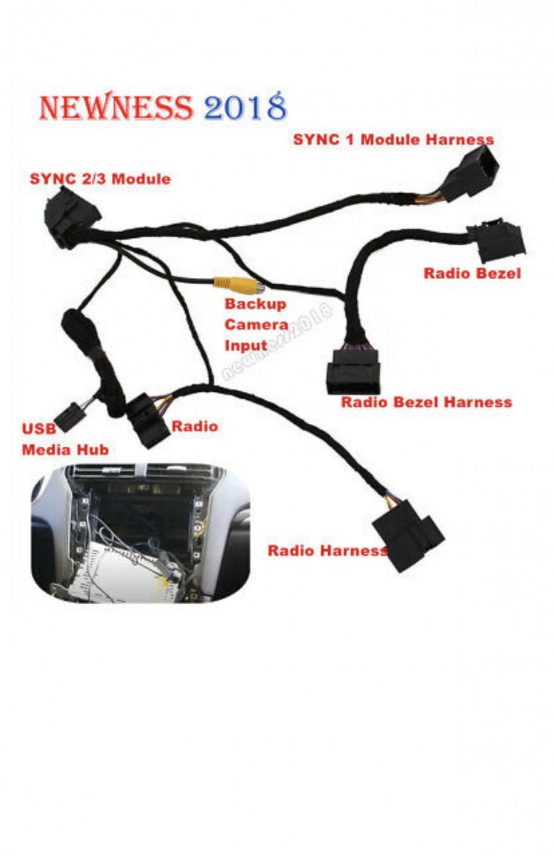

I just need to locate the module with the plug-in that goes into the conversion harness illustrated as sync 1 module on the 2nd  attached picture and I can handle the rest.

The first picture attached below is the back of my current 4inch screen. The 2014 Edge SE model does not have the  type of APIM that is attached to the back of the 8inch screen(on SEL and ltd/sport models). If it does have a similar APIM, it is not attached to the back of the 4inch screen.

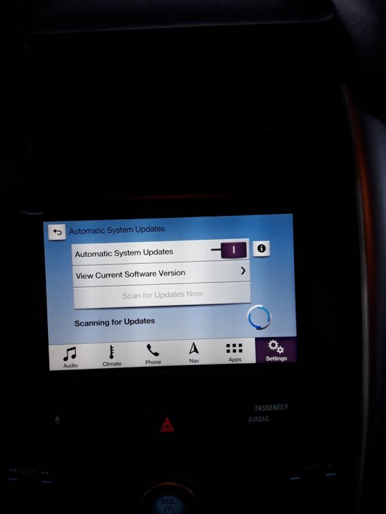

The 2nd pic is the Sync 3 APIM and screen I want to install.
The space in the back of the 4inch screen shown in photo is where the small harness plug-in, in my initial picture inserts into. What I need to find is where the large harness receptacle, shown besides the 4inch screen plug-in above, (ie in my very first photo) should plug into.
In this 4D tech video, that module is located under the glove box in the 2015+ models.
I did not find any such modules or plug-in under my glovebox when I removed it to look under the dash.
The item, where 4D tech plugs in the conversion harness under the glovebox is what I need to find in my 2014 SE model.

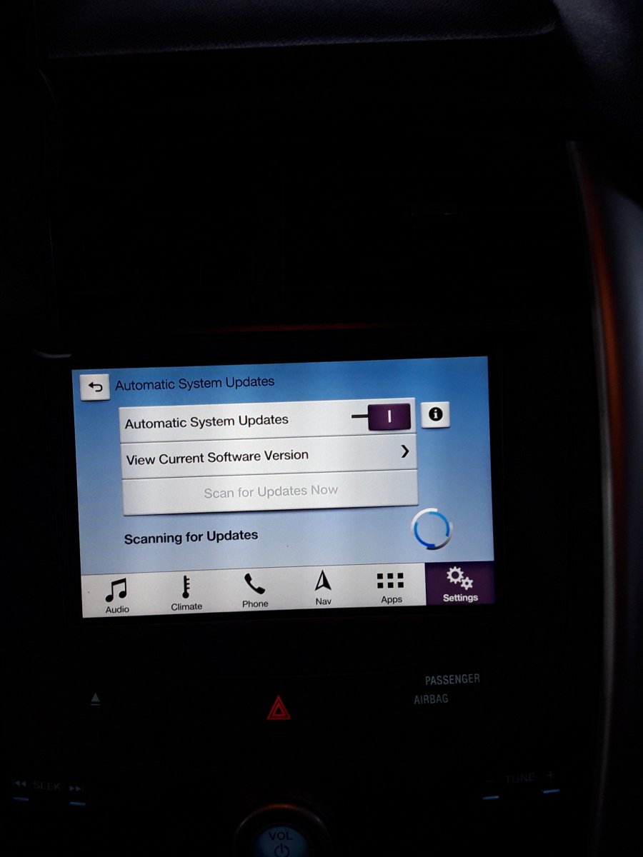

I just did my update to 3.4, it was nerve-wracking but ultimately easy as heck and painless
I'm not worried about radio icons and such, so i probably won't play with doing the new calibration on the APIM

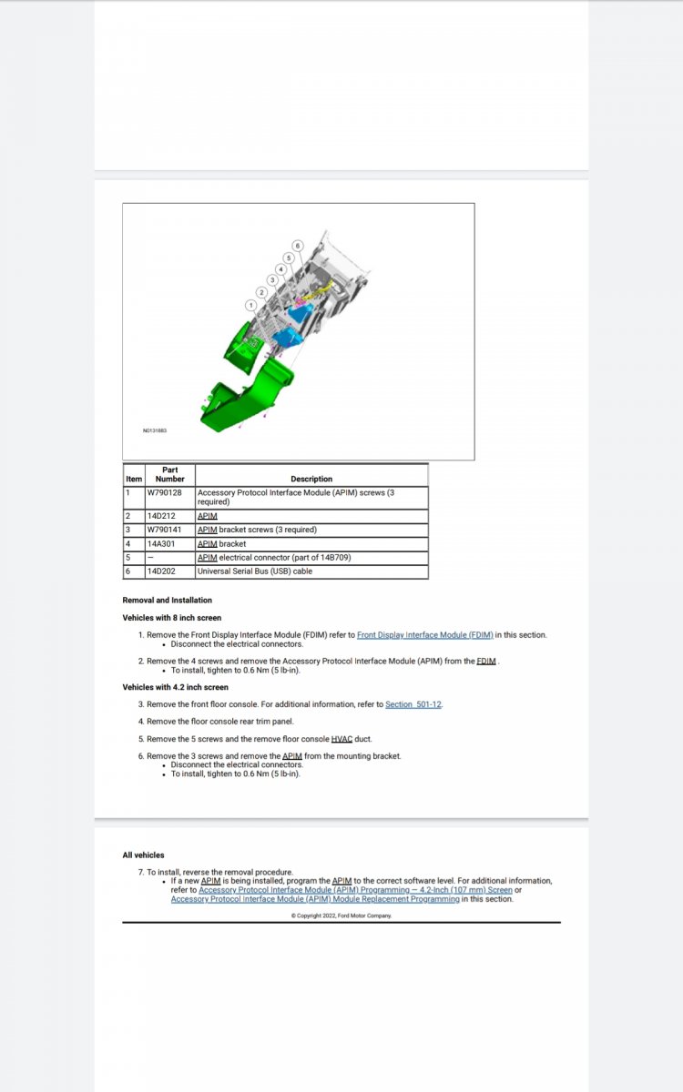

You can purchase short term access to the service manual via motorcraftservice.com and if you can't figure that out pay someone to look it up for you and send the info.

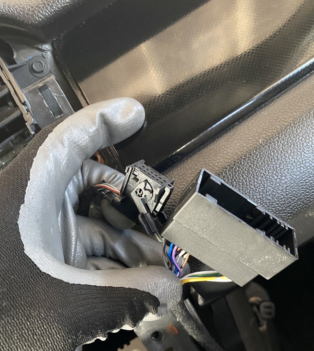

Update finally done. It was a lil hectic. The entire floor console was removed. The APIM is buried under the HVAC duct as shown above.  Both front seats were also removed for ease of access.
1. The OEM sync harness is too short to reach the back of the new APIM. Pull through the right side underneath the front display  trim panel and right side of the ACM, it will reach just above the ACM. Connect the harness extension to the OEM harness and plug it to the sync 3 APIM. Your new sync USB will be connected using the same route. Discard the old USB. You would need a new USB hub inside the armrest compartment.  You would also need a new harness extension kit. Just plug in only the APIM connection. Cut off the rest of it, ie the harness extensions to the bezel, ACM.  If you need video camera input, buy a harness with a camera input. Already in reverse, I see camera not available. I will provide further updates after I install my camera.
