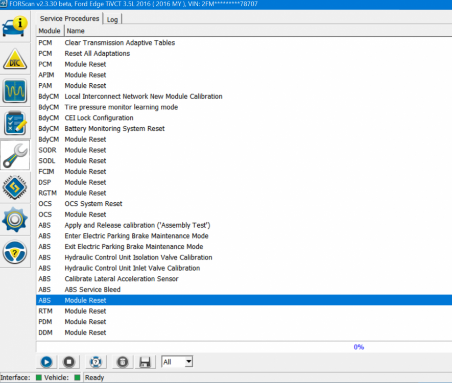

I 'might' have stumbled over a solution to this problem!
While messing around with FORScan recently I decided to do a reset of the ABS module.  I don't know if this will be a long term fix but now my brakes are predictable from a normal stop and that low speed grabbiness is gone.  I can now brake without getting the 'furry eyeball' from my frequent passenger and chief navigation specialist in the right seat.  I'll update this if the obnoxious braking returns but for now the fix seems to be in.

I tried running this with forscan this afternoon but I got an error that the module reset could not be completed- what am I doing wrong?
Are you using a code reader known to work well with FORScan?  Some of the cheap eBay readers can't see a lot of Ford's modules (computers) so can't make changes/adjustments.
Yeah I got it, I didn't tell it I had HS + MS on the initial connection so it wasn't looking for it and aborted the reset when I tried the first time.
It "seems" better, but I won't know for sure until it's cold and rainy- that's when it's the worst.

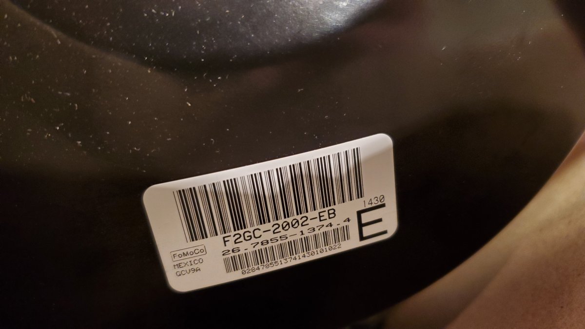

Ok so I went ahead and ordered the replacement booster. I went by the part number in the bulletin, and that is the part number on the box. When I opened it, the part number on the booster is the same as what is currently in the vehicle. Obviously they are compatible, but do I need the part with the actual part number referenced in the bulletin to get the improvement?
You can call Ford corporate directly to confirm, but I hope fellow owners who have had the booster updated will respond with pics as well.
The bulletin is addressed to vehicles Built On Or Before 3/23/2016. So your 2018 was supposed to have the updated Booster.
Mine is a 2015, I think the 2018 was the OP So I finally got around to replacing the booster today- I don't normally react this way but.... This is literally like a new car- it actually has pedal travel and stops like you would expect it to. What really gets me is that there's a bulletin on this, I took it to the dealer and told them I wanted them to change it, they said everything is normal and said not to change it even after I was clear that I was ok paying them to do it. So I ended up saving a few bucks on labor and I'm stoked that there was such a significant improvement. Now I'm ready to order a tuner from Livernois and keep this thing a while. If you've got short pedal travel and touchy brakes, don't hesitate on the booster update.
