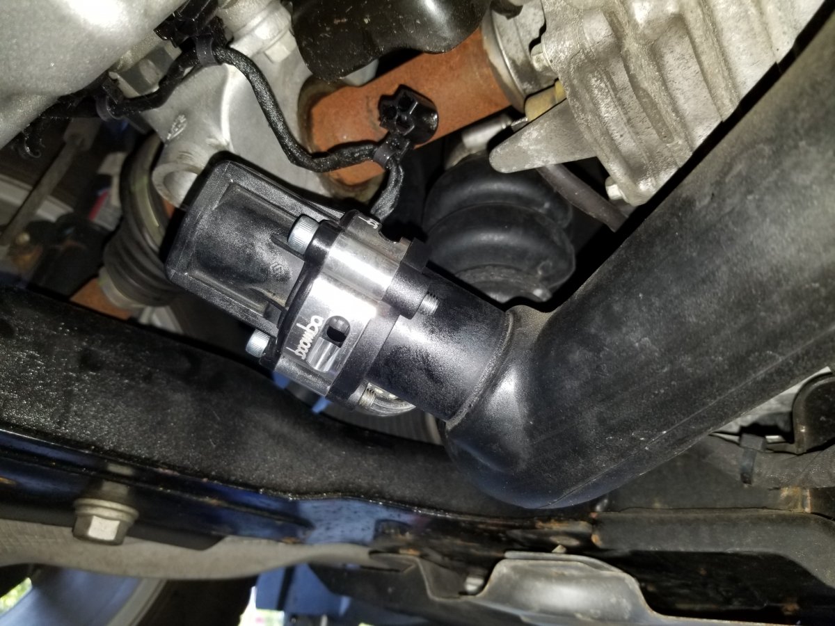

A couple of things different. That's a focus pre-2015, not sure of the engine. The crossover pipe that goes from the intercooler to the inlet at the rear of the engine has the diverter valve on the bottom under the oil pan. I'll post some pics, I ordered the boomba racing adapter.
these images are from a 2017 Edge 2.0

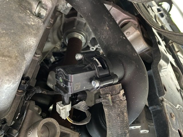

There's a video, but it's in my FB group. Def have to remove tire for easier access

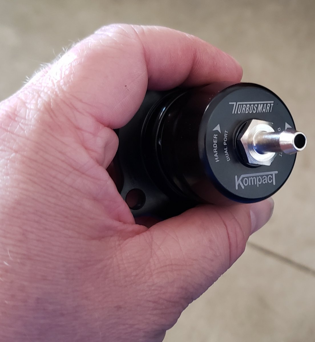

Ordered a Turbosmart from Summit Racing.  We'll see how this goes.  Wife's always a little jealous of my HKS in my CX7

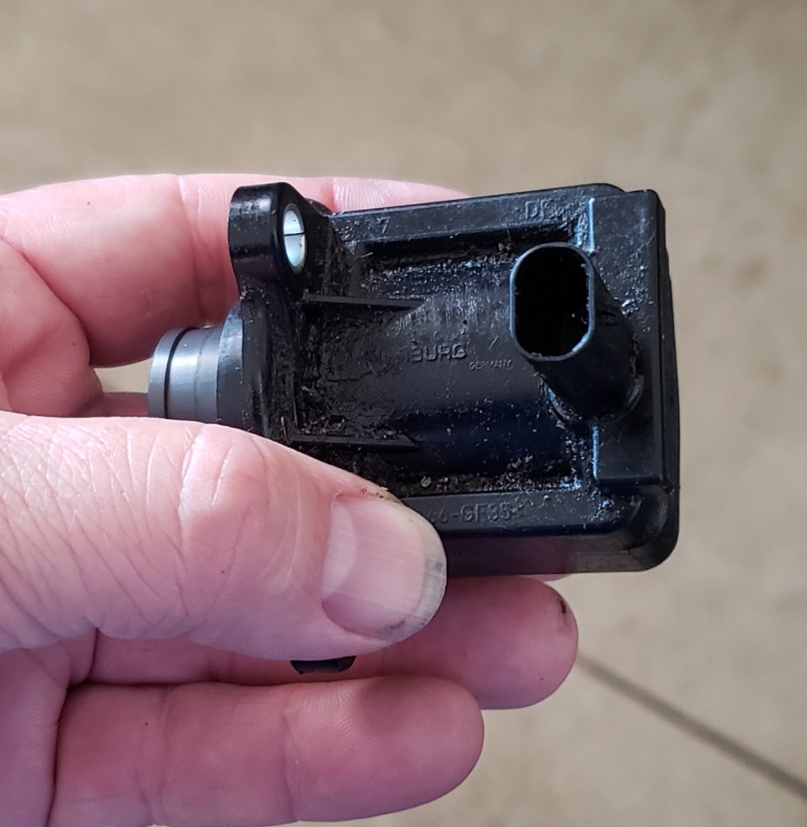

Welp, it bolts up, but there's an electrical connection on the bpv that's not on the new BPV. Assuming that it monitors boost, so no go for me on my 2016 fwd
Yours did not come with this piece? That plugs into the plug you unhooked?

negative.  It also doesn't have anywhere for that vacuum line to go either
Just got off the phone with Turbosmart & they claim that the above part will not fit in the charge pipe as the mounting points are different.  They suggest using the cheater plug mentioned above & running a vacuum line off the intake manifold.  I'm not sure that i want to do this at the moment because the edge has been pretty reliable & don't want to mess that up.  I do have a vacuum line that i use for the Catch Can, but not 100% sure how that's routed, so maybe i'll look into that before i return to Summit.
believe all of us with a real BOV have a vacuum line ran to the intake manifold. did your kit not ship with anything but the BOV? mine came with vacuum lines, a T and the plug I linked
My CX7 came with one, this was supposed to be a direct swap or at least that was my understanding. I could do that, which probably would be fairly easy, but I'm a little uneasy taping into a vacuum line. I just got to look at where I spliced into a vacuum line for my Team RXP Catch Can & see if it's relatively easy to install. Plus spend the $40+ on a cheater plug
