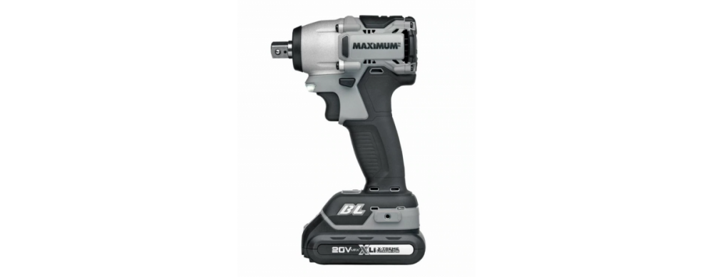

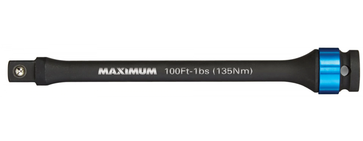

I few years ago I bought a kit with an ultra-compact (nose-to-rear-tool measurement of only 5-7/32" (132 mm) 1/2" square anvil drive with friction ring system.  Regular pricey at CAD $329.99 + tax; I bought it on sale for about 35% off, I believe.  It has 3-speed range selector switch: lower range (0-1200 RPM/0-1650 BPM), medium range (0-1700 RPM/0-2510 BPM) and higher range (0-2800 RPM/0-3300 BPM) to adjust to the task, built-in LED work light with time-delay, and remaining battery power LED indicator.  The kit came with the 1/2" brushless impact wrench, two 2Ah batteries, 35-minute fast charger, belt clip and carrying case.  It delivers up to 165 ft-lbs of maximum torque which is plenty for my 2011 Edge (100 ft-lb torque recommended by the owner's manual).  It has been able to ALWAYS bust off the wheel nuts but, I ALWAYS use a torque-limiting extension stick to avoid overtorque ;) and then finish tightening up with an accurate torque wrench.   The gun is small and light enough to fit in the glove compartment (but I put it on the cargo for the road). ...And it can change four sets of wheels (two cars, 16 wheels!) off and on only one full charge, and still it has plenty of juice left to go for more...
HIGHLY recommended.

Just to clarify my use of the gun I posted above, no intention to "sell" off my tool, not of any personal benefit to me; in any case it's just free ad:
I don't spin the nuts completely at full torque; I just use it to break off and to tight up.  It works like a pistol trigger: set at high speed range (0-3300 BPM) with full trigger pressure gives full torque; once the nut breaks loose you release the pressure off the trigger and instantly decreases the spin to a nice very slow unscrew.  It does the same in reverse mode set at low speed range (0-1200 RPM).  You control the torque/spin with the finger pressure on the trigger...
The OP/TS was asking about an impact wrench; that's way I'm giving the info about mine. Bear in mind that my 2011 Edge requires only 100 ft-lbs torque.  This gun does a great job for that torque.
I have electric (corded) and also compressor air nut busters, one even with digital display to set the torque.  None of them compare with this little portable gun for the its job and convenience.

thanks, that's the kind of info i was looking for.
HIGHLY recommended.
This is a Canadian Tire house brand tool only available in Canada AFAIK. A few years back I bought an impact gun of this brand only to have both batteries fail in less than a year. The price for replacements was so high I gave the tool away. I see they have redesigned them to work with 20V Dewalt Max batteries now. A step in the right direction.
Yes, I also did a recent search (after my post) and found out they now have two newer models of the same tool with lots more torque, but bulkier, of course.
BTW, they say that the DeWalt batteries won't fit, have to be their proprietary batteries.  All mine over three years now, so far so good 👍, but I'm not a heavy duty user, I admit.
