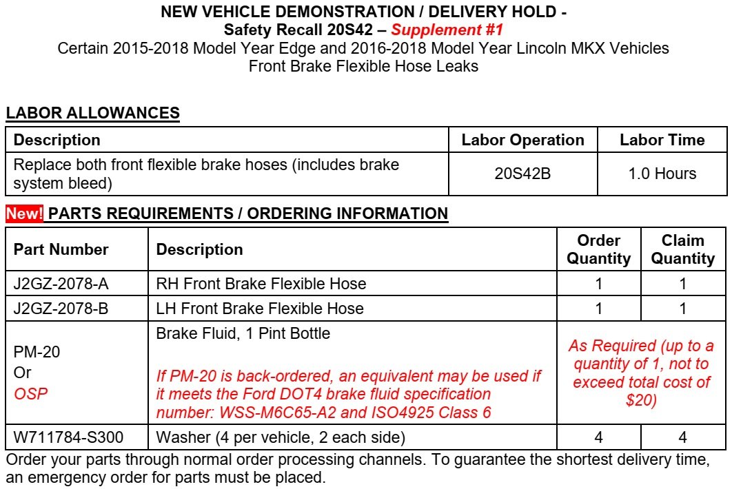

clegg78 Report post Posted August 24, 2021 So... I got tired of waiting on ford and the recall parts, you can order the new model parts without too much worry. F2GZ-2078-H and F2GZ-2078-G are the replacement hoses for the recall (they have a slightly different PN as part of the recall starting with a J). The dealers screwed me around on getting the right parts, but you can order them on Tasca or even Ebay easily and do the work yourself in 45 min or so. Share this post Link to post Share on other sites

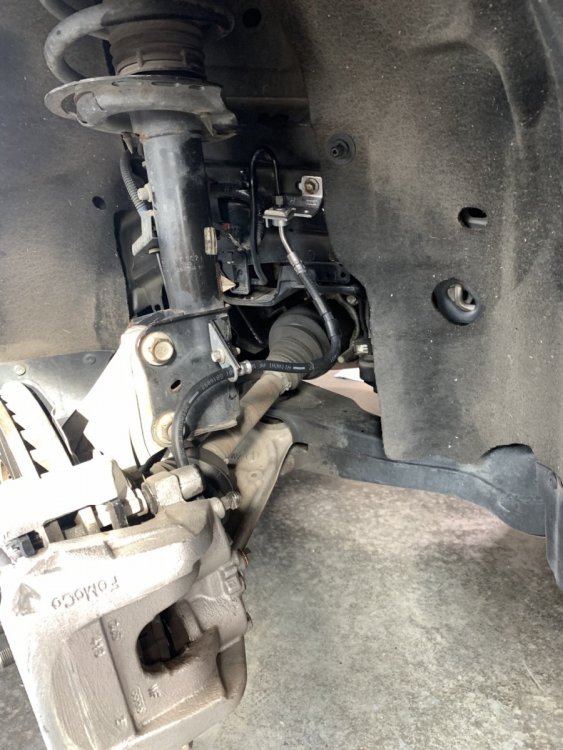

1004ron Report post Posted September 29, 2021 On 8/29/2021 at 10:04 PM, clegg78 said: Good call on that, I found some 10mm copper washers at the local parts store and used them Got my brain swap done and new hoses on the front! No waiting on the dealer for their delays Any pointers for this job? I plan on sealing the master cylinder reservoir cap while I remove the hoses to limit fluid loss introducing air into the system. Want to avoid air in the ABS unit. With the new hoses installed I plan on a fluid flush which I've been holding off until the hoses are replaced. Share this post Link to post Share on other sites

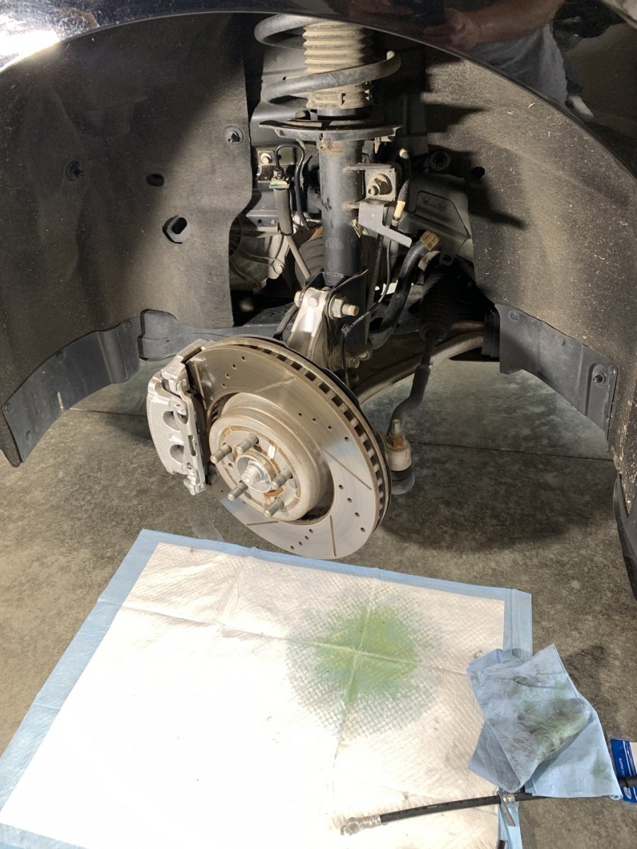

clegg78 Report post Posted September 29, 2021 8 minutes ago, 1004ron said: Any pointers for this job? I plan on sealing the master cylinder reservoir cap while I remove the hoses to limit fluid loss introducing air into the system. Want to avoid air in the ABS unit. With the new hoses installed I plan on a fluid flush which I've been holding off until the hoses are replaced. Yeah I left the master cyl closed/reservoir cap on. If you are just replacing the hoses and not re-mounting the calipers, the only real important thing would be to make sure you clean the area around the hose connections well as it will be out of your view for the most part. Ensure you have a lot of water/brake cleaner around... I tried both ways of disconnecting the hose at the chassis first then the caliper, and vice versa and both methods make quite a mess. Have the old brake hose unbolted at the strut and ready to be removed when you start, put down some pig blanket/absorbent pad to catch all the fluid. Also make sure the right hose goes on the right side they are directional. That's really it, just be sure to wash off all the brake fluid that goes all over! You shouldn't drain much out of the reservoir doing this, but make sure its topped off before you start. 2 Share this post Link to post Share on other sites
1004ron Report post Posted September 29, 2021 (edited) Thanks @clegg78 I plan to fill the reservoir leaving very little air then put the cap on with a mechanics rubber glove to stop the caps breather from allowing air in - that should significantly reduce the fluid loss/mess. See attached picture of the goods I picked up from the dealership. Edited September 29, 2021 by 1004ron Share this post Link to post Share on other sites
1004ron Report post Posted September 29, 2021 On 8/25/2021 at 6:45 PM, clegg78 said: If you want to do the work yourself: https://www.ebay.com/itm/133607477882 and https://www.ebay.com/itm/133607479147 (These dont include washers, but I am going to reuse the existing ones.) Those part numbers don't match what I got. Share this post Link to post Share on other sites
clegg78 Report post Posted September 29, 2021 (edited) 14 minutes ago, 1004ron said: Those part numbers don't match what I got. The J2GZ parts are the actual Recall tracked parts. Its to easily identify if a recall has been done. The parts above F2GZ are the OEM standard parts that are shipped on all the cars. Mine that I ordered were mfg'd March 2021 (edit, just looked at a pic I took to get the right date) , so well after the recall and parts fix was done. They are the same hose/fitting otherwise. Most dealers/parts depts wont sell or even offer the J2GZ parts for non dealer installs and parts supply issues. Edited September 29, 2021 by clegg78 Share this post Link to post Share on other sites

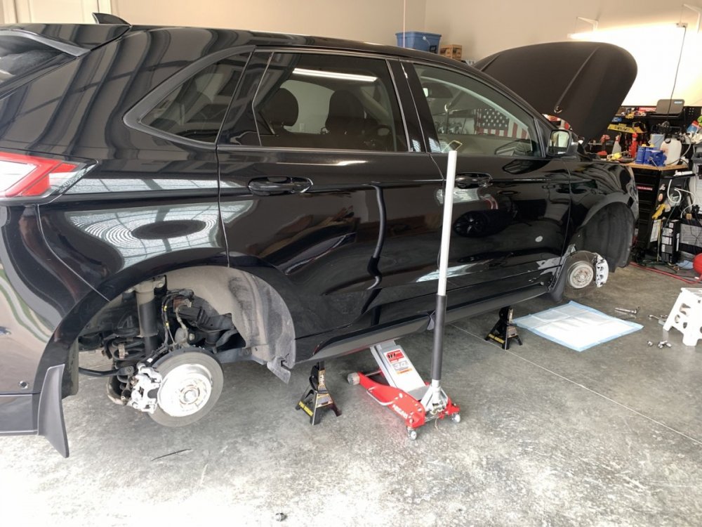

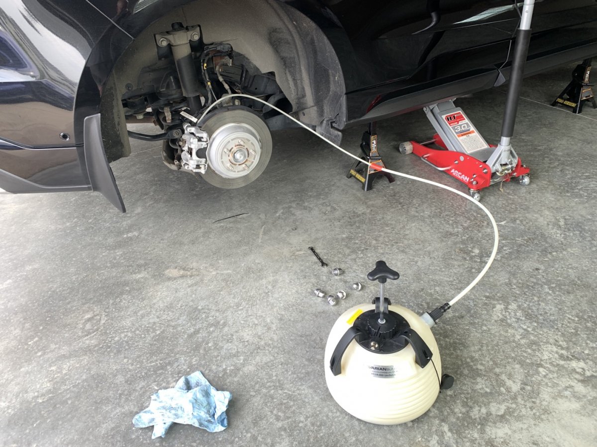

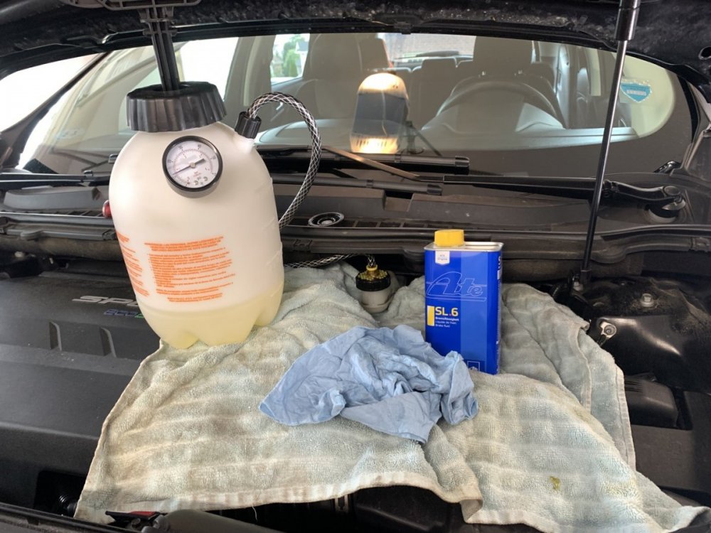

1004ron Report post Posted October 2, 2021 (edited) I completed the brake hose recall and a brake fluid flush today. The rubber glove on the fluid filler defeats the caps breather and limited the amount of fluid mess - with the old hose removed there was no dripping of fluid. For the flush I use a home made pressure bleeder and my oil extractor vacuum - the vacuum isn't really needed, but it makes for a no hassle, no mess. Edited October 2, 2021 by 1004ron 4 Share this post Link to post Share on other sites
