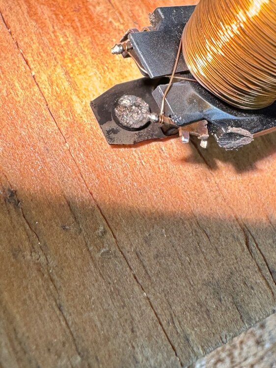

LostInTennessee Posted September 17, 2020 Report Share Posted September 17, 2020 (edited) 2015 SEL 2.0L Turbo 117,000 miles This has happen twice, the first time the radiator fan continued to run at high speed after the engine was turned off and ran the battery down, had to jump off. Car was ok, i.e. problem didn't return. Then yesterday the same thing happened and I disconnected the battery and the fan whet off, but connecting the battery again starter the fan running. Left the battery disconnected over night and reconnected the battery in the morning and the fan DID NOT START. . Checked the relayes (32,38,39) and they seemed to be OK. After several trips today, still seemed to be OK. I will pull the relays one at a time to see which one is closed. Any suggestions? Edited November 11, 2020 by LostInTennessee Quote Link to comment Share on other sites More sharing options...

LostInTennessee Posted September 29, 2020 Author Report Share Posted September 29, 2020 Solved (maybe) When it happened again, I felt each relay (32,38, and 39) and all where warm BUT relay 39 was hot. I removed 39 (fan stopped) and moved the relay in 38 to the 39 slot and the fan stayed OFF. Replaced the bad relay with a new one and all is well (so far - 6 day ago). 1 Quote Link to comment Share on other sites More sharing options...
