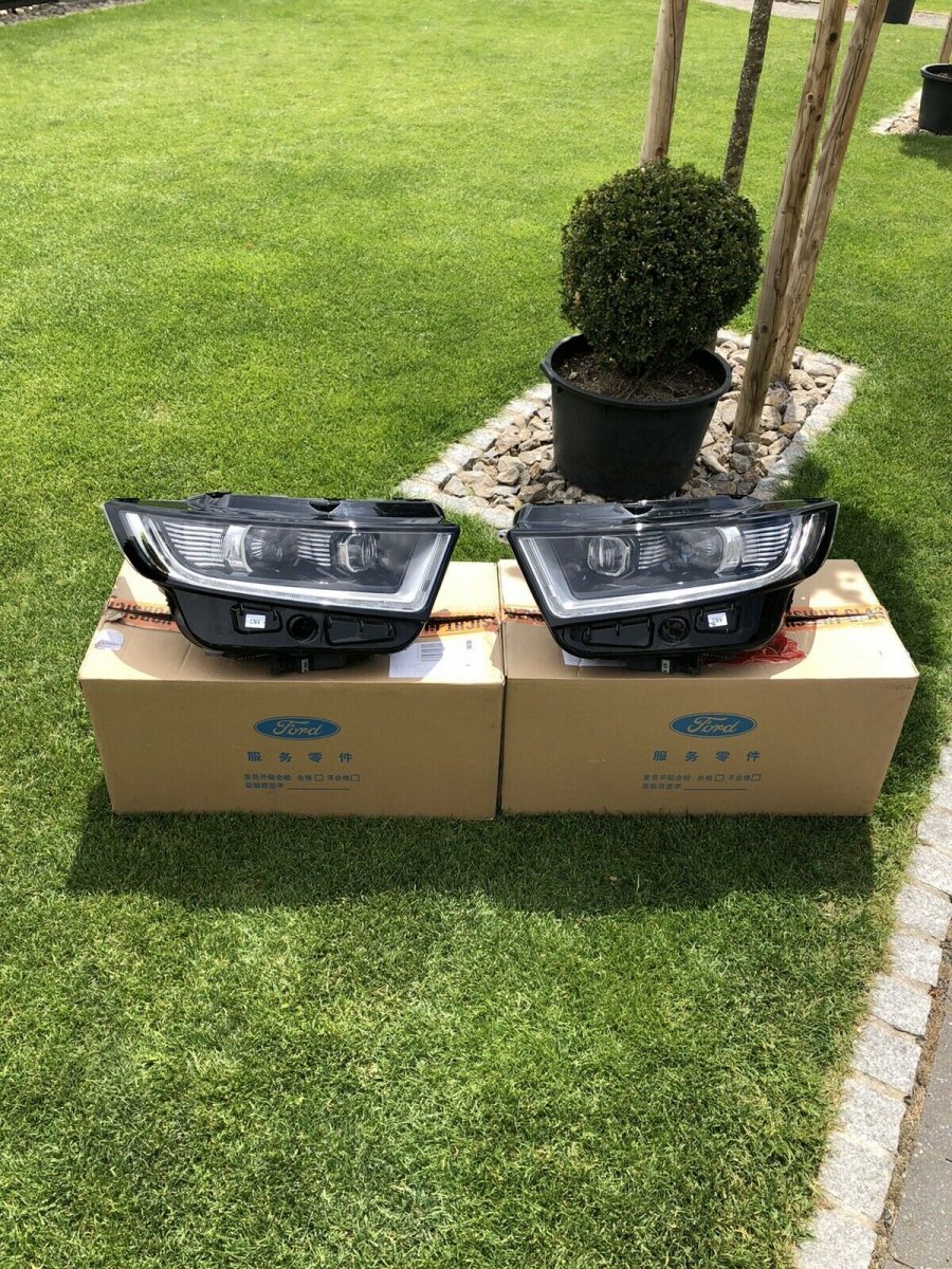

Thanks! I had to purchase it (wasn't cheap but made it easier for me to visualize some things) - it's from TurboSquid.
The Euro headlights I had to go onto the German eBay site to try and find them. And messaged a seller willing to ship them to me internationally. They were about $950 total + $200 for shipping.
I did a lot of research because there are other non-OEM lights on eBay and Alibaba from China - and they actually advertise many of them using OEM photos, when in fact the style they sell was a bit difference. You don't notice it until you really inspect the photos posted on the listing. So I had to make sure I bought used ones and that the part numbers were legit from Ford. Hopefully I get those in this week or next week and I'll post some photos! I'm hoping they will be just plug and play.

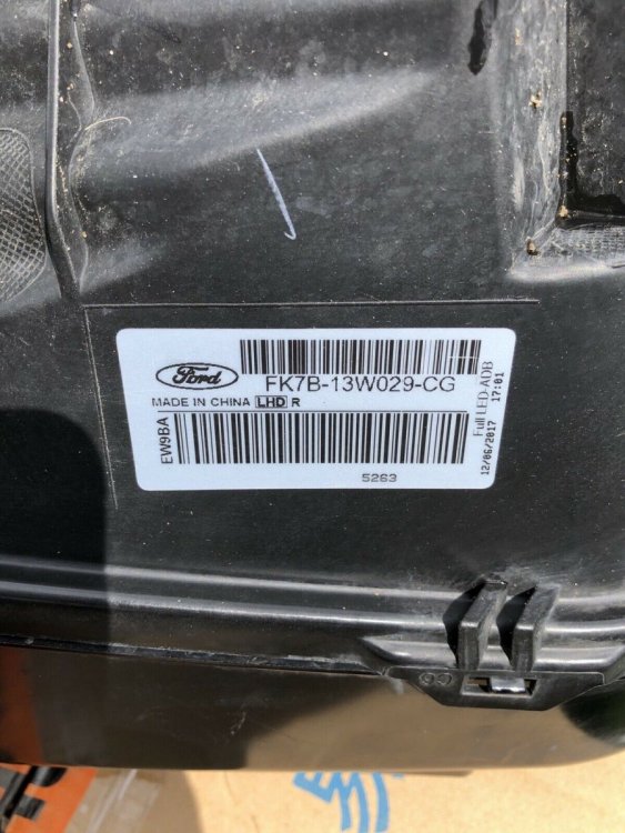

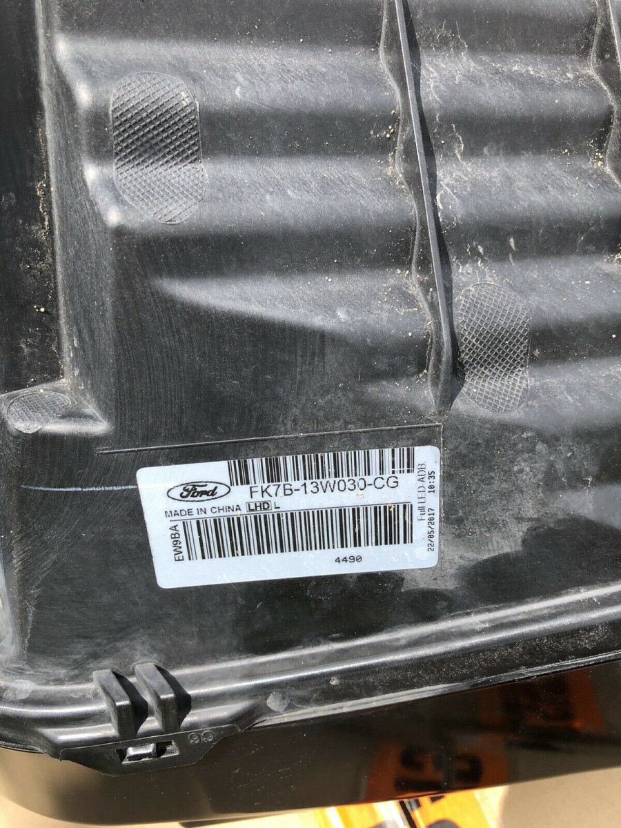

are they LHD cutoff or RHD cutoff? I know Germany is LHD but that does not mean these came from a LHD Edge
Edited by Nick Halstead
You scared me...I didn't even know that was a thing. Luckily I just looked up the pictures with the part numbers and they say LHD on them.

15 hours ago, Nick Halstead said:
Nick, just by looking at them on top of the boxes I don't really see a difference when compared with the original ones... Please post pictures "before" and "after" once installed to make it easier to compare!

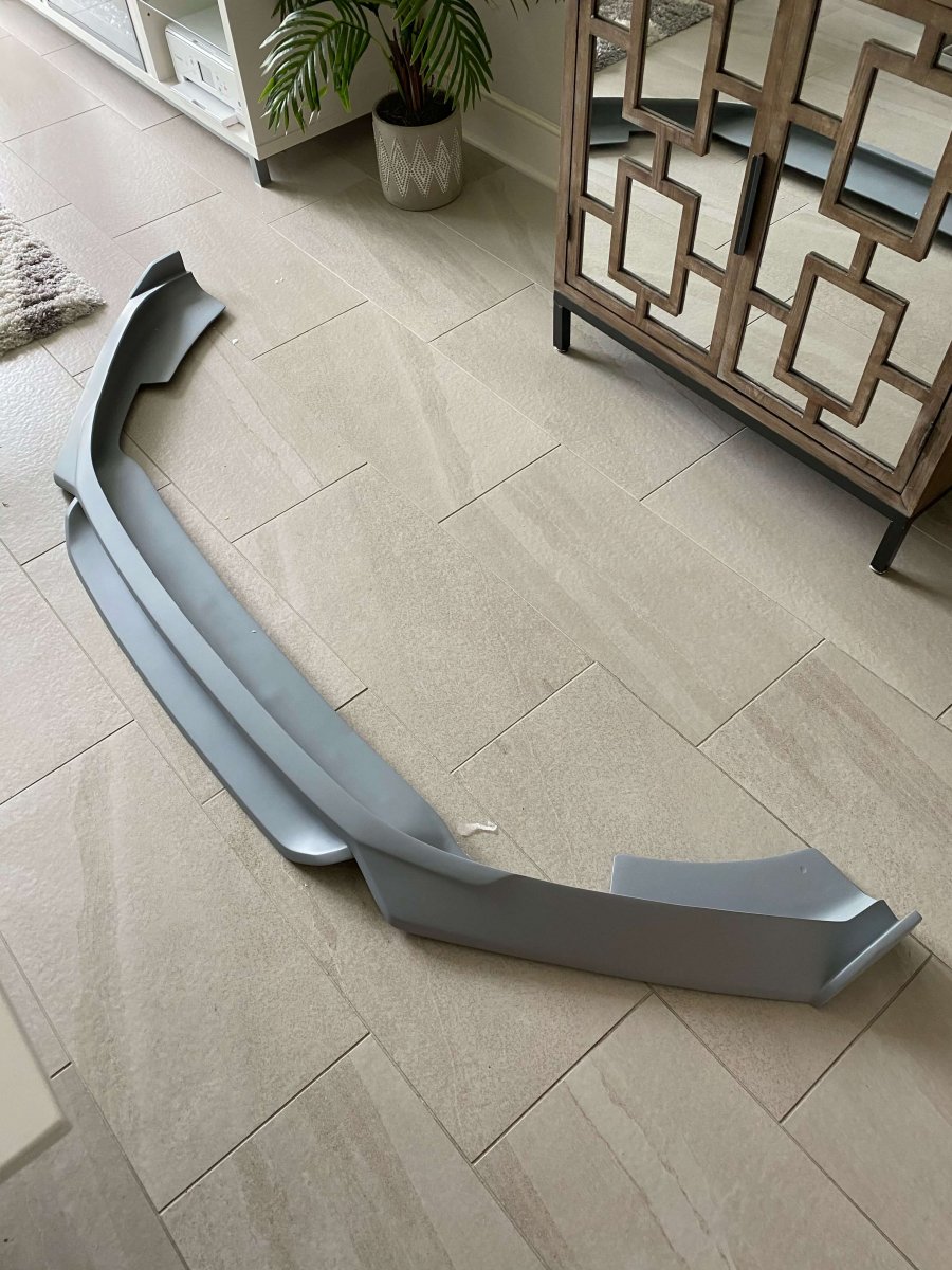

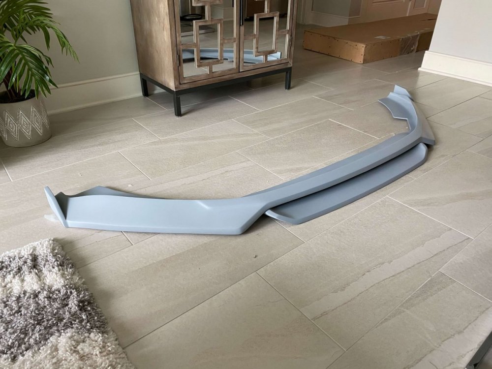

Just got my front splitter in from SS-Tuning...I have some work cut out for me as I need to decide how I want it painted + installed (maybe all matte black + gloss black on the lip in the front center). Headlights should be arriving next week.

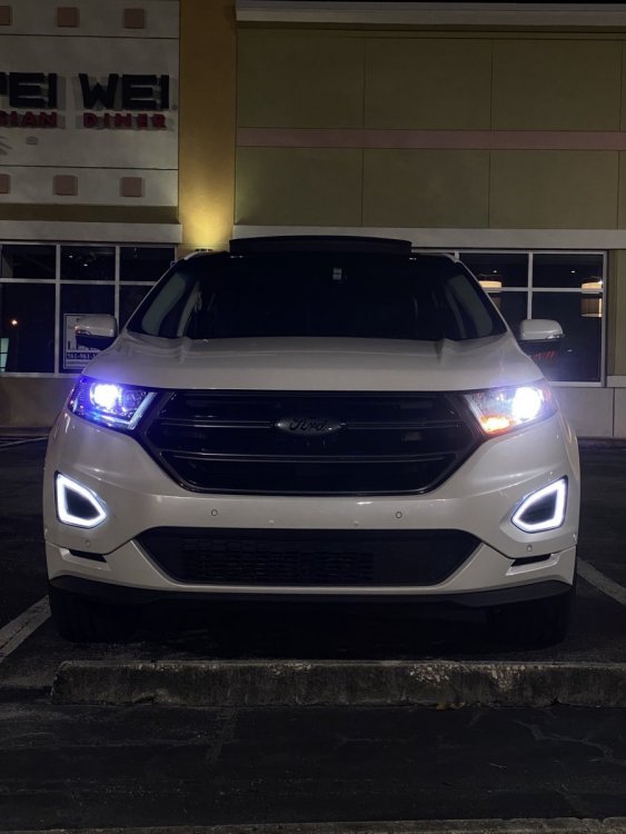

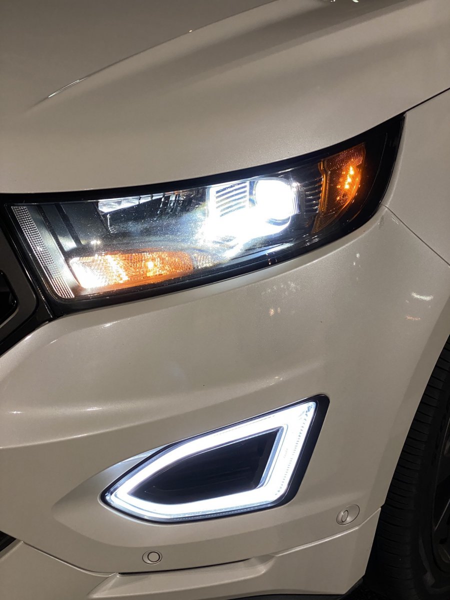

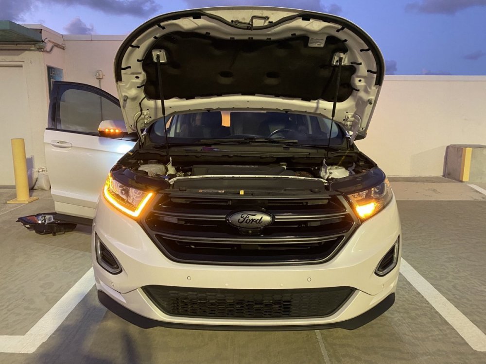

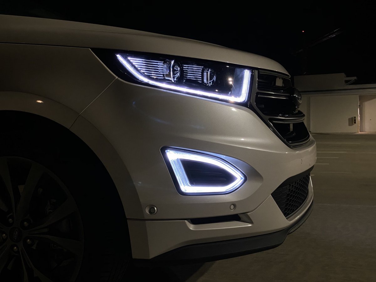

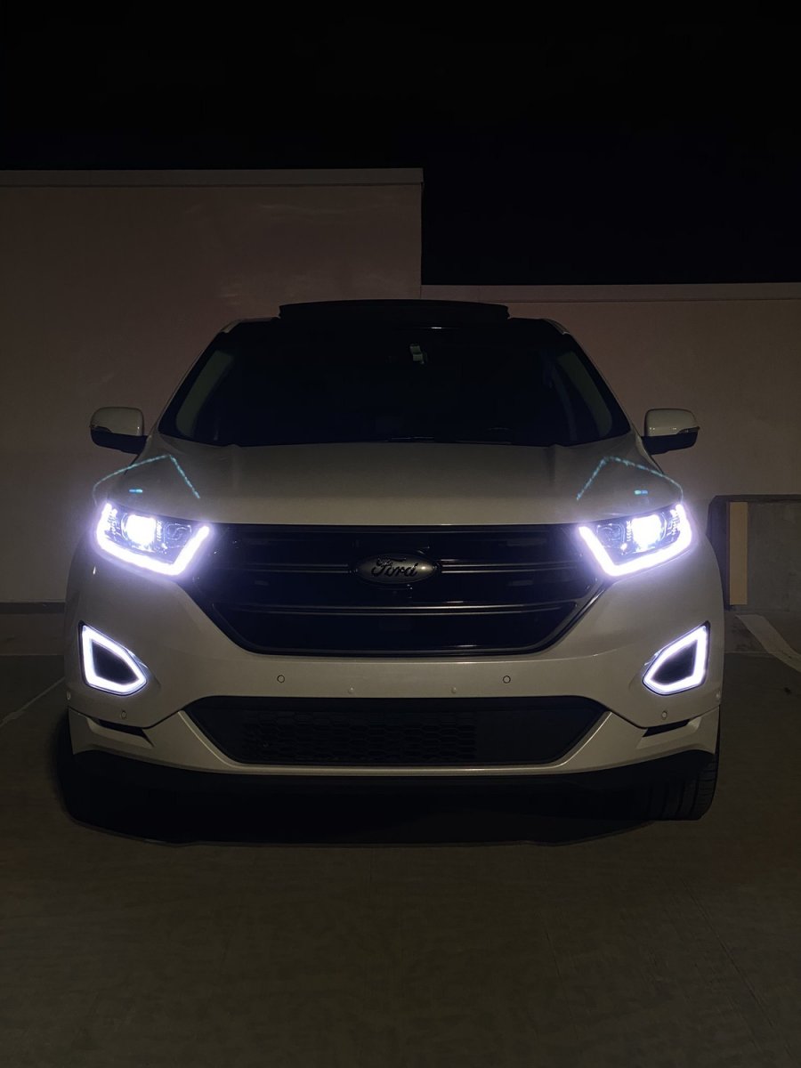

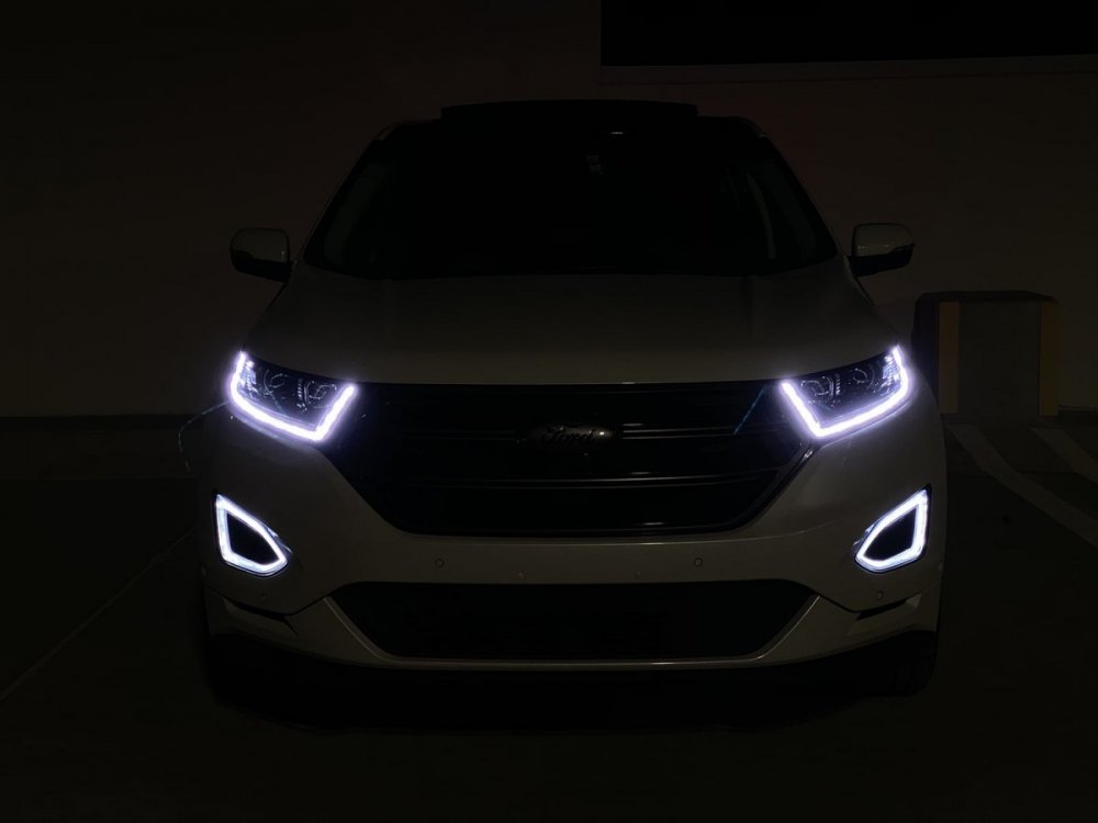

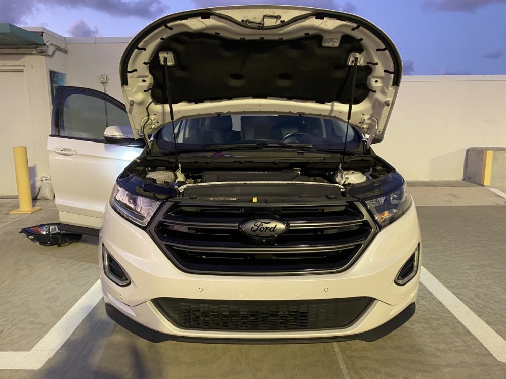

Soo I got the headlights in...and they're not 100% plug in play. I'm probably the only crazy person to try this but if anyone else has any insight that'd be greatly appreciated.
So I got the passenger headlight in fine. Except only the low beam + blinker works. The high beams and the DRLs do not work at all. Which is primarily what I bought these for what the white LED daytime running light strip.
The driver side headlight I can't even install...so the location where the wiring harness plugs in is on the European headlights is a lot further away than the stock lights. Meaning the driver side stock wiring harness won't reach at all. Needs to be a good couple of inches longer to reach.
I happened to have a scheduled service appointment already at Ford. So I dropped the car off to see if there's anything they can custom do to A] extend the wiring harness and B] see if there is some sort of code or programming that has to happen in order for the car to recognize the DRLs and High Beams on the Euro lights. If anyone has any idea on how to possibly make those functions work that would be great. I just got a call from them saying they probably won't be able to change the computer settings (FORScan related I'm assuming) because it's of a different country.
Pics below without the DRLs working. But you can see the comparison between the stock Sport light (on the right/driver side) and the oem Euro light (on the left/passenger  side).

The Euro light looks quite good.  Is this LED or halogen?  They have adaptive LED headlamps available across the pond.  Are you still using the U.S. lighting module?
I had HIDs stock, but the Euro ones are LEDs. I am still using the U.S. lighting module. The high beams don't work and neither do the DRLs fully - Ford couldn't help so I likely need to go to an aftermarket shop.

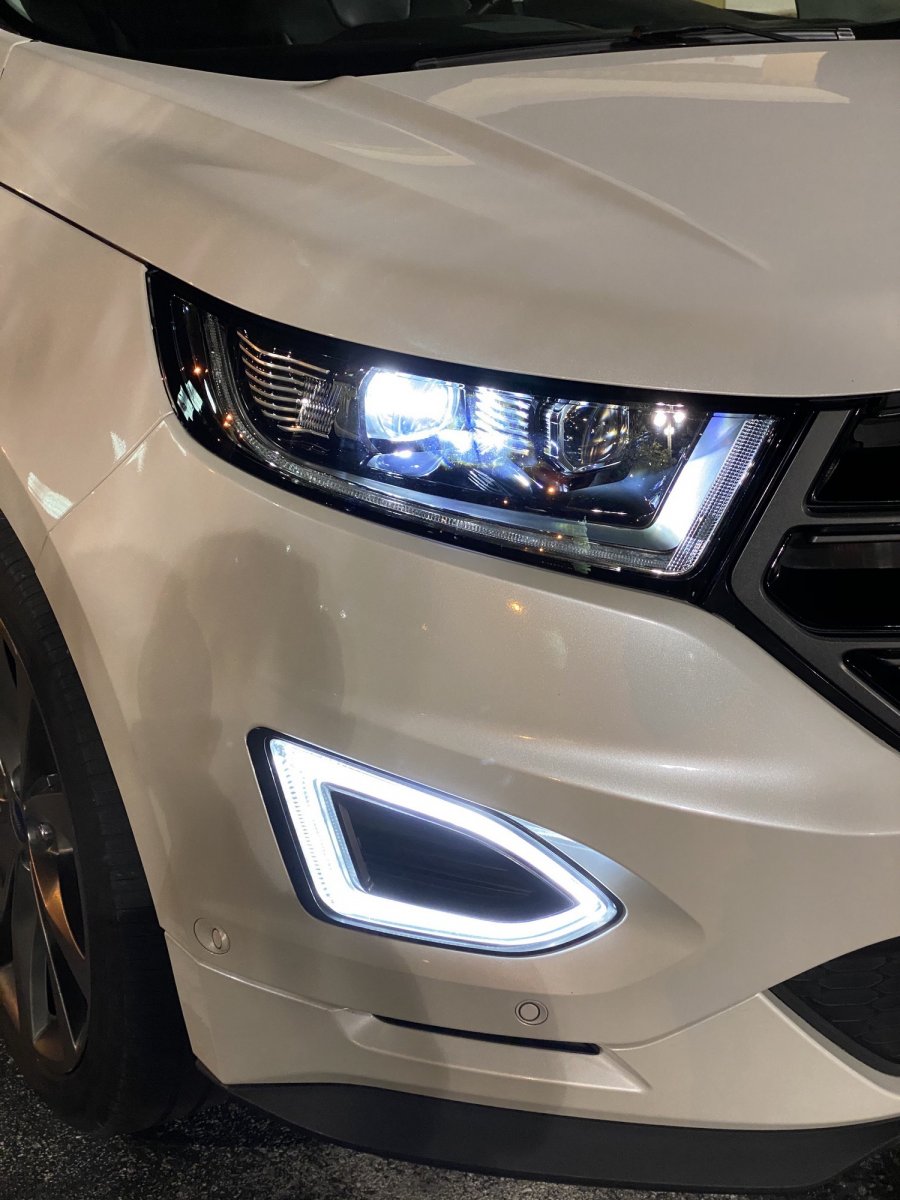

I got both headlights installed (Ford extended the wiring harness for the driver side so I could install it).
I finally got the DRLs to work by changing some settings in FORscan...however they only work while the car is off. As soon as you turn the car off they stop working all together unfortunately. And permanently unless I reset the system in FORscan again. I think it might have to do with the power outage or voltage, I have no idea. I'm glad I know how to get them to turn on but they don't last.
Going to have to find a automative light professional/aftermarket wiring professional to see if they can help wire it separately because I'm stumped. Because I absolutely love them I think they look amazing with the regular DRLs.
