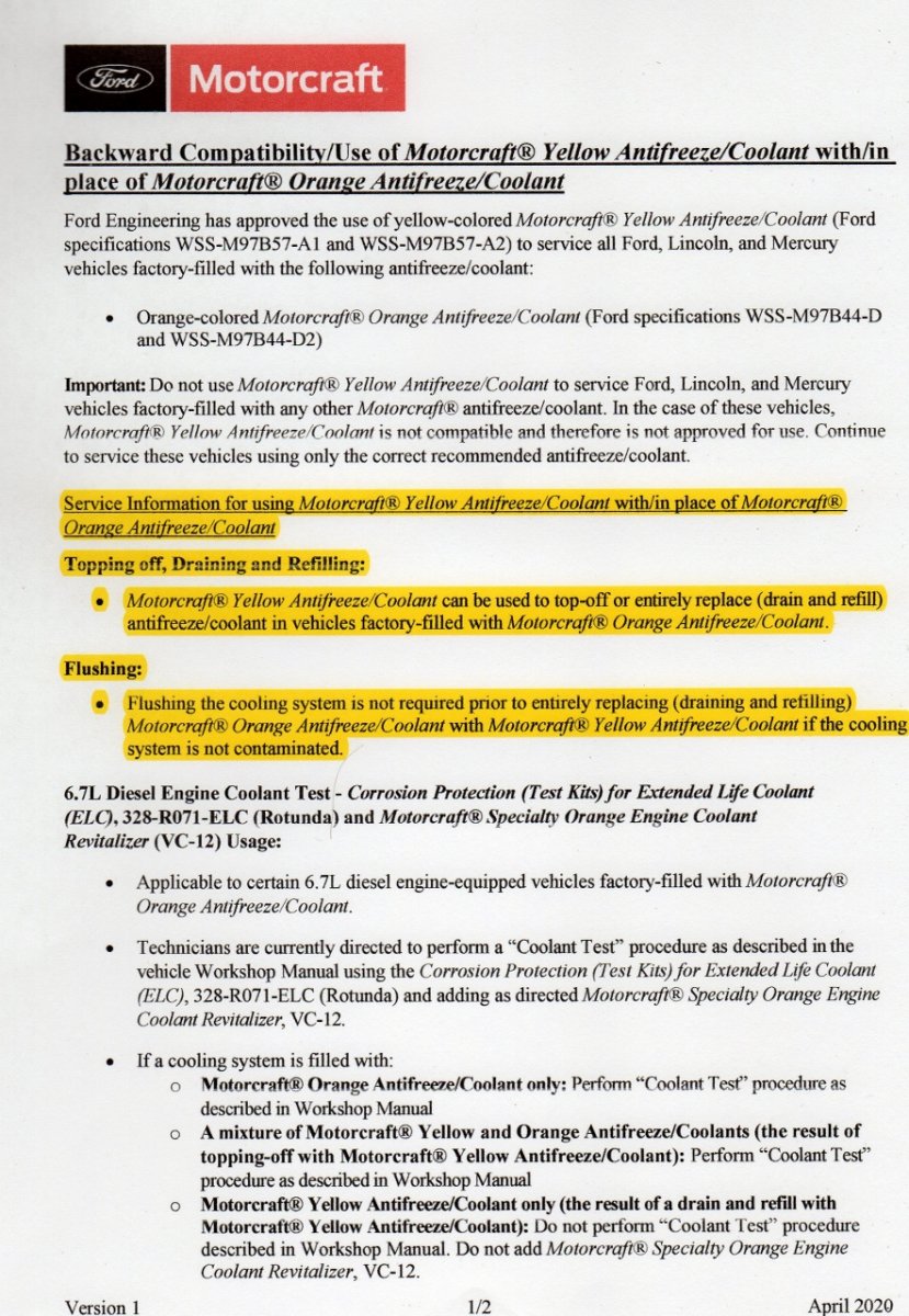

I've got 65K miles on my 2017 Sport and was wondering what interval others are changing their coolant and do you have any tips on draining and filling.

3 hours ago, 1004ron said:
Anyone have details on how to drain and get the most of the old Orange coolant out?
Thanks   onyxbfly   but I wont be doing a "flush", only a drain and then fill with the new yellow coolant.

I prefer to stick with the OEM coolant and changing from Orange to Yellow does not require a flush knowing that the two fluids are compatible.
