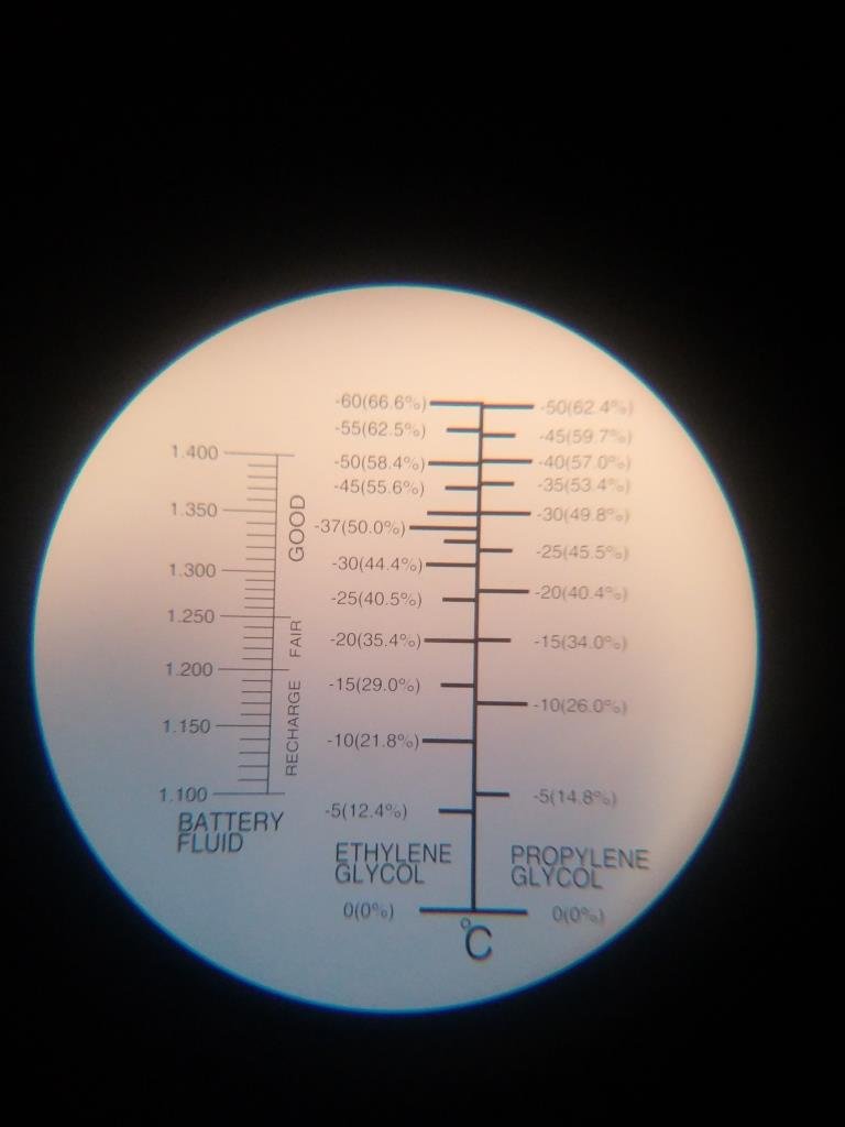

Now, even though this appears to be a "local" issue, I just want to share my "investigation" with you all, and I encourage you to share your opinions or conclusions, whatever you think it happened, feel free to comment, please.
To help you interpret the below results correctly: the blueish optical field represents water content; the whitish optical field represents non-water content (coolant as ethylene glycol in these cases); the horizontal line dividing the two optical fields is the actual reading (result):
1.- Picture # 1 shows the water content of a sample of just pure water (pun intended).  This sample is important for checking the instrument calibration before you take any further samples.  It must read 0 (0%).  The first number is the sample freezing point in degrees Celsius.  The second number (between brackets) is the percentage of coolant (ethylene glycol %) in the sample.

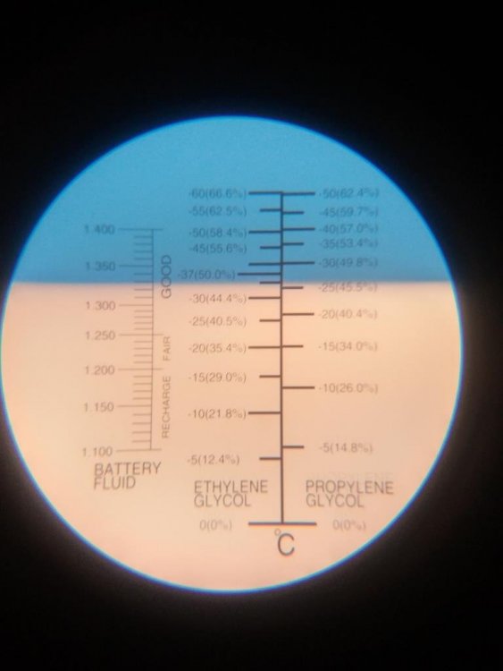

2.- Picture # 2 shows the water content and percentage of the wrong VC-5 coolant "mixture" the dealer put in the system.  I'd really like you all to pay close attention and analyze this picture: I took this sample just before I drove the car back to the dealer (yap, like forensic science, my favorite TV genre ;)).  Please keep in mind that when the dealer put the wrong VC-5 coolant in I got invoiced for only one (1) gallon of concentrated VC-5 (plus labor and taxes).  The dealer told me they diluted it with tap water 50/50 and the invoice also shows they checked the mixture good for up to -40 degrees (Celsius).

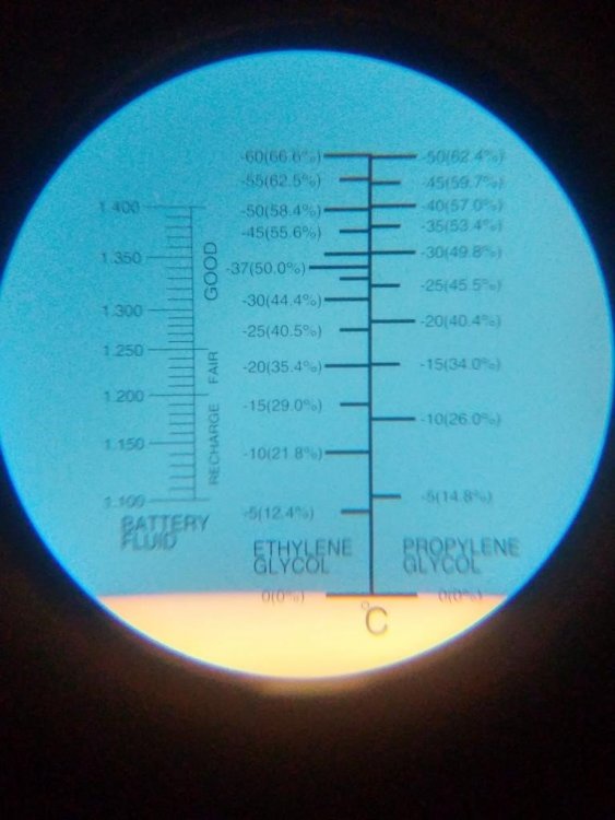

3.- Picture # 3 shows the water content and percentage of the 50/50 factory-diluted VC-DL13-G coolant.  I took this sample right after they replaced the wrong coolant and I drove the car back home.

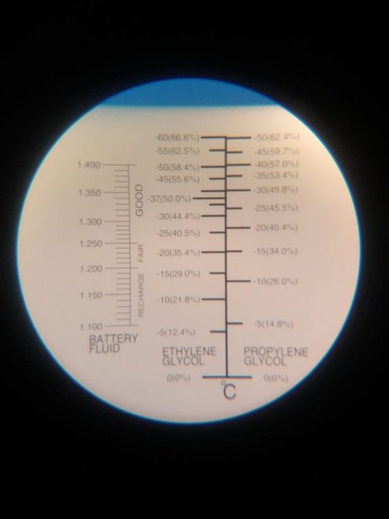

4.- Picture # 4 shows the water content and percentage of the concentrated VC-13-G.  I went back to the dealer a few days after and bought a gallon of concentrated VC-13-G, just to complete my "investigation" ;)

Picture # 2 - wrong VC-5 coolant dealer-diluted w/ tap water 50/50 (?):
Picture # 3 - correct VC-DL13-G coolant factory-diluted w/ distilled water 50/50 (!):
Picture # 4 - concentrated VC-13-G coolant:
