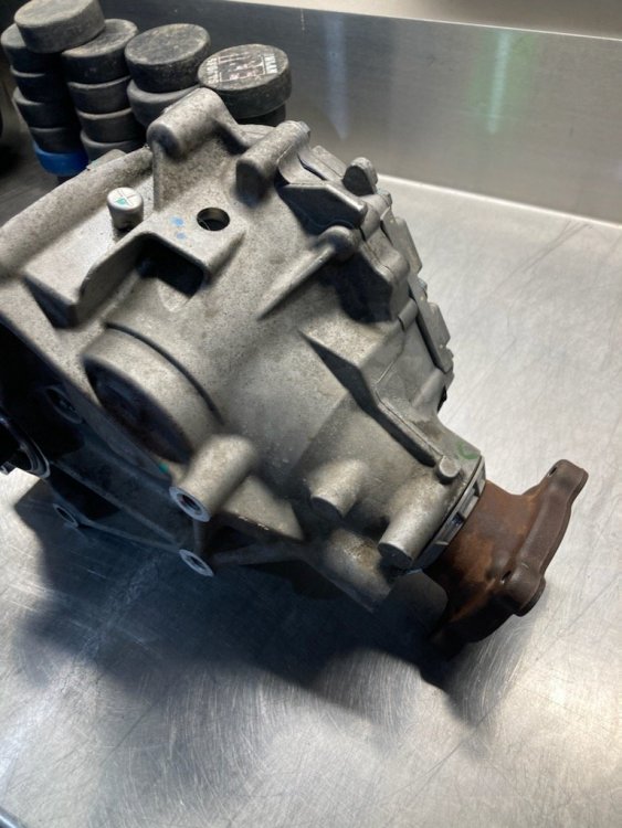

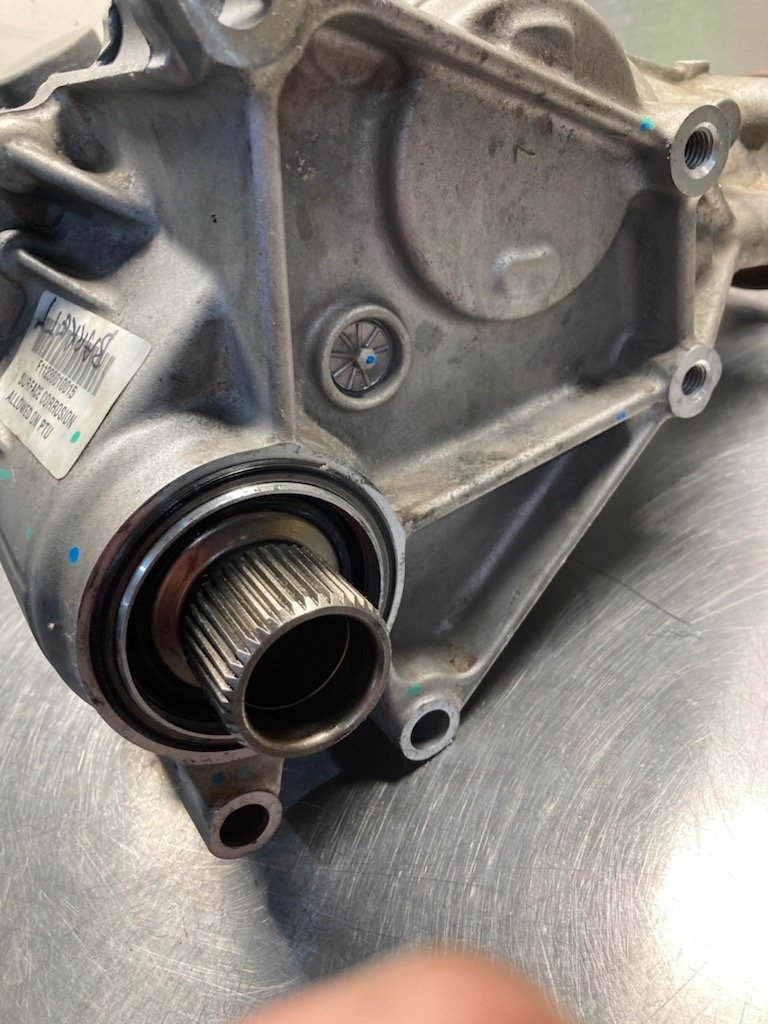

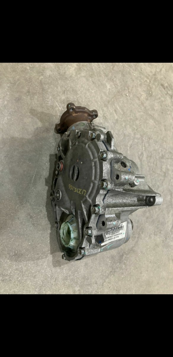

Ok i attached a photo.  Look like its from a 07 to 14? Has no cooler attached
When Ford garage replaced my 2009 MKX unit, they said that Ford had revised the PTU. Larger gear, seals (or bearing, guy was was talking fast) and more oil (if I remember correctly). But no drain. Problem with used unit, you don't know exactly what was replaced and what was retained. If you're selling the car, no big deal, if your keeping the car, New unit would be the best choice for longevity.
Cheaper too!
Edited by enigma-2
Thanks Yeah probably try to sell it after is what it is. Does it look correct.?
