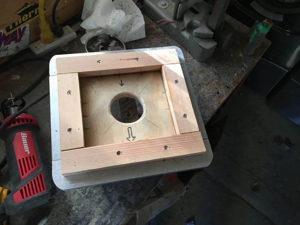

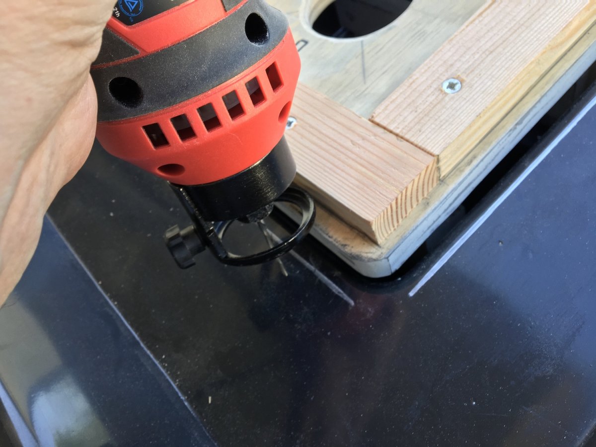

I bought a new cutout tool,  Harborfreight's version of a RotoZip tool . The depth gauge is used to align the bit on the jig. It is basically a small hand held router.
With this cutout tool and  jig I can make precision cuts that don't require very much touch up after cutting.
The jig is used to cut this hole in the Adaptor where it connects to the OEM air box. What would have taken several min to cut, trim to size,  and finish can now be accomplished much easier.

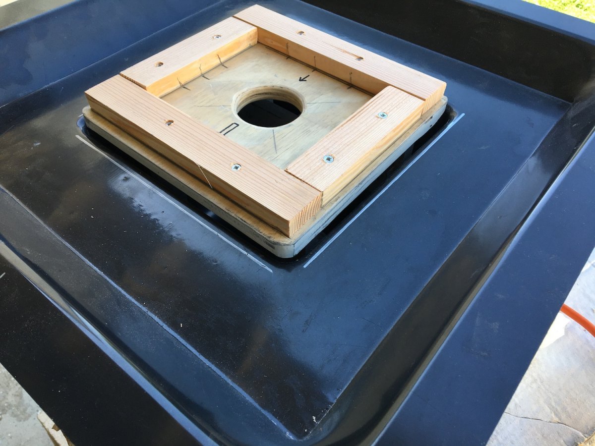

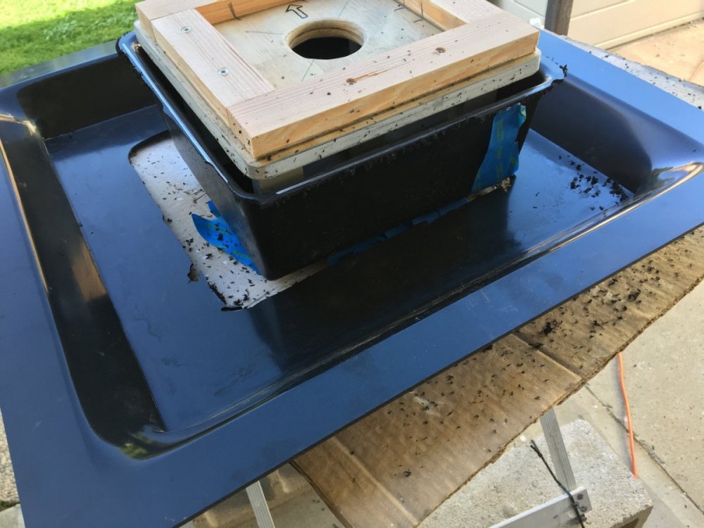

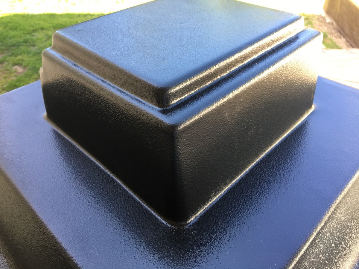

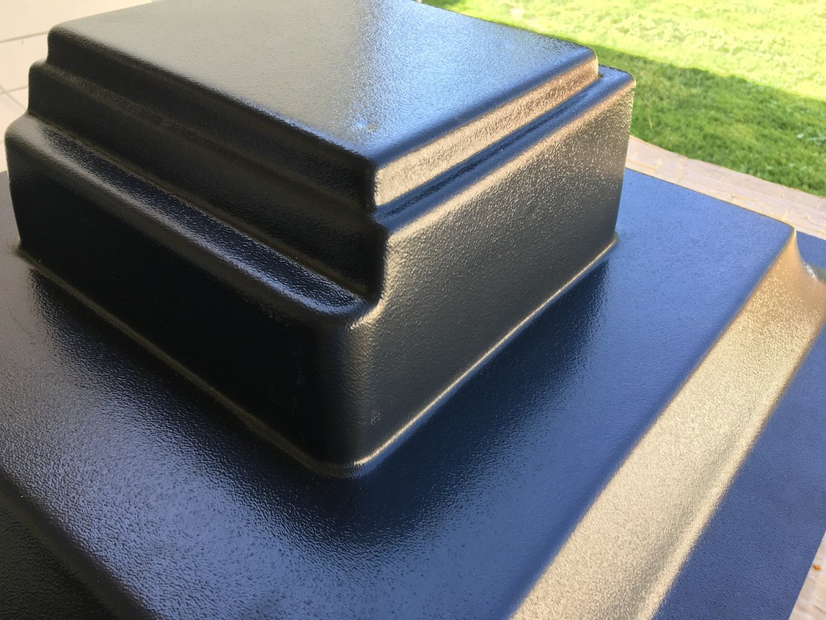

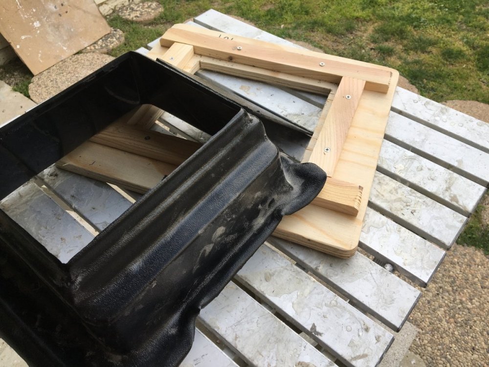

Today I picked up the thicker V3 prototype from the plastic shop and it came out great. I couldn't ask for any better, it pulled onto the mold like a champ.
This  end of the Adaptor has many steps and corners in a small area that did not pull in as tight as I wanted on the first few attempts. Now after the changes I made to the mold and the wood box it is working perfectly,  and the part has great definition.
These are the corners that were squared up and the roundness taken out of them. In the first few attempts this was a major problem. After the rebuild of the box and mold it is fixed and working very well.
With the changes that were made to the box and to the mold, the plastic shop was able to get these great results on the vary first try.  Once I get the cutout jigs finished and the latch mounting jigs made I will do a run of 8.  It will be a complete package that will fit both the Sport and the ST 2.7 EB with your choice of Wet or Dry Air Filter, the Elbow Reducers, Clamps, Sensor, Gaskets, and the Lid. The Auxiliary Air input and Flex Hose will still be offered as an option.

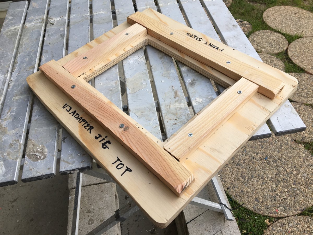

Today I worked on one of the cutout jigs. This jig is used to remove the part from the sheet of ABS. It is not a critical precise cut as it will be trimmed to size later.
Here the jig is set in place ready to go.
This is the RotoZip tool I use. It was not designed for this, but it works. I use the depth gauge to align the tool on the jig.
Once around the jig and done,  easy enough. There are still a few bugs to work out .The ABS is 2X2 and the corners kept catching the RotoZip's  electric cord as I cut, and the part that fell off could be supported to achieve a better cut. The basics are there,  I just need to perfect the process. Overall I am pleased with the results.

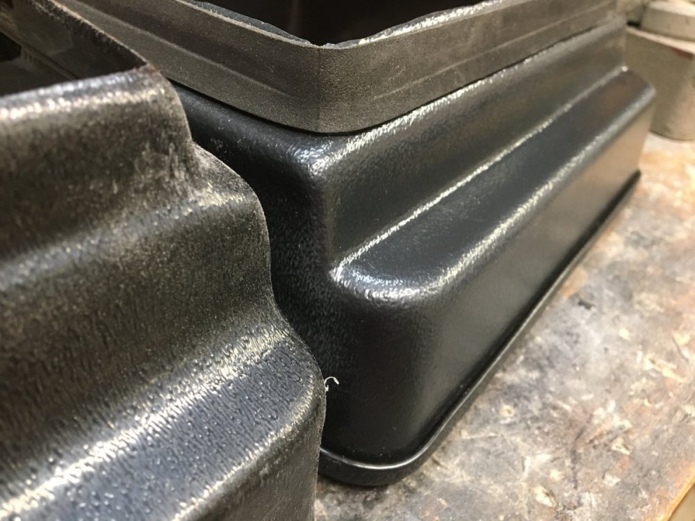

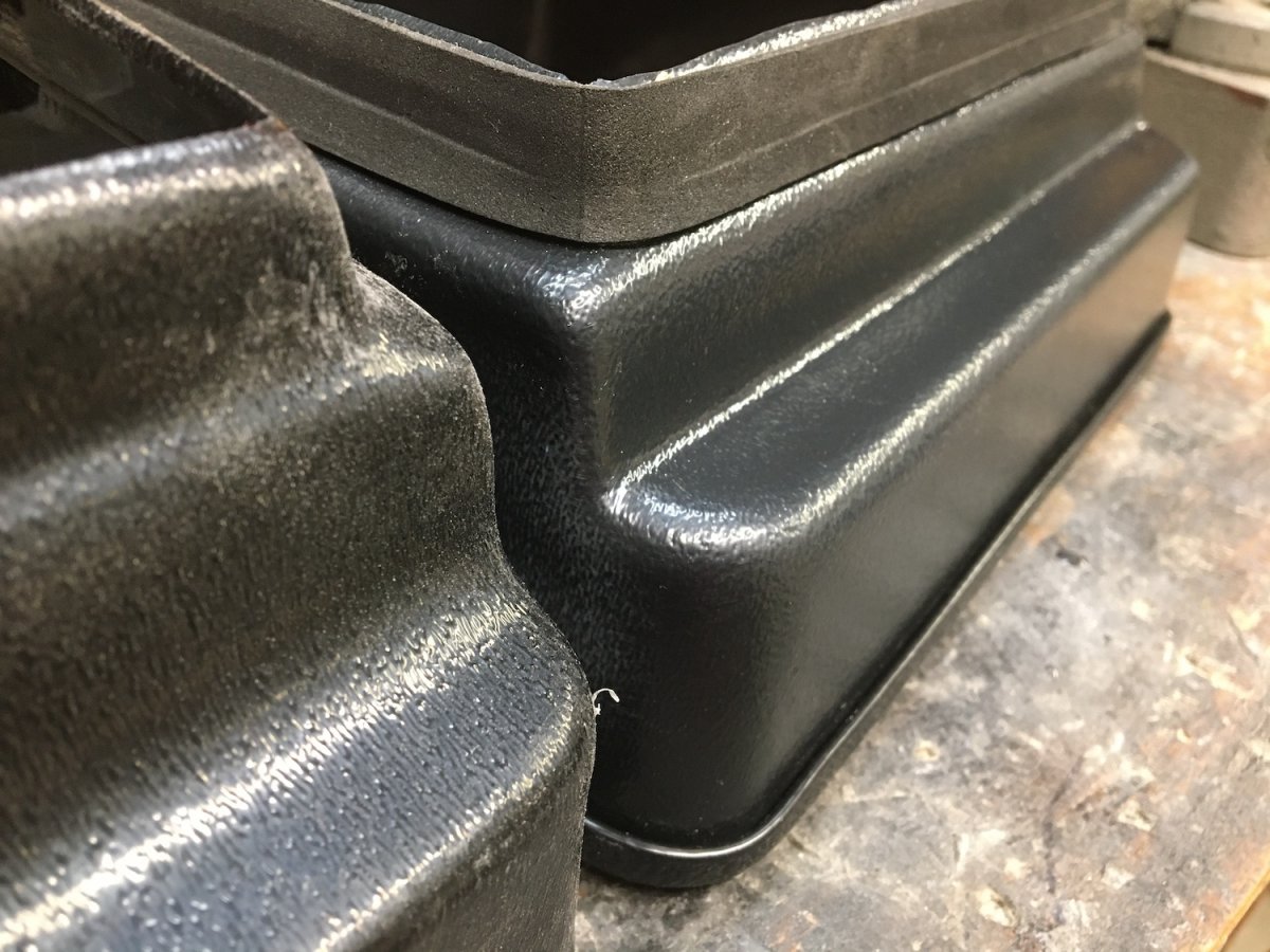

This shows just how much better the mold is working after the rebuild.
The thicker ABS pulled in tight with better definition to the part.  The first prototype can be seen on the left, on the right the new improved version.

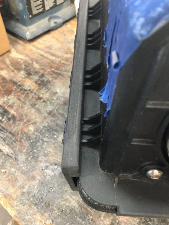

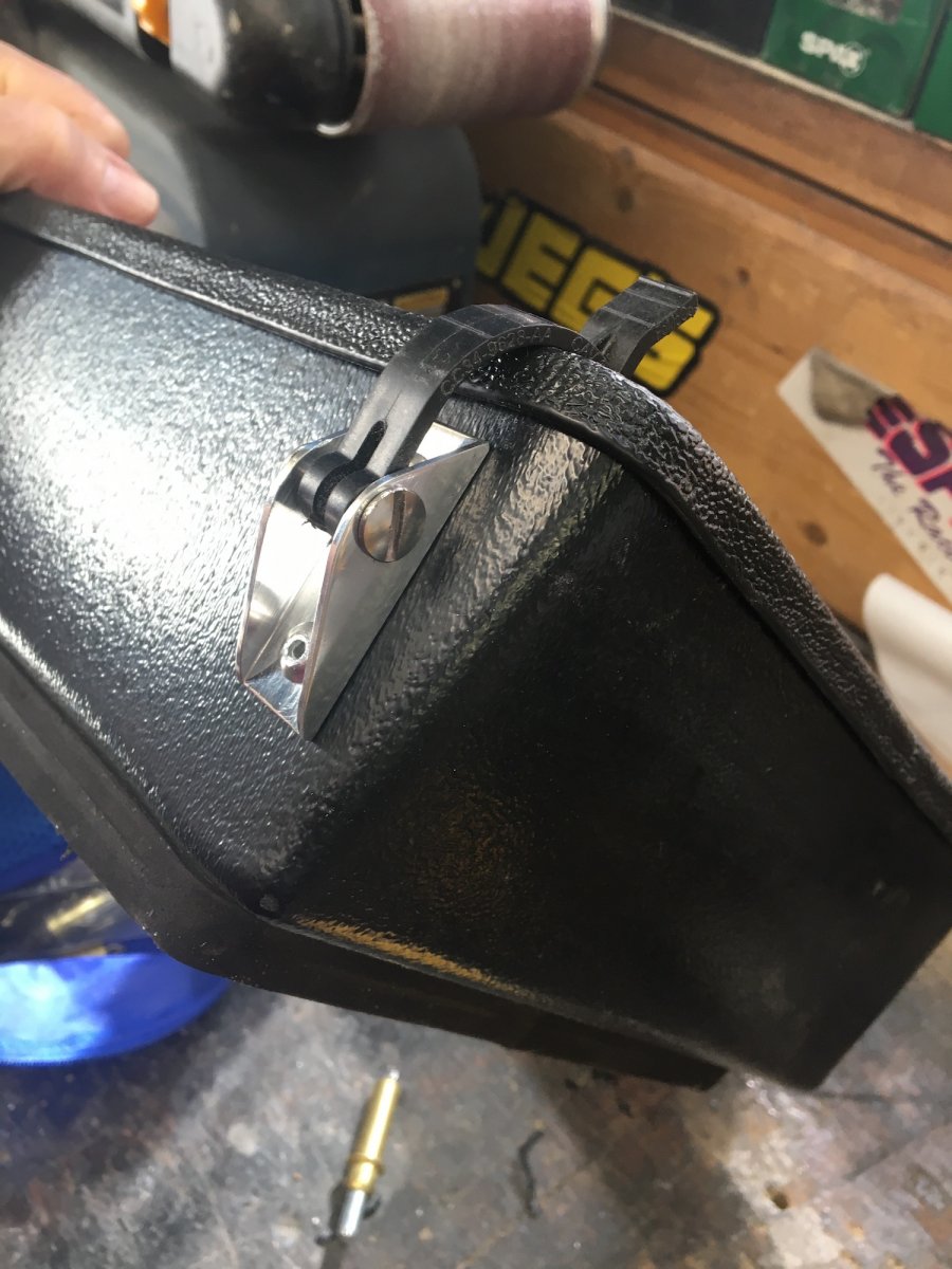

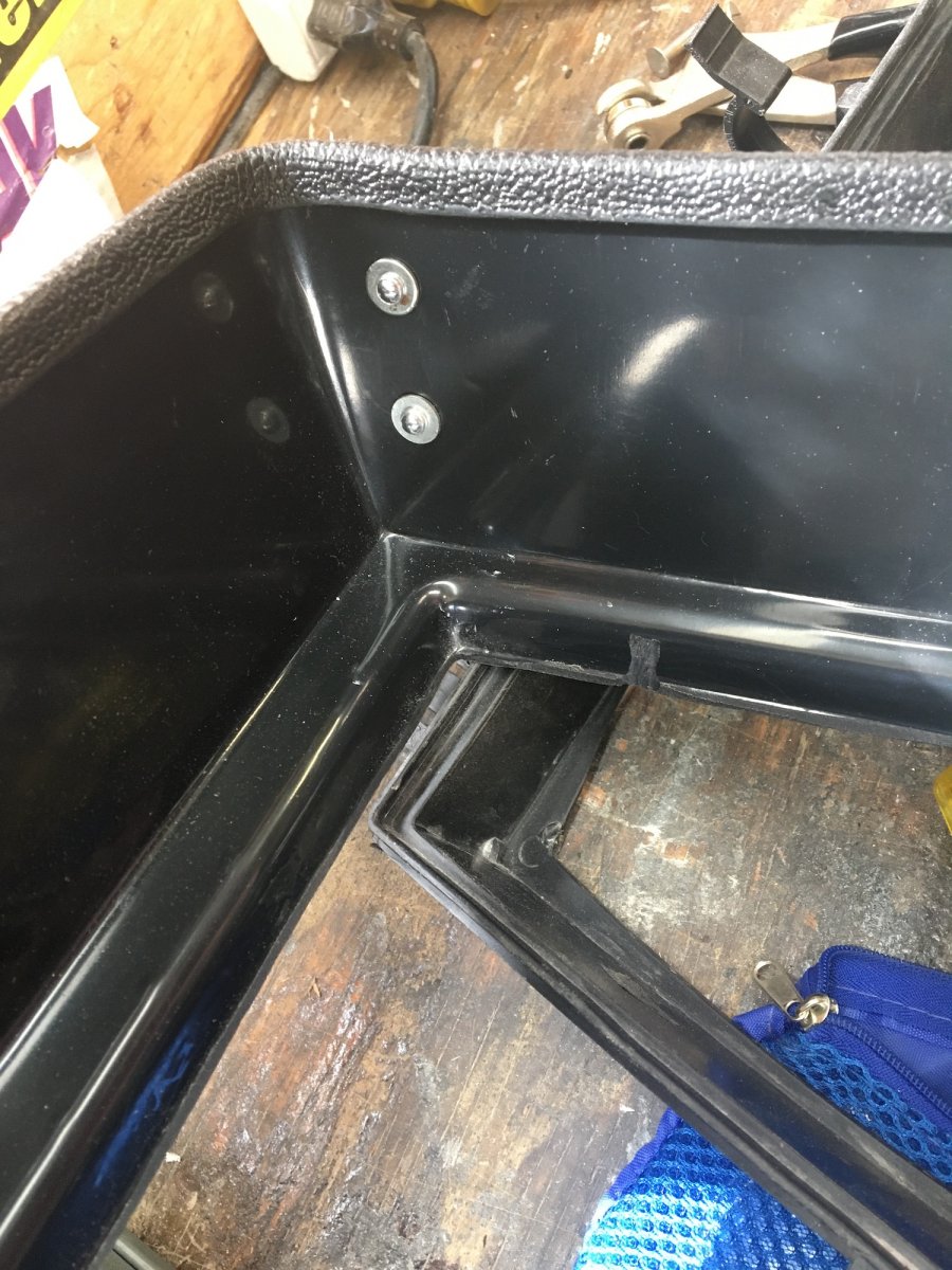

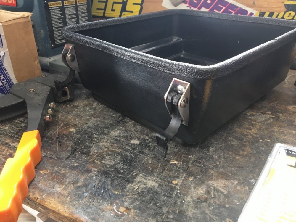

The clip and mount that holds the lid in place. Also have installed the edge protector on the top and the gasket on the bottom. There is no need to make a jig for any of these steps as they self align.
The rivets are backed with a galvanized washer to prevent any rust and stop pull through.
Top, bottom and one side done.. Three sides to go.

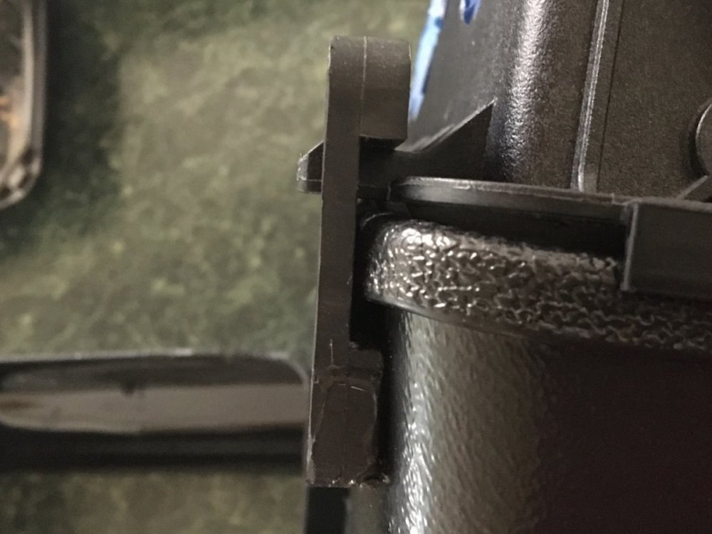

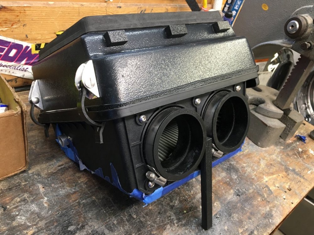

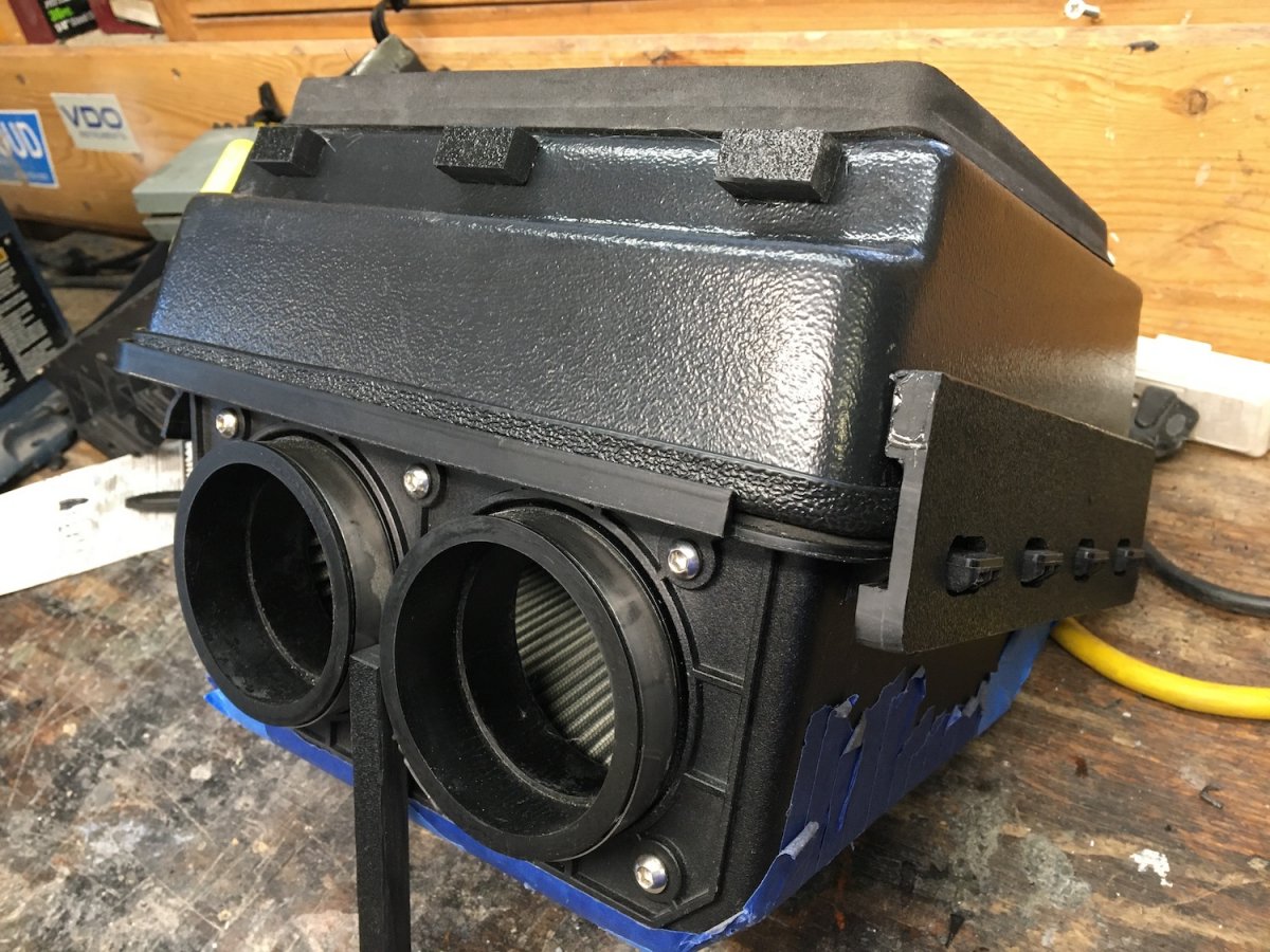

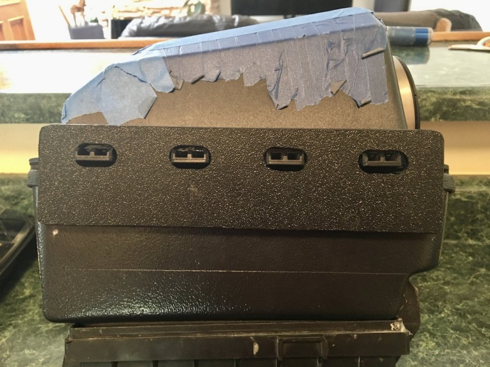

Today I worked on the gate  ( for lack of a better word ) . No jigs were needed for this step as the gate self aligns on the lid tabs .
Here the gate is welded into place. With the gate installed, the lid can be clipped  onto the V3 Adaptor.
Added a 1/4 inch layer to the top of the gate to help hold the tabs on the lid.
Here you can see how the gate is "C " shaped in order to clear the edge protector.The 1/4 inch layer over the lid tabs can also be seen in this photo.
The gate is much smaller and cleaner than the first prototype. It fits much better and no rivets are necessary.
Next step is to work on attaching the Adaptor to the 'OEM air box.

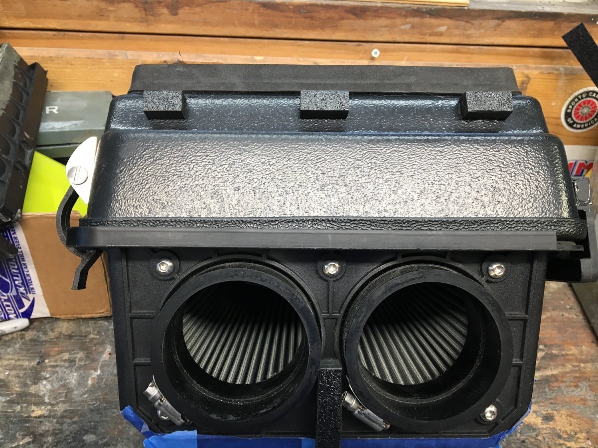

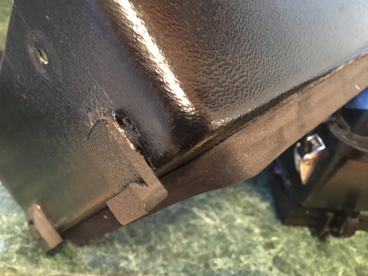

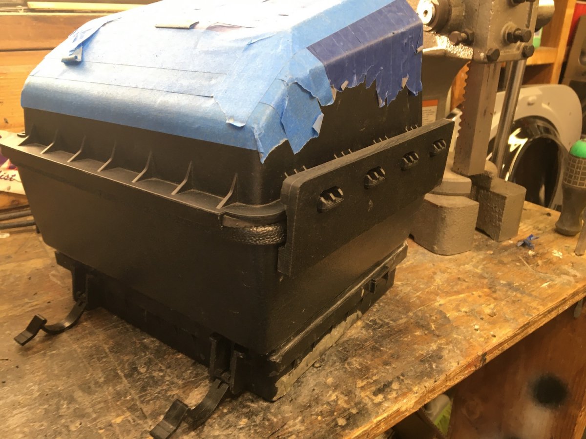

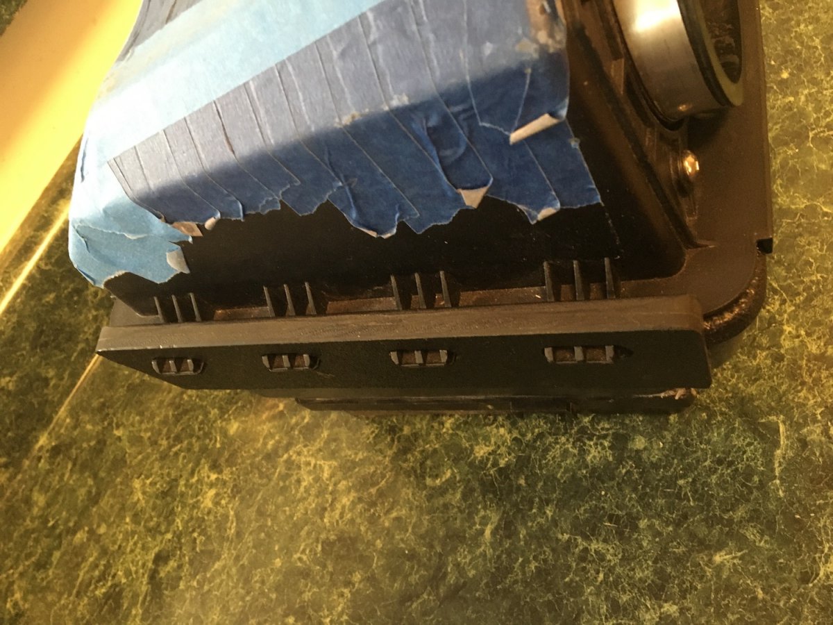

Added these three blocks for the OEM Air Box to catch on.
They are way more precision than the proof of concept ones on the white prototype.  They have only 0.1 for clearance or 0.050 per side. I modded the cut off top of a OEM air box to use as a jig. Yes, I bought a OEM air box and then cut it into pieces.

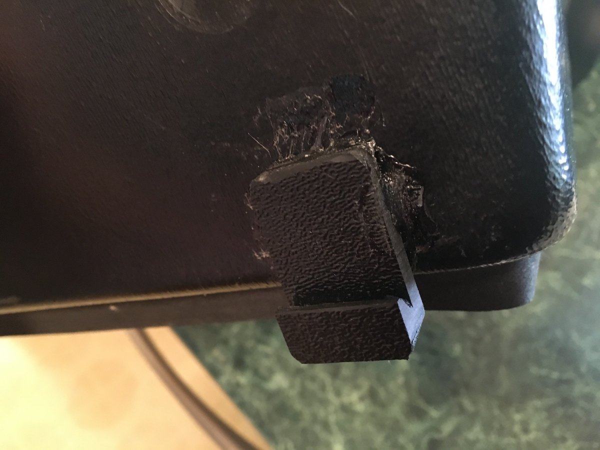

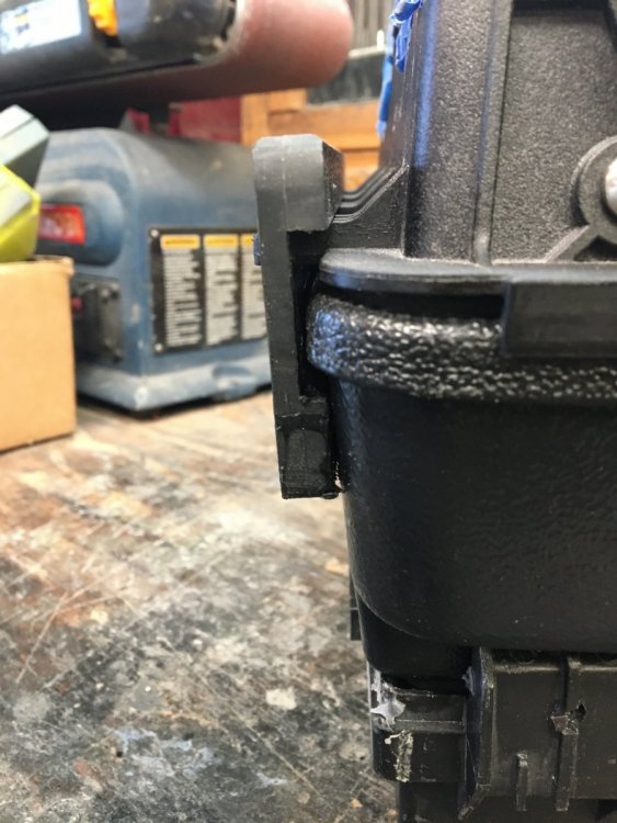

The plastic shop is also going to make a part I call the "J-Hook". The J-Hook is the part that the OEM Air Box clips onto.
This is the prototype J-Hook.
I made several versions of this attachment point before settling on the J-Hook design.
You can see a different version at the bottom of the photo that required a lot of milling.
I call it the J-Hook because of it's shape. I sure made a big mess with that glue didn't I?  :shrug: lol.
                 It is a simple yet effective design..
