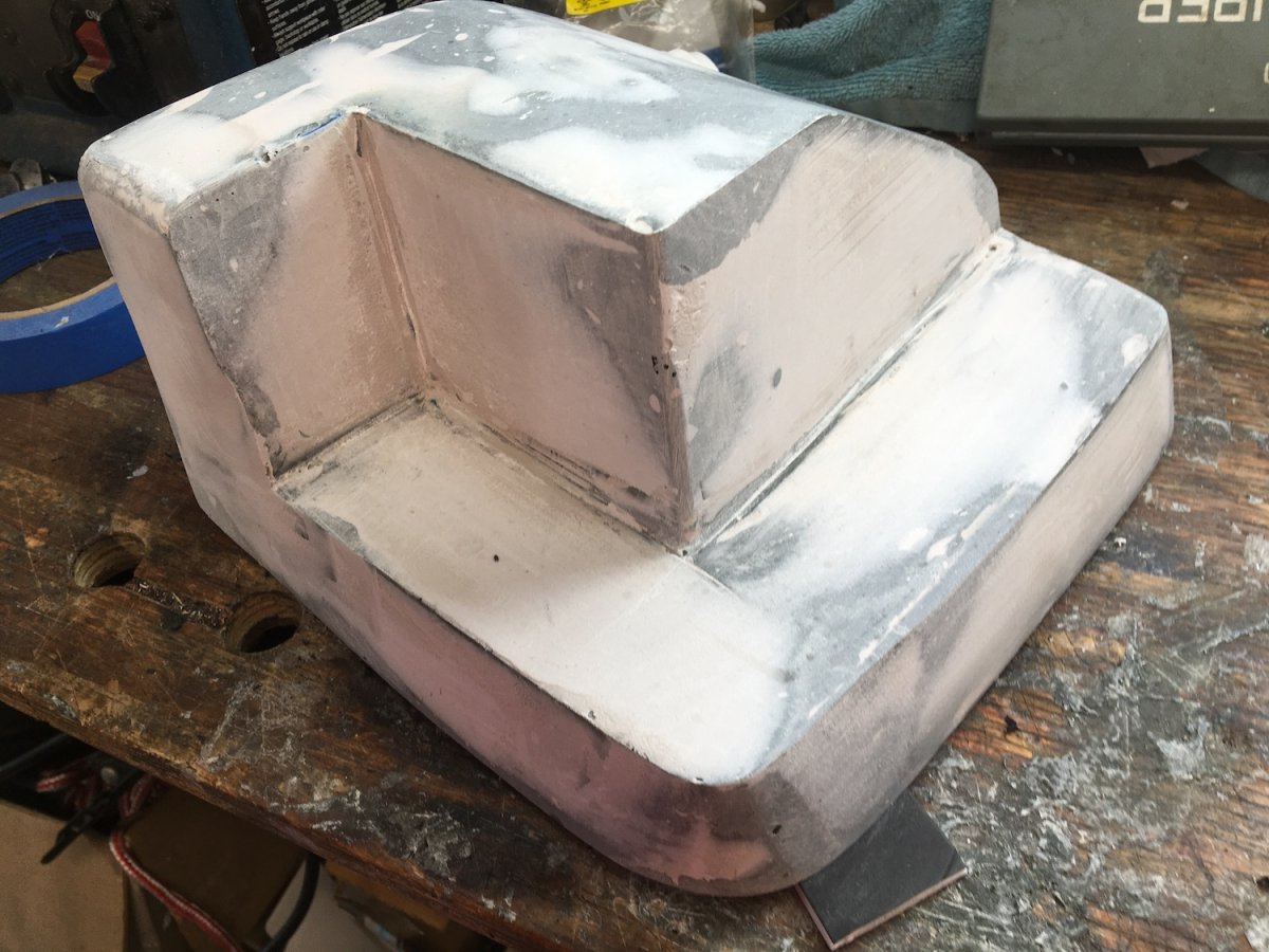

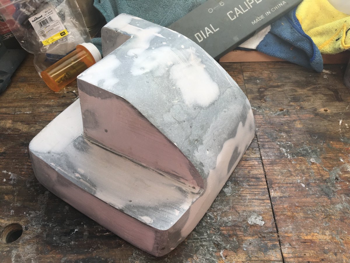

Today was a very good day. I accomplished so much. I was able to get the draft angles set and the fit fine tuned. it is ready for a finish coat and to be transformed into a vacuum form mold.

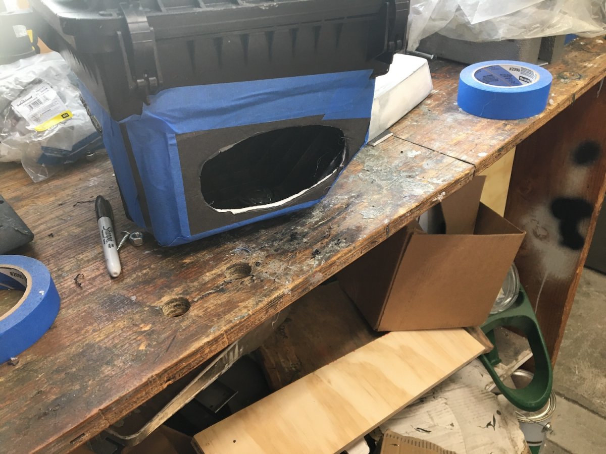

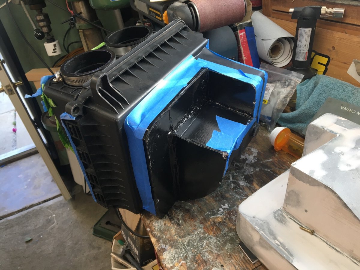

To test the fiberglass plug I shaped cardboard over it and hot glued it together to make a paper part. After spray painting I taped the replicate cardboard part into place on the air box, and tested it for fit.  I then cut some foam core to size and cut a port for the snorkel, and taped that into place on the air box as well. Now I had all the parts in place to test fit it into the car. I did not want to build it first then find out there were problems with the fit better to fix paper parts than ABS ones.
  • Like 3

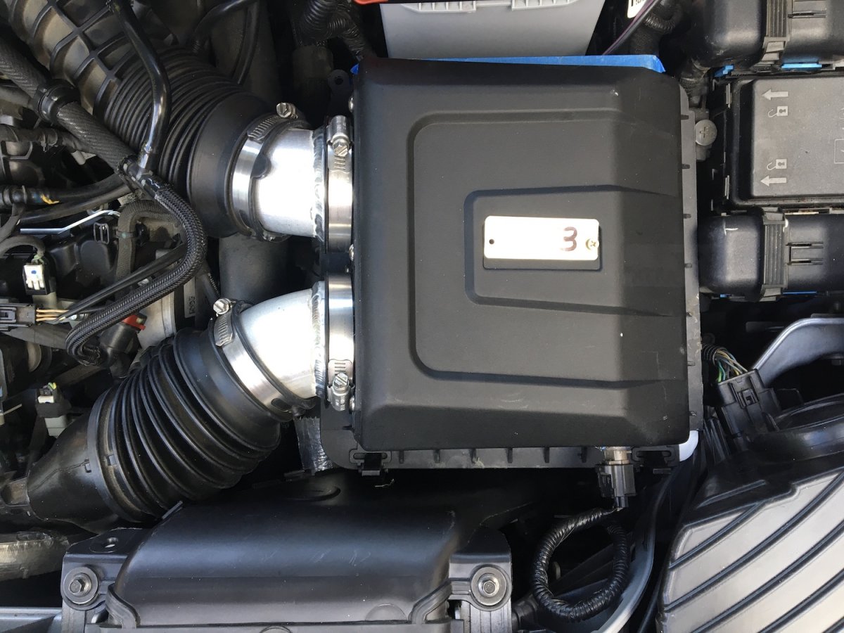

Now that all the parts were taped in place I needed to see if it would fit in the car. I decided to drill a hole for the sensor and temporally installed it as well for a full dress rehearsal.
Here you can see just how tight a fit it is as the Air Box touches the fuse box  ( I think it is  fuse box) , but it fits. You can see the sensor hook up as well in this photo.

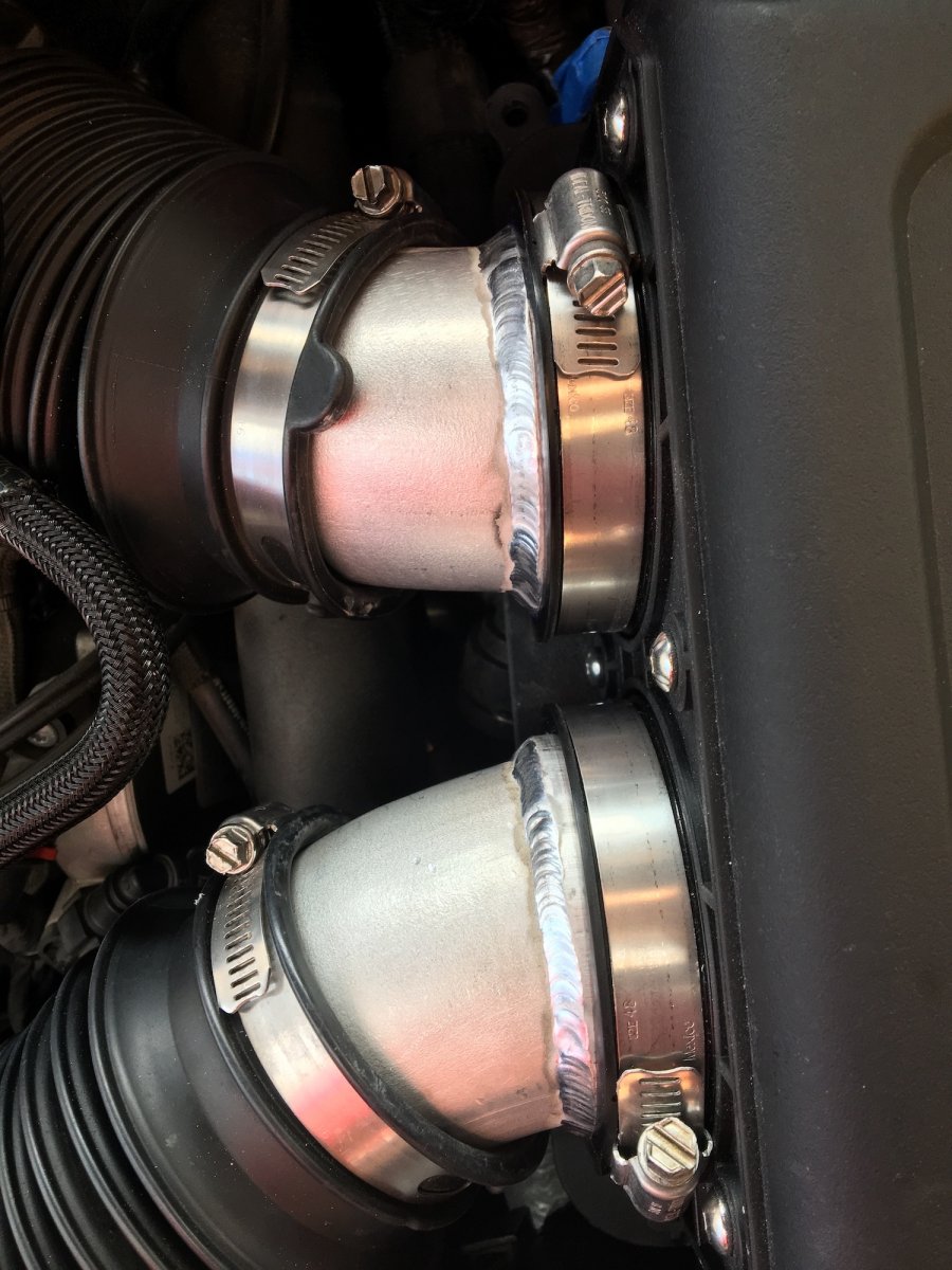

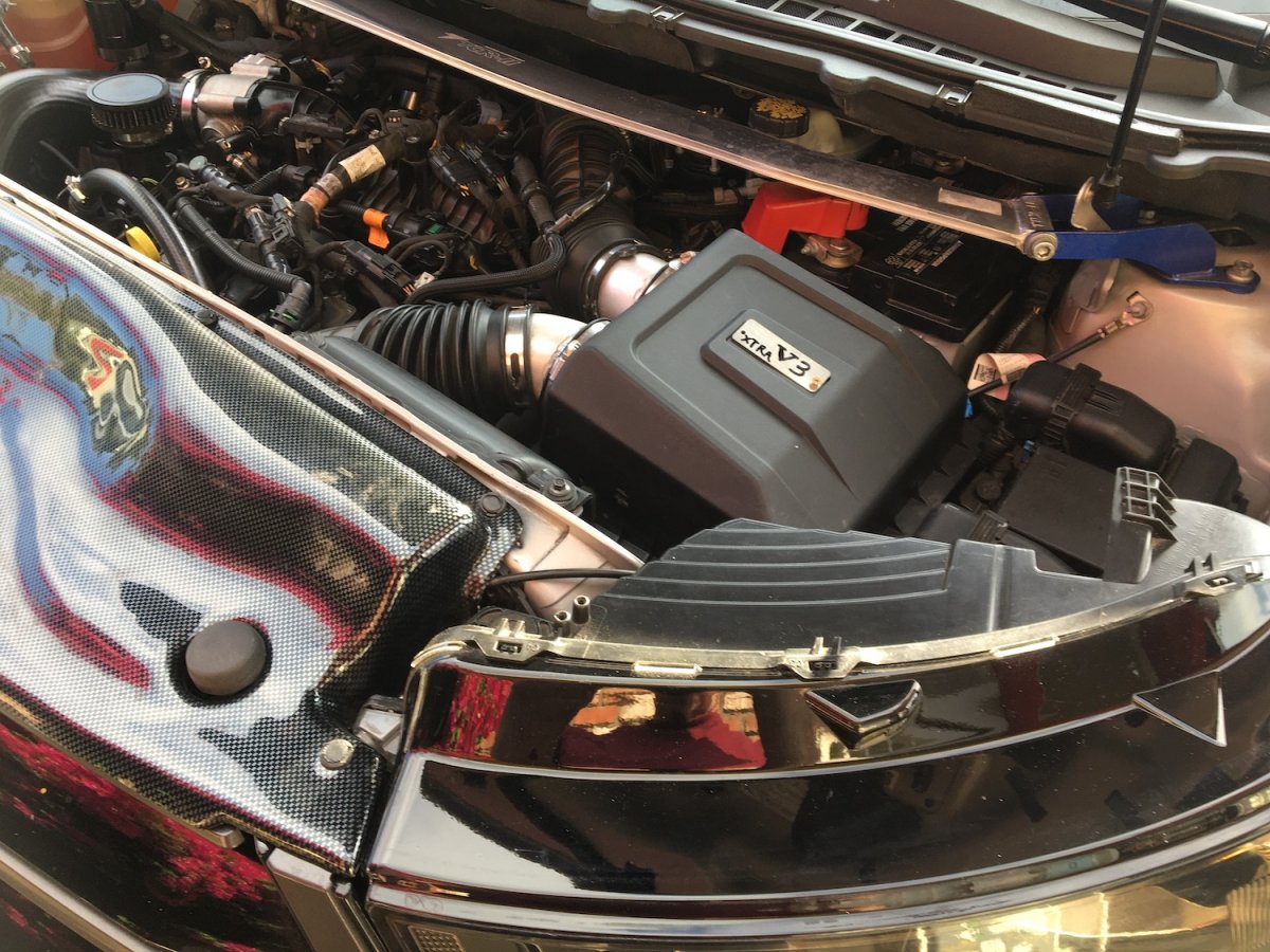

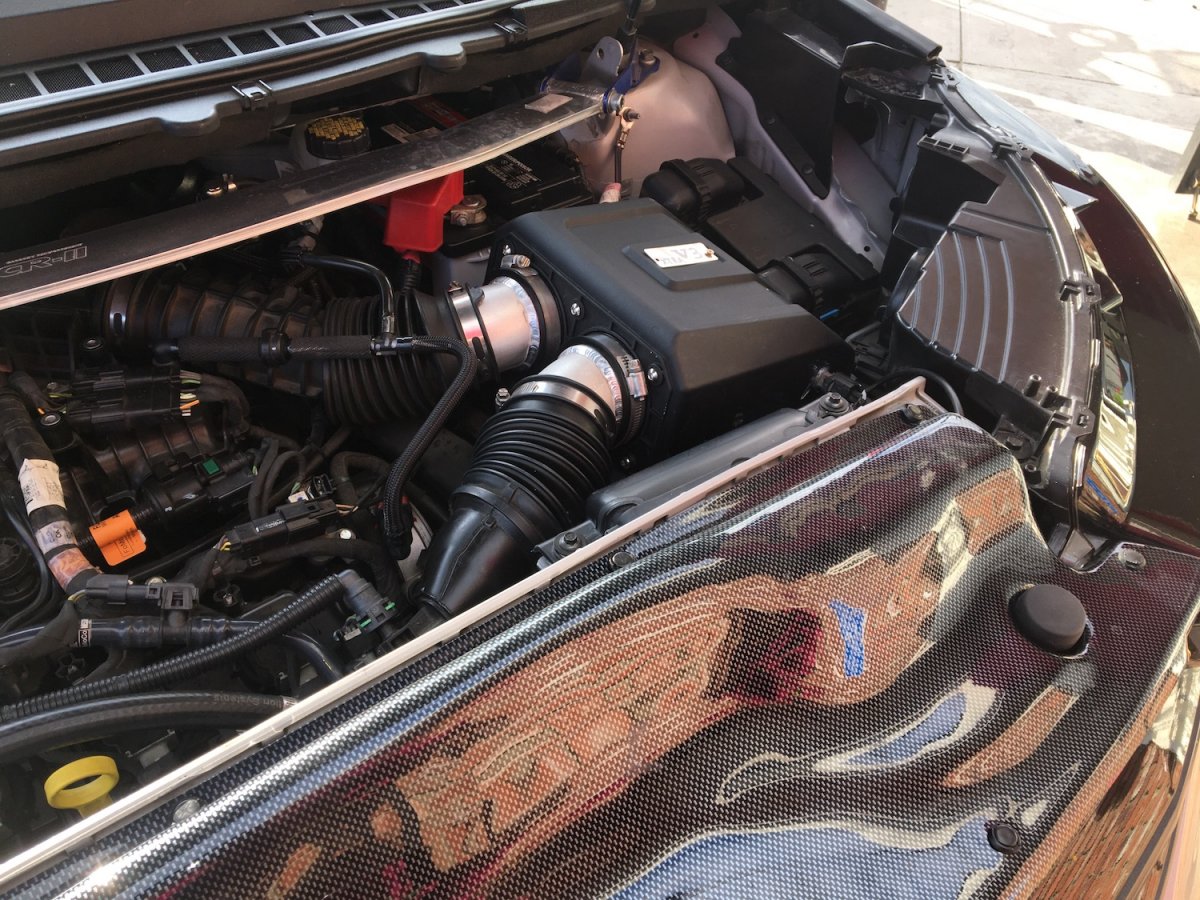

After I test fit everything and the sensor was installed I thought ... What the heck, take it for a drive. So that is exactly what I did. I started the car checked for warning lights and went for a short 5 mile drive..:) The car seemed to quiet down some and run smoother . I did not try to set a new 0 to 60 record just drove it around . After the drive I pulled the intake and checked for any problems . The cardboard and painters tape is not very strong and if there was any thing hitting rubbing or over heating it would show quickly. Everything looked great so onward.  I put a tag on the air box only for ID . I have no intention of putting a label on it when finished. Here are a couple photos of the V2 in Carbon Fiber and the V3 working together for the first time.

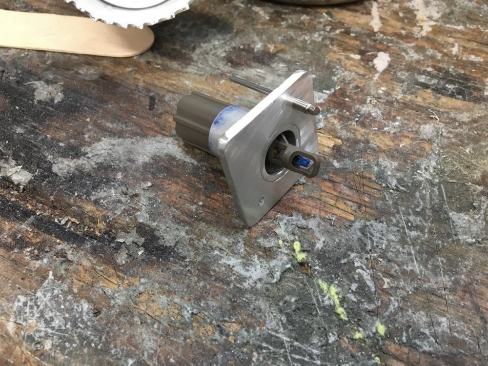

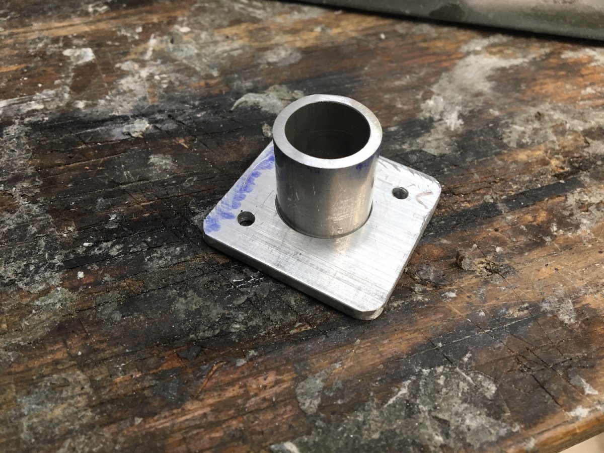

Today I worked on the sensor mount.  Unlike the elbow reducers that needed welding all the way around this part also needs welding, but just a spot or two to lock the parts together . It will be pop riveted into place with some RTV to seal things up .
So much fabrication in this project.
The sensor just slides into place and has an O-ring to hold and seal it. Two pop rivets mounts it to the air box.
