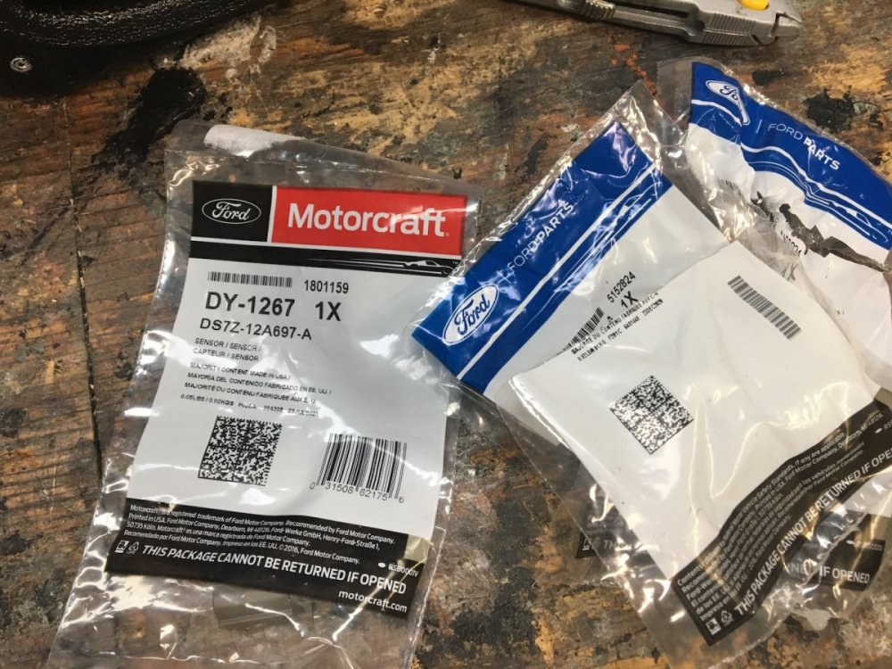

Lots of Ford parts are used to create the V3.
The lid is held in place with OEM clips, and the Air Temp Sensor is also OEM. This is the complete V3 as the original snorkel that came on your car is re-used.

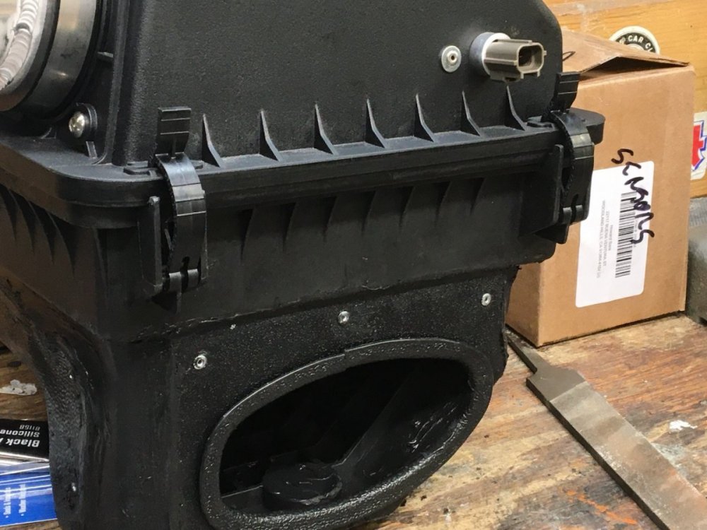

V3 with snorkel attached for test fitting. I test fit each snorkel adaptor plate several times during the build.  I do this because it is such a tight fit some people may think it does not fit at all when they try to install it themselves. When I do ship a V3 I know it will fit in the car and the snorkel will fit the V3, because I have already test fit and checked for any problems. OEM CLIPS.JPG
There is a tight fit with the one clip that is behind the snorkel.
LID CLIP :SNORKEL SPACE.JPG
Then again, everything on the V3 is a tight fit.

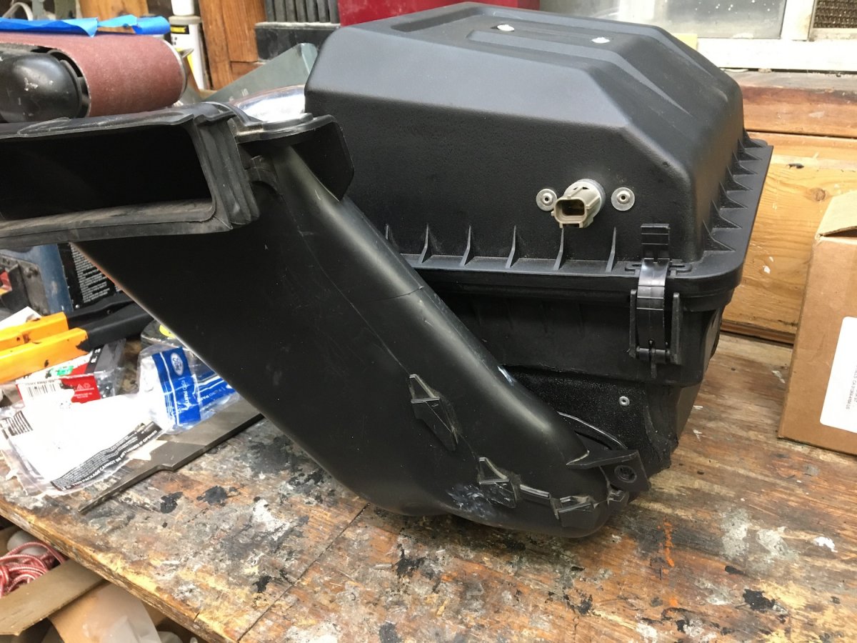

TT Steve , I have custom Comp turbos, FMIC, other mods, and a tune by Joe Granatelli, the son of Andy Granatelli and X indy racer . That may have something to do with it. You are still on the list, and I am working on an adaptor plate that I hope will work on the ST. The adaptor plate will keep the OEM bottom half of the air box and use the V3 top half.

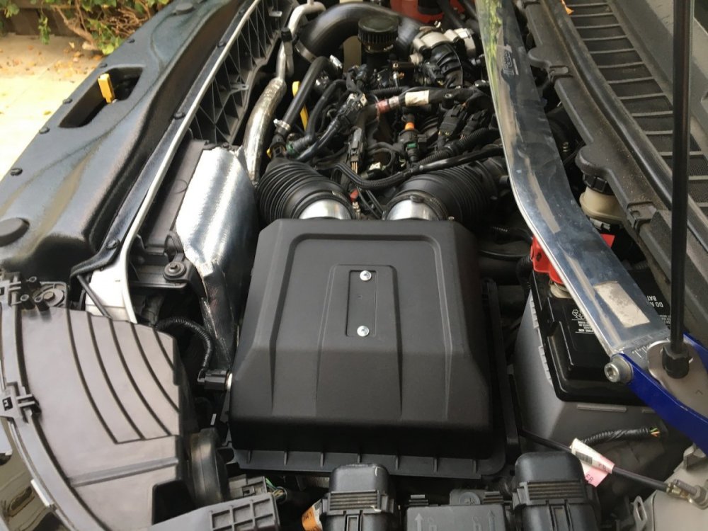

This photo shows the clearance between the battery and the V3.  The battery in this photo is H6 size it is larger than the OEM, and there is one size larger battery that can fit into the battery box.  The V3 looks like it will clear any battery that does not extend past the battery box.

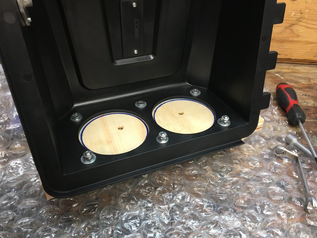

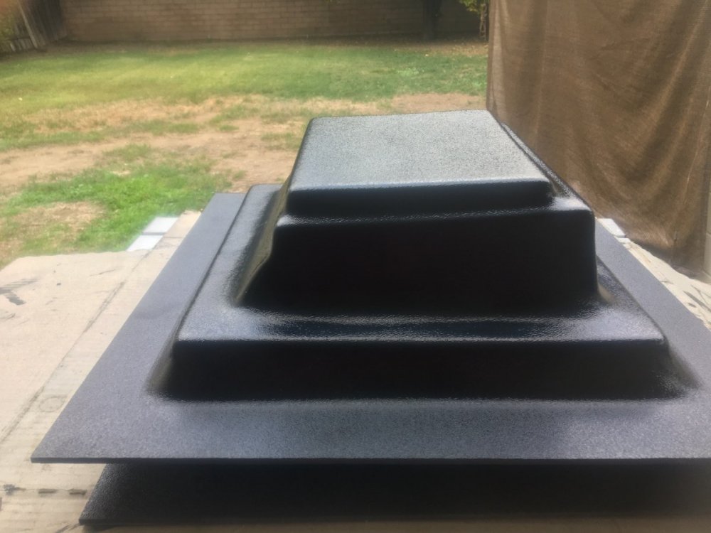

The shop made a new thicker prototype of the Adapter Plate, and it came out fairly good. You will understand when I post the photos The mold held up to the thicker material and it pulled in good at the top where I did not think it was going  to. It is because the top is the first thing the hot material touches. Then at the base after pulling down just 3 inches and one half second later it had trouble making a 90* tight turn. I think because the material had cooled off a few degrees and it became stiffer and there was not enough vacuum. Perhaps some more holes around the base will help. It still needs to be cut out and trimmed before I will know if it is going to be strong enough or if I need to go to plan “B” 😉

The new thicker Adaptor ready to be cut out.
Here you can see just how much thicker the new Adaptor Plate is compared to the first one.
Edited by Xtra

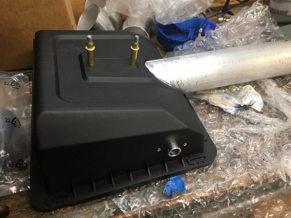

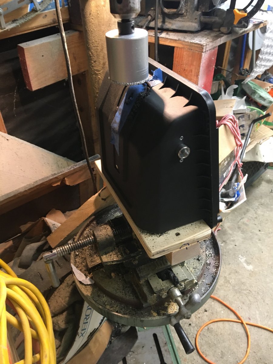

Drilled the AuxAir hole in a lid today.

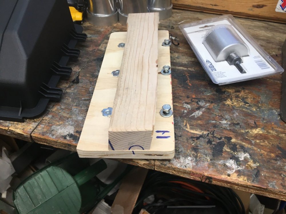

This is what I hold the lid for drilling with. The wood sticking up is what goes into the vice. Notice that the sides are not 90* , but angled. This is done to position the lid in respect to the drill that only comes straight down. If you can't move the drill, move the thing you are drilling. The bit is in the background.
Here the lid is mounted to the jig ready to go
The jig and lid assembly are clamped in the drill press cross vice.
Edited by Xtra
The jig assembly is aligned, up and down, right and left, and in and out. it is double checked then checked again .. then finally drilled.
Success a clean hole drilled.

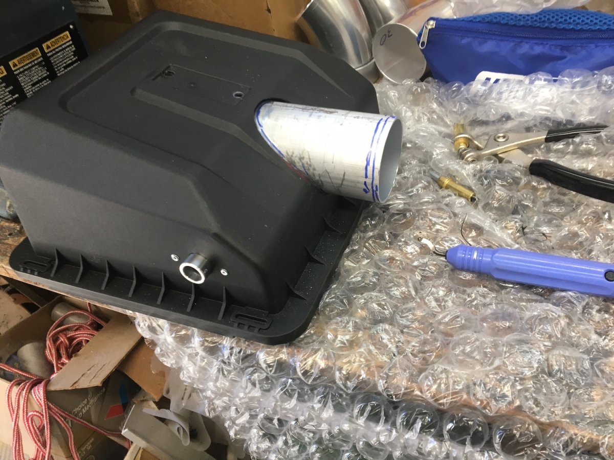

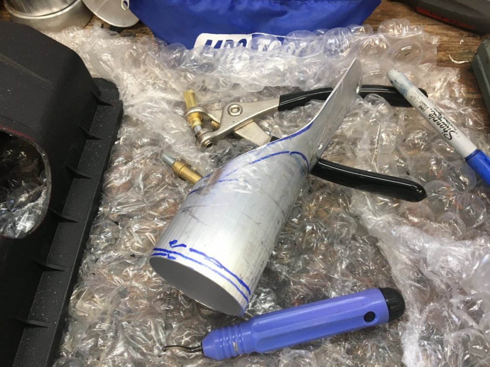

Here the tube is trimmed and fitted ready to be cut to length and riveted in place.
Edited by Xtra

The tubing is cut to shape and length, ready to be test fit.
Test fit looks good, next is to polish and rivet it into place. Because the lid is a cosmetic piece i use bubble wrap on the table for protection.
Edited by Xtra

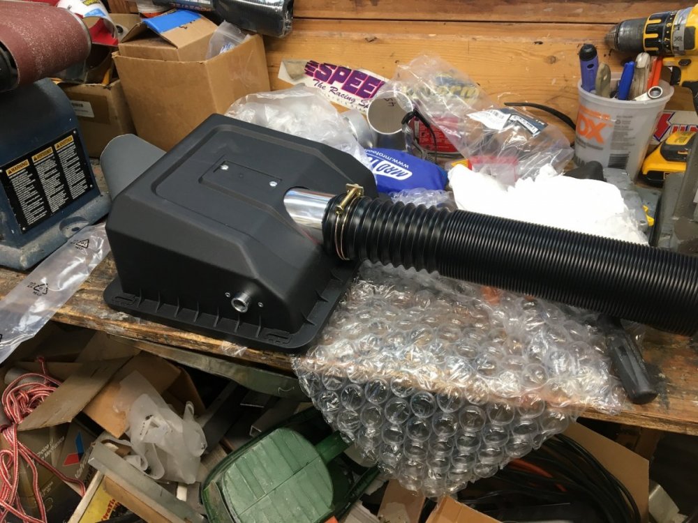

The flex hose just arrived so I did a test fit. I test fit every part to be sure that the V3 will install with no surprises. The aluminum tube still needs to be sealed with RTV before I can say the fabrication is done on the lid.
Edited by Xtra
