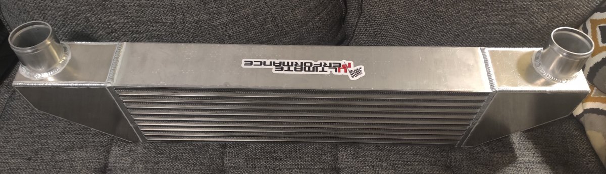

Currently Ultimate Performance is the sole provider of the FMIC. I received one that looked like a bakers apprentice made it! Called UP and Matt the owner gave me 2 choices. Refund or replacement. He said they have a new welder and asked if I could give him some time to get new cores and give them another chance.  Due to life simply getting in the way, combined with Covid I damn near forgot about it.
Dropped Matt a line and he stated the same. Refund or replacement. Nothing to talk about. Didn't give me a hard time or anything.  I'm glad that I waited. I unboxed my FMIC and was greeted with a work of art.

Ok, got the FMIC installed today. I decided to take out the entire AGS system. I now realized I made a mistake. My hood latch warning light is staying on and preventing me from using remote start. Also ambient air sensor is popping up too. Is there a way to bypass this or turn off with forscan?
On a positive note the temps have dropped to about 20° above ambient on a 0-100 pull.
