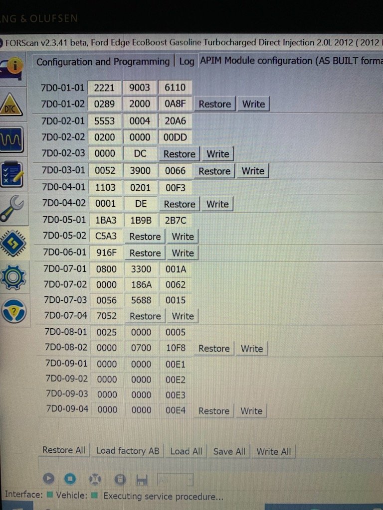

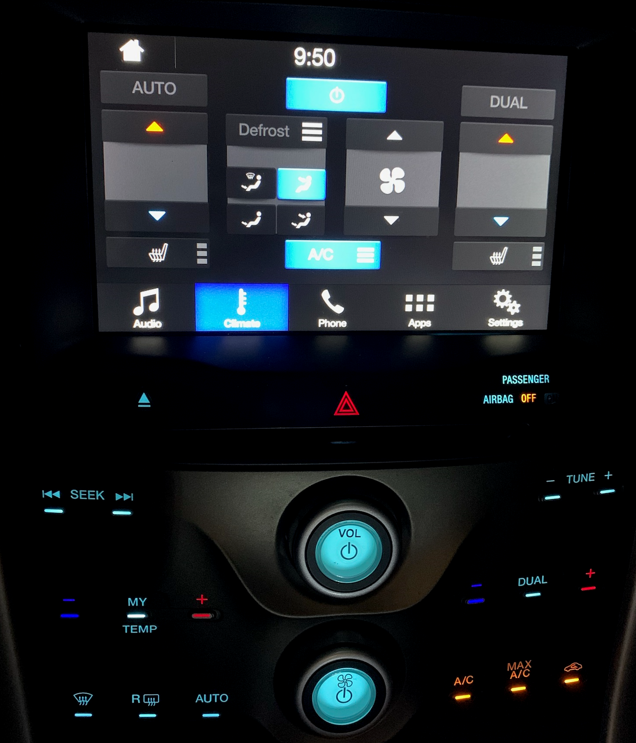

Hi..Installed new sync 3 from 2019 Edge and radio works, steering wheel buttons work, heated seats work on home screen only - not on Climate screen.  What doesn't work is anything on the Climate screen - the hard buttons work but not the touch screen, rear camera will not come on, and the worst right now, is that when I turn the car off, open the door, the radio still is on and I have to push Power/Vol button to turn off.  The AC shuts off, but not the radio.
Here is my set up and what I have so far...I had to make some changes as something was strange as for 7D0-01-02 the 2nd block of numbers had 4000 -  4=Diesel Vehicle, SWAC Not Available
Any help would be appreciated..

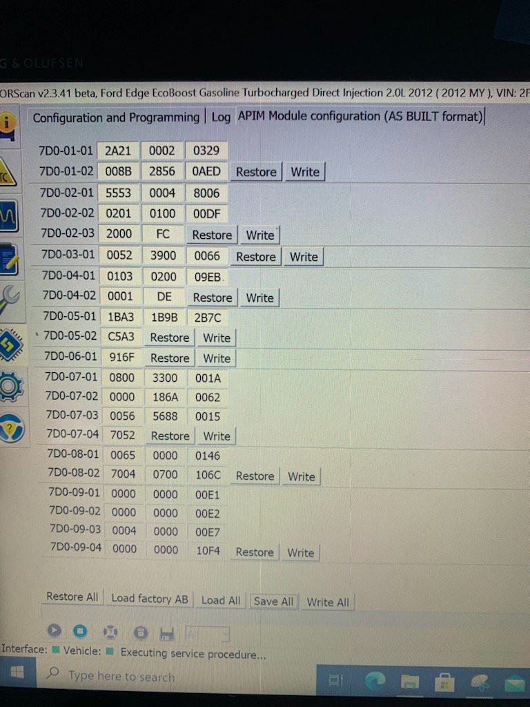

Update:  I think I have most of the codes correct, much easier seeing them in text rather than those stupid codes, but...It seems the APIM does not know that my car is ON, or running, as I have to push the power button on the radio to turn it on.  It will stay on for 30 min (as that is what it's supposed to do  - Radio without ignition switch play time.  As I'm after 30 min it will just turn off.  Also, when I turn the car off, it stays on, even after opening door.  Again, I don't think it recognizes the car is off, so I have to push the power button to turn it off.  I did NOT have this problem with the Sync 2.  Are there some codes that need tweaking, or do I have a bad APIM, or???  Any help would be appreciated...
Plowing thru other treads, and could it be the ACM?  Not sure if ACM is sending enough signal power to initialize APIM, or something is not sending signal at all to APIM or??  Not sure how to test this.  I read that ACM would need to be at a certain firmware (after 2016, mine is 2012).  I also read that since I have 2019 Sync 3, ACM is part of APIM...

As Built
APIM      7D0-01-01     2221     9000     610D
APIM      7D0-01-02     0003     4000     021F   The 4000 is strange as this means it's a diesel (I think)
APIM      7D0-02-01     5553     0004     0086
APIM      7D0-02-02     0000     0000     00DB
APIM      7D0-02-03     0000     DC
APIM      7D0-03-01     0052     3900     0066
APIM      7D0-04-01     0103     0200     00E2
APIM      7D0-04-02     0001     DE

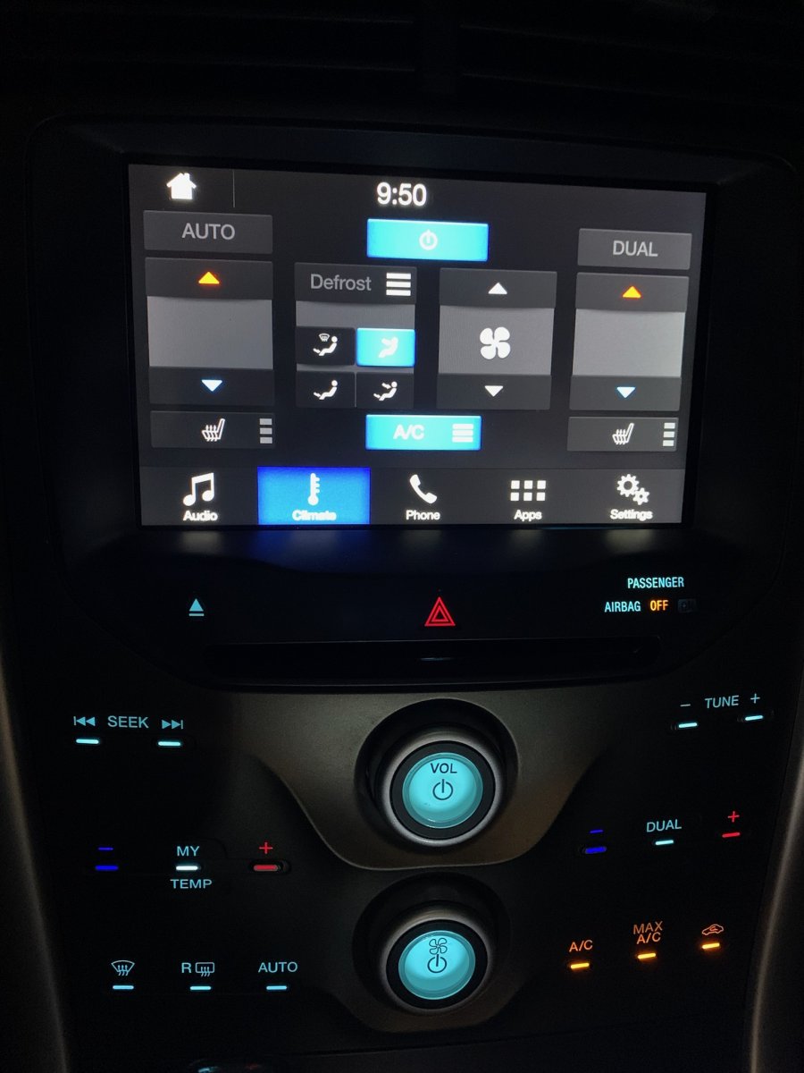

Also, this has been present from the get go after the swap (see attachment), Climate screen display is missing temperature numbers and does not work to the touch.

17 hours ago, TxBucki said:
2012 Ford Edge SEL.  Upgrade from Sync 2 to Sync 3 Version 3.3, Build 18201.  Got the Sync 3 from salvaged 2019 Edge
As Built
If this is what you are using for SYNC3, its way off.
This is as built codes I figured I'd give that a try and do hard reset.  Did not fix anything.  At the beginning, I did play around and got to this.  Same issues though.  No Power then turn car on, but have to use power button on radio, then sync comes on.  Have to turn off the same way.  Also, climate screen is there, but nothing works and no temp numbers are there.  Here is the latest APIM codes:
Sure is frustrating...
I reached out to Dan at syncprogramming and he states he believes all my issues are programming related.  Let’s find out…
Yeah those are way wrong...it has to be programmed specifically for your vehicle which it clearly is not.
If you messed with the ACM programming that needs to be changed back to what it was originally as well.
There are cheaper places to have it done too.
