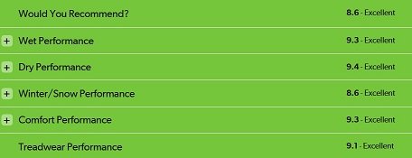

On 9/1/2021 at 1:51 PM, akirby said:
Tirerack.com survey results
