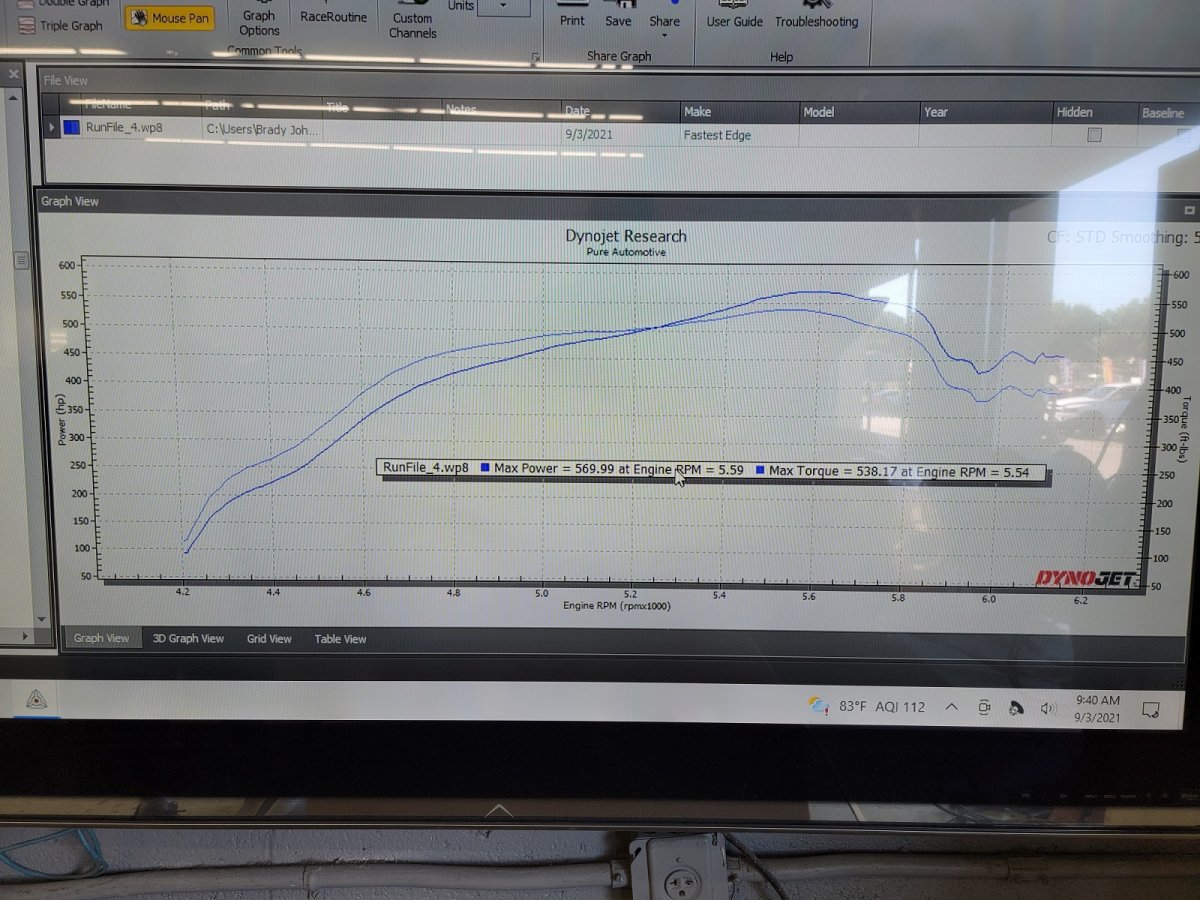

Yea you read that right, 570whp edge!  new platform record!  we ran out of fueling at 5500ish rpm (redline is 6450) and it pulled boost (25psi to 23psi).  Waiting on a new hpfp pump and injectors and we should easily see 600whp!

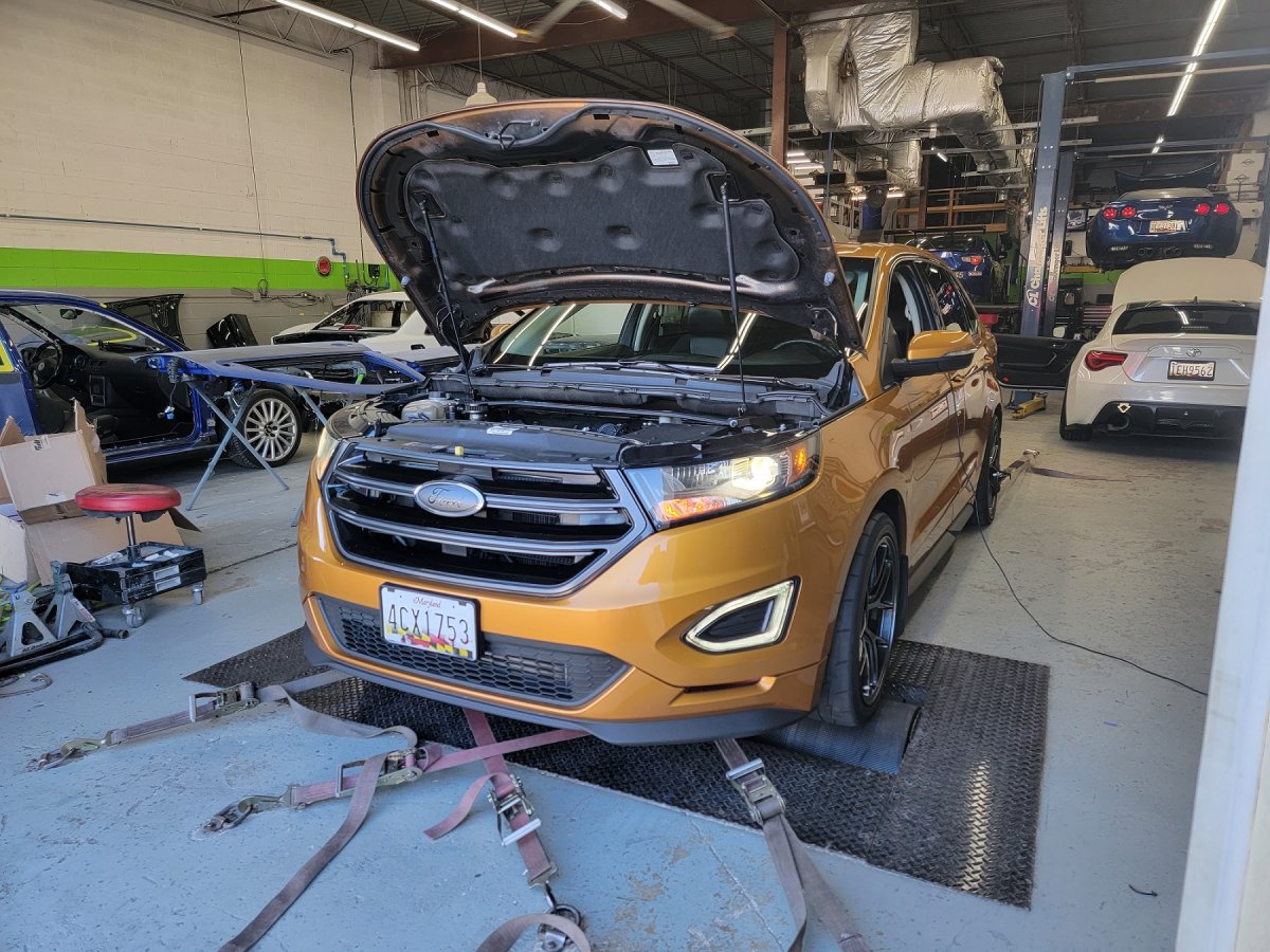

That is an amazing amount of power, congratulations, you are way over 600 hp at the crank. In fact, the stock Sport has 315HP at the crank and you have doubled that and then some B)..   I noticed that the dyno in the photo is FWD.  Did you disconnect the rear wheels some how?  Without a doubt you have the worlds fastest Edge, and I see a 11 second pass and another world record in your future.

Yea thats all they had available for right now and we wanted a benchmark just to see where we are before we figure the fuel out, so we disconnected the driveshaft.  Once we figure out the rear coupler we will be hitting up the track for sure!
