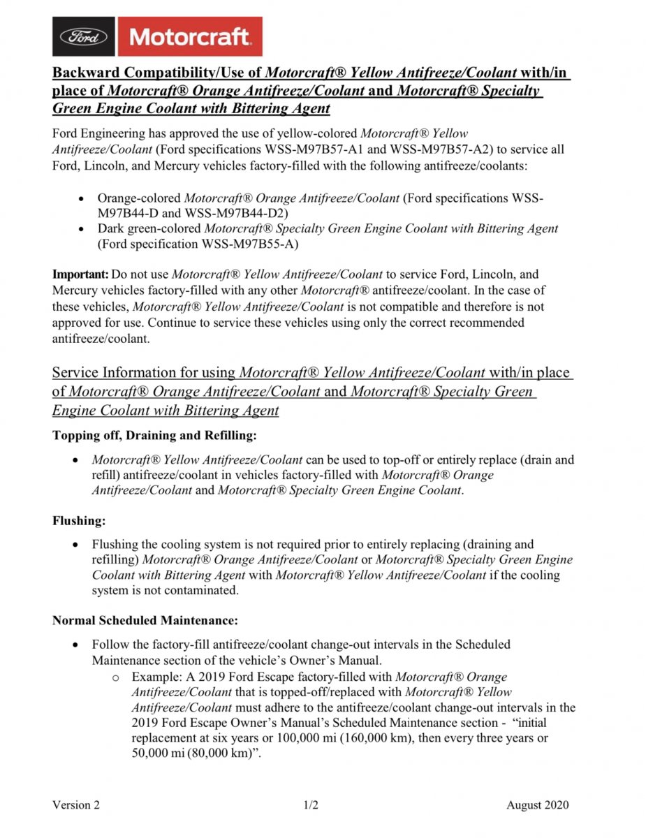

Here's the Form memo explaining it all

I don't see how Yellow is a replacement for Gold. My 2019 has it, and if I wanted I would use it in my 2012 Fusion Sport (3.5 with Orange), but not for my older vehicle that came with Gold. Plenty of Dex-cool coolants that meet the Ford spec for Orange.

gold is not the same as orange is not the same as yellow.
ford has specified yellow as being a replacement for all its predecessor coolants back to the days of gold.

If Yellow was to be used in place of Gold, that document would say so, but what it does say is specifically it does not supersede any other coolant than Orange and Specialty Green, it is not approved for replacing Gold.
