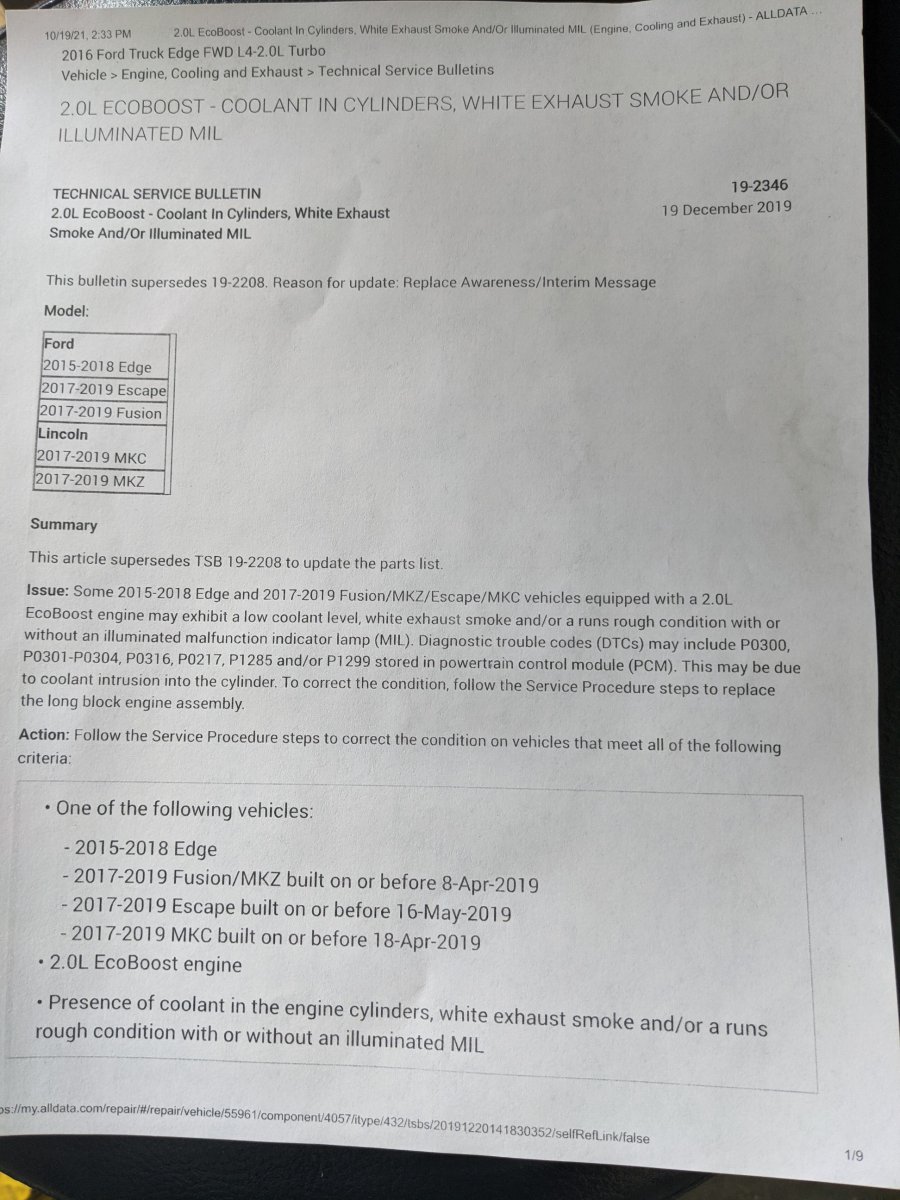

Dulce Posted October 19, 2021 Report Share Posted October 19, 2021 So I was just advised I need a whole new engine. They said water in cylinders due to possible gasket broken/cracked and it’s recommended to get a whole new engine due to cost of just replacing the gasket and having issues later requiring new engine. ? Quote Link to comment Share on other sites More sharing options...
Dulce Posted October 19, 2021 Report Share Posted October 19, 2021 10 hours ago, WWWPerfA_ZN0W said: since you have a gen 2 with a 2.0, i would make sure a coolant intrusion issue is not in progress. check coolant level regularly, should pretty much hold steady with engine off and at ambient. if the CEL ever flashes, you may be looking at a block replacement in the future. Ford has issued a TSB for this issue https://drive.google.com/file/d/1jBJQQtJ635aSGsMyyFRKCFyFNNo1KnNw/view?usp=sharing I just opened the link… going to read it. I’m so stressed. I can’t believe just 5 yrs old and it needs new engine. I kept it well maintained and just put over $400 on maintenance Quote Link to comment Share on other sites More sharing options...
WWWPerfA_ZN0W Posted October 19, 2021 Report Share Posted October 19, 2021 sorry amigo. this has been bad news for many many members on our FB pages as well Ford corporate to date has helped cover some/most of the bill in some cases tho, when the mileage is reasonable. I would apply to them for assistance, the dealer may provide support in this regard, ask them. The numbers (%ages) may not support it, but we would like to see at least a Customer Satisfaction Program bulletin issued on it. Quote Link to comment Share on other sites More sharing options...

1004ron Posted October 20, 2021 Report Share Posted October 20, 2021 My work associate had his replaced by a good indy shop, who bought the new long block from Ford and it came to around $4,500 for the whole job, with no help from Ford. I suggest that we merge this with the existing thread on the issue. 1 1 Quote Link to comment Share on other sites More sharing options...
