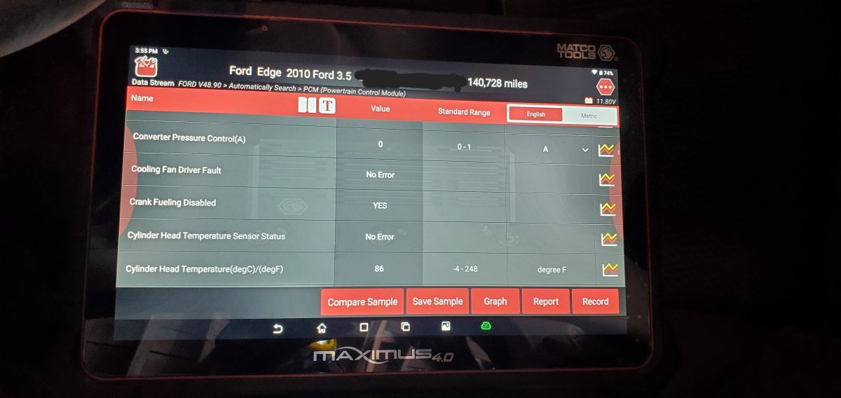

Ahh gotcha thanks for the info I'm not too familiar with ford's, and we have it narrowed down the fuel sender had a open circuit I fixed that and we are wondering if it's the inertia switch now I'll add a picture of what our scanner shows, we have no codes at all on the system which is the weird part, but what I have shown in the picture is what is confusing us now, because I just went and checked every ground, connecter and wire and its all good, fuel pump is good and getting 60psi but the pcm is not firing the injectors for some reason, fuses and relays are also good

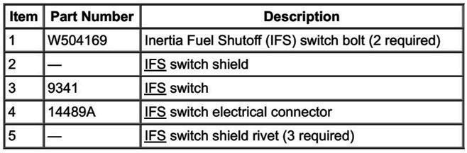

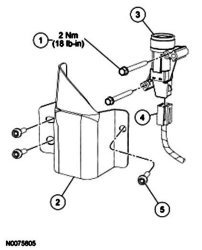

Here isĀ wiring diagram and the IFS switch connector detail.
Ā
If you've not ruled out IFS involvement, is itĀ possible to verify switch-state by checking across switch's pins 1 & 2, and/or jumper 1 to 2 on harness connector if the switch is determined to be in the interrupted state?
Ā
732511874_2010EdgeWiringDiagramShowingInertiaFuelSwitchCircuit.thumb.jpg.f003b464eba0606d48ca59dcefd8cdbe.jpg
Ā
1897139873_InertiaFuelShutoff(IFS)SwitchConnectorC4168Details-2010EdgeWorkshopManual.jpg.67b4a9022c134e4efd5cb738b8fd5fd7.jpg
