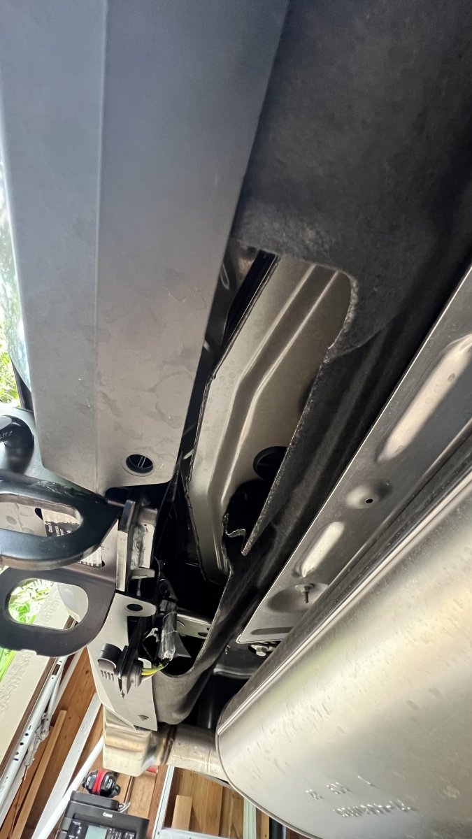

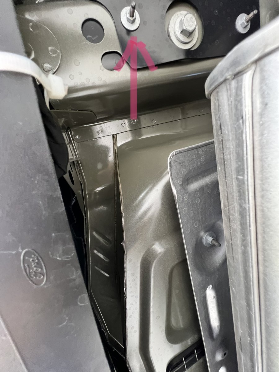

Kclonn Posted July 20, 2022 Author Report Share Posted July 20, 2022 Ok. The part arrived. Super easy install. Took me about 20 minutes including rounding up some parts. This did not come with screws so I ran to the auto parts store and got some #8 screws with washers. Be aware that the washers need to be bigger than the ones that came on the screws I bought, so be prepared for that. This is where the ends of the bracket attach. Remove nut on both ends. Now you just slide the front of the shield over the muffler and lift the floppy bumper enough to slide it in place on top of the bumper so the holes align. The tabs on the end of the shield go on the studs where you removed the nuts so screw those back on as seen below. Now just screw in the 4 screws you got and that is it. Simple. I am going to go back and look at the drawings because there is still a gap in the center that I don’t like. If I can’t find a part, I will make something. I don’t want sand and dirt collecting in there. The gap looks larger than it is because of the wide angle on the phone. It’s still too big for my taste. At least the bumper is no longer loose. 1 1 Quote Link to comment Share on other sites More sharing options...

Davidoo Posted July 21, 2022 Report Share Posted July 21, 2022 (edited) I have the rear bumper part and the hood insulator on order. Should both be in Friday. So, for the rear bumper part, you didn't have to take anything off to put this on? When you say you had to round up some screws, were they for the 4 attach points to the rear bumper cover at the bottom? It looks like for the two upper forward sides, you just took the nut off of the screw sticking out that was already there, put the new part on and tightened it down. Is that correct? Also, what do the 4 screws you bought for the bottom 4 holes on the bumper cover go into? When I look at mine they are just 4 holes and it looks like the new part slides in-between a small plastic bracket on the inside edge of the bumper cover above the holes. Are these threaded so the screws just go in, or did you have to buy washers and nuts to put on top of the screws as they come upwards through the bumper cover. Maybe you could send a picture of that that cross section with the screws going up looks like? Edited July 21, 2022 by Davidoo 1 Quote Link to comment Share on other sites More sharing options...
Kclonn Posted July 21, 2022 Author Report Share Posted July 21, 2022 Davidoo - There is no need to remove anything except those nuts (10mm) I showed in my post, and those go right back on. This just slides in. Make sure that you get the forward lip of it above the heat shield on top of the muffler and the end tabs go on those screws that I took pictures of in my post. The new shield has the clip on threaded adapters for the screws so no need for nuts on top. The rear (rear being to the back of the car) of the shield goes over the bumper cover and the screws go through the bumper into those clips. I bought #8 screws but I probably could have used #10 as mine were very tight. The holes in the bumper are too big for most screws so you need washers large enough to cover the hole. You may want to measure the hole before you go buy unless you have a good supply on hand. Once you put this in, you can't see a cross section without taking the thing out and I'm not going to do that. The only question I have is that there is a hole in the top front of the new shield that does not meet up with anything. I'm not sure if I have to drill a hole into the pan under the spare tire and bolt that through or what. And there is still a foot long gap in the new shield that I would like covered. Maybe I'm too picky. If anyone with the factory trailer hitch before they left this part off could look at theirs and see if this gap is there I would love to know. Good Luck - it's easy. Quote Link to comment Share on other sites More sharing options...
Davidoo Posted July 22, 2022 Report Share Posted July 22, 2022 Thanks Kclonn. I'm sure I'll be able to do it. I noticed on the bottom of my bumper cover where the 4 holes are (2 on each side of the hitch) on the inside top of the bumper cover there appear to be some type of built in clips on top of each hole. My vision isn't good enough to tell if they are threaded. Did yours have those, and if so, did you slide the new deflector in between those so it is sandwiched between the bumper cover bottom and those additional clips? I too would like to see a photo from someone with an earlier 2021 that had this part on. I suspect that Ford may have just used the push in black fasteners that have a wide collar on the top so it wouldn't need a washer. Those clips hold lots of parts of the car together and might work as well. Thanks again. Quote Link to comment Share on other sites More sharing options...
Kclonn Posted July 22, 2022 Author Report Share Posted July 22, 2022 Davidoo - yes, I saw those tabs but don’t know what they are for. They aren’t needed for this. I just put the shield between them. The holes should line up with the metal clips showing through. 1 Quote Link to comment Share on other sites More sharing options...

Kclonn Posted July 31, 2022 Author Report Share Posted July 31, 2022 Davidoo - Do you have a large area around the hitch that is left open? Just wondering if I need something more or that’s it. Quote Link to comment Share on other sites More sharing options...
Davidoo Posted July 31, 2022 Report Share Posted July 31, 2022 Yes, the gap near the hitch is the same as what you shared in your photo. Maybe they have to leave that area more open around the hitch because of the chains that hook up near there? Quote Link to comment Share on other sites More sharing options...
