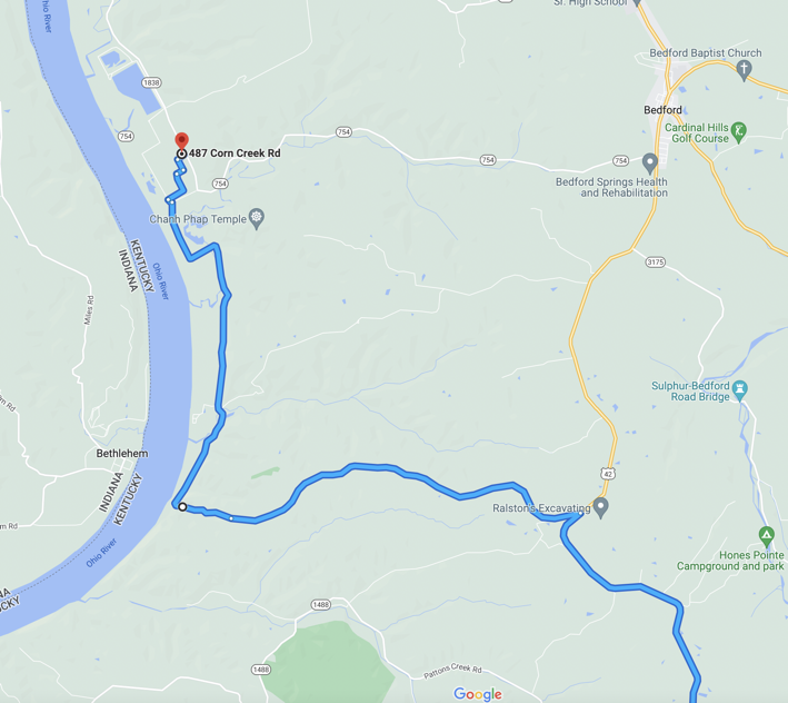

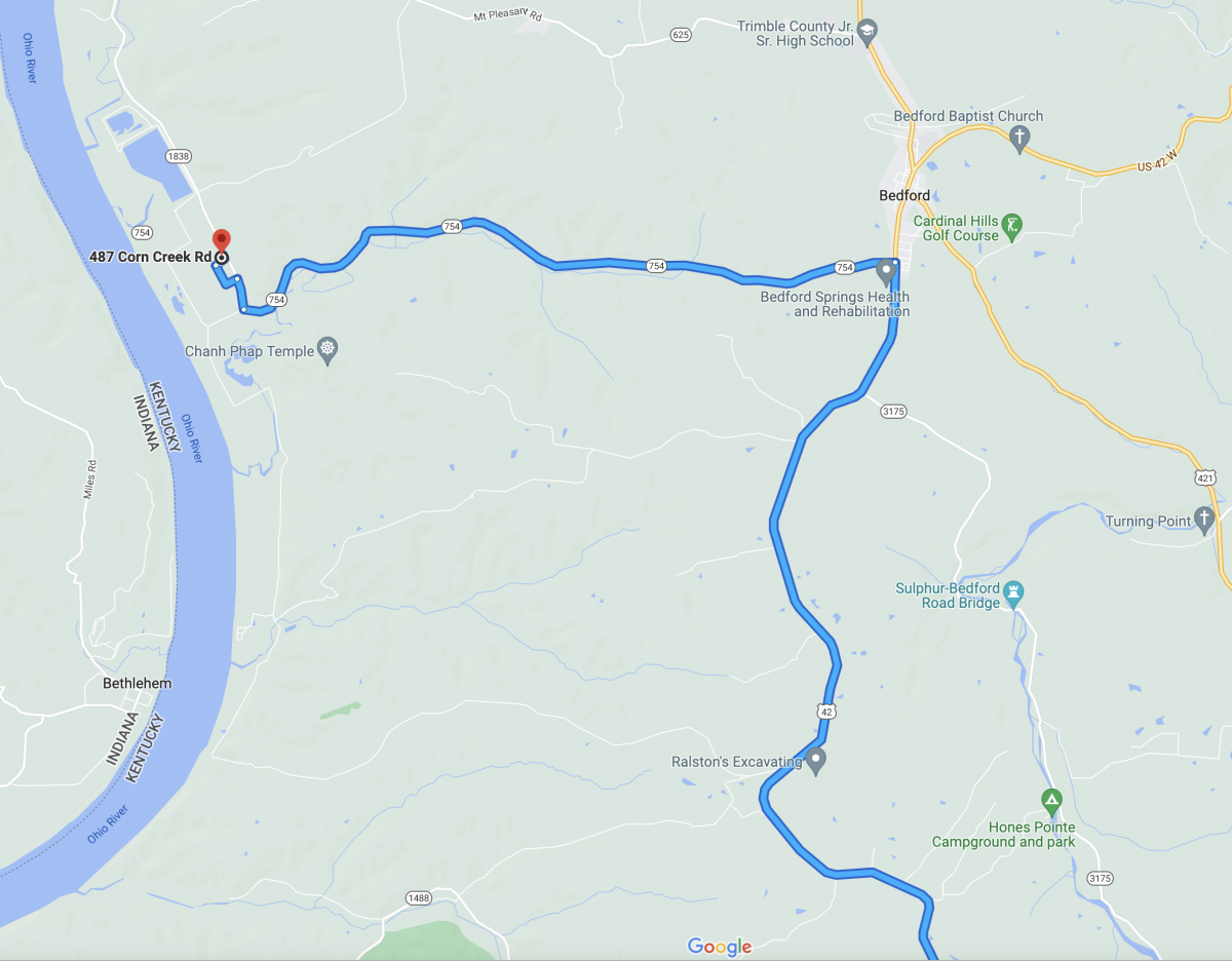

1004ron Report post Posted July 12 (edited) The original map version in my 2017 Sport was reliable, but didn't have the roads in my subdivision - I updated the maps and it screwed the routing. If I hit "work" to takes me on a route that has very poor quality narrow roads and adds significant time to my commute. Also, the 5 year SiriusXM Traffic expired, so no more auto-routing and alerts. Now if I need navigation, particularly routes that are unfamiliar, I use CarPlay with Google Maps or Waze - Waze seems more accurate with traffic alerts and re-routing. I might try another map update, but until then I have zero confidence in the routing. BTW, what model do you have - please add that to your signature - www.fordegeforum.com/settings/signature Edited July 12 by 1004ron Share this post Link to post Share on other sites

1004ron Report post Posted July 13 8 hours ago, enigma-2 said: Also check your settings. It's possible to change the route servings to not consider certain roads, such as do not take freeways, and the like. If it's not even seeing the freeway on the map, try updating the maps in the car's navigation. When I first encountered the wayward routing after the last map update I searched for this option which is typical on standalone GPS units, but couldn't find anything like that, so would welcome any pointers. It still leaves me with a lack of confidence setting a route in an area that I'm unfamiliar with, and no traffic alerts. Share this post Link to post Share on other sites

1004ron Report post Posted July 18 (edited) On 7/13/2022 at 6:52 AM, 1004ron said: When I first encountered the wayward routing after the last map update I searched for this option which is typical on standalone GPS units, but couldn't find anything like that, so would welcome any pointers. It still leaves me with a lack of confidence setting a route in an area that I'm unfamiliar with, and no traffic alerts. On 7/13/2022 at 9:26 PM, enigma-2 said: >Settings >Navigation >Route preferences >Avoid freeways ...or, >Always use route ...or, ~There was a waypoint set Nope, that didn't help. About 15 to 20 miles from work it takes me on a very narrow single car width road which is much slower. I deselected "Always Use Route" and that presents three routes to your destination and all three chose this unsuitable narrow road. This leaves me with a total lack of confidence when selecting a route to a destination that I'm unfamiliar with if it screw up my basic work commute. This is the route that the Sync3 used prior to the map update, and Garmin uses: This is the route the updated Sync3 uses regardless of settings: Single car width poorly maintained road running alongside the Ohio River: Edited July 18 by 1004ron Share this post Link to post Share on other sites

pintokid Report post Posted July 19 15 hours ago, 1004ron said: About 15 to 20 miles from work it takes me on a very narrow single car width road which is much slower. You say this started after a map update? Apparently the new maps think Wises Rd. is a better road than it actually is. I think you should complain, but good luck with that. Last time I tried, all the support reps could agree on was that none of them could help. Share this post Link to post Share on other sites
1004ron Report post Posted July 19 38 minutes ago, pintokid said: You say this started after a map update? Apparently the new maps think Wises Rd. is a better road than it actually is. I think you should complain, but good luck with that. Last time I tried, all the support reps could agree on was that none of them could help. Yes, definitely the map update from NA 1-18 to NA 2-20 screwed the routing. The original NA 1-18 didn't have my subdivision, which was developed around 2015, but at least it would use appropriate roads which was useful at in the first 5 years of ownership while I still had the free Sirius Traffic. Share this post Link to post Share on other sites

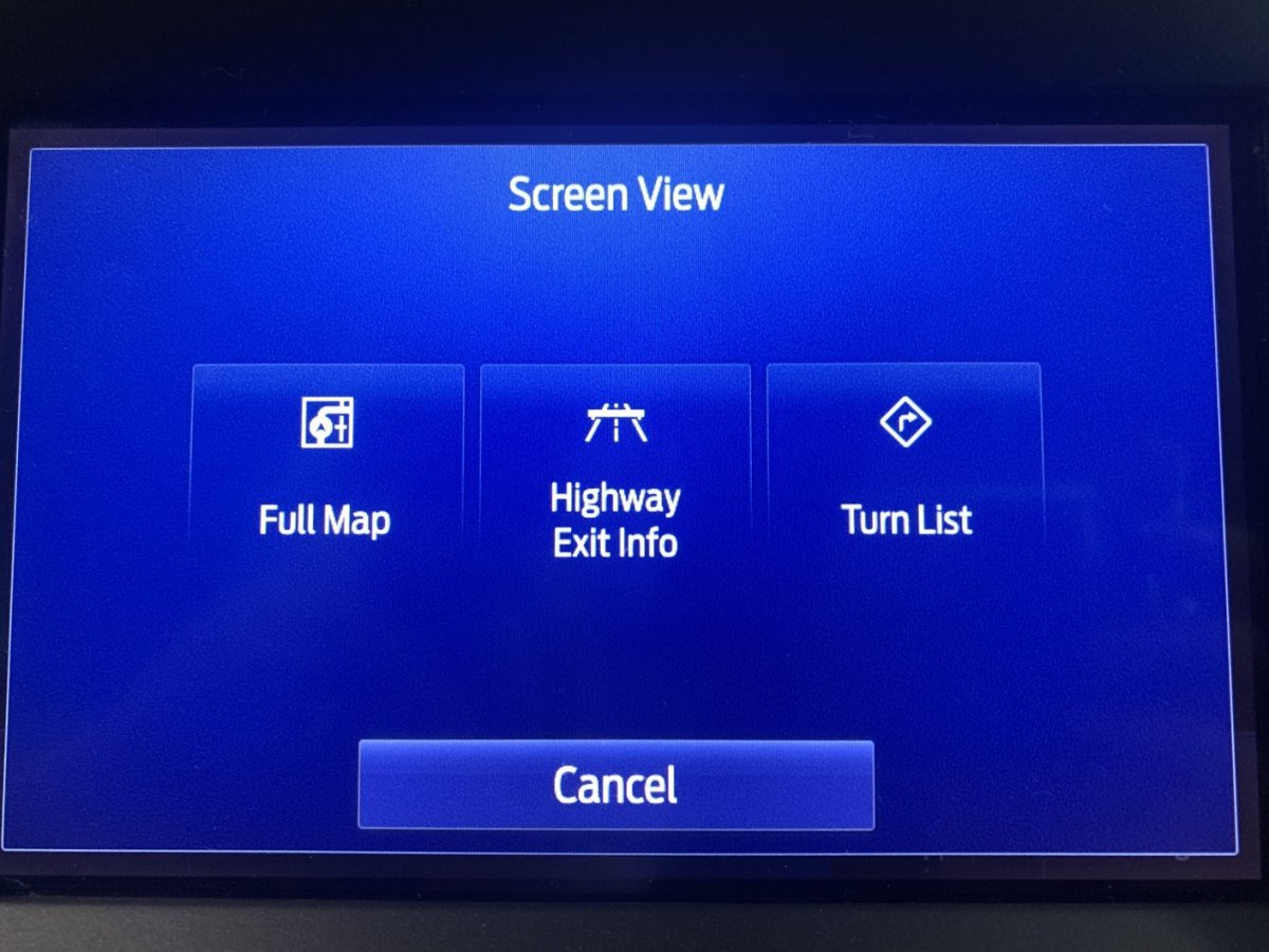

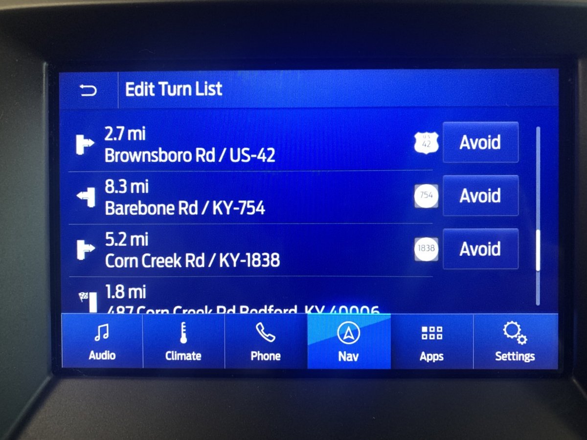

1004ron Report post Posted July 23 (edited) The latest Map version comes with a feature that the previous ones didn't have - In Screen View you can select to display Turn List, and then chose the roads to avoid. BUT, unfortunately its not smart enough to remember the "Avoided" roads the next time you select the same destination. Edited July 23 by 1004ron Share this post Link to post Share on other sites
