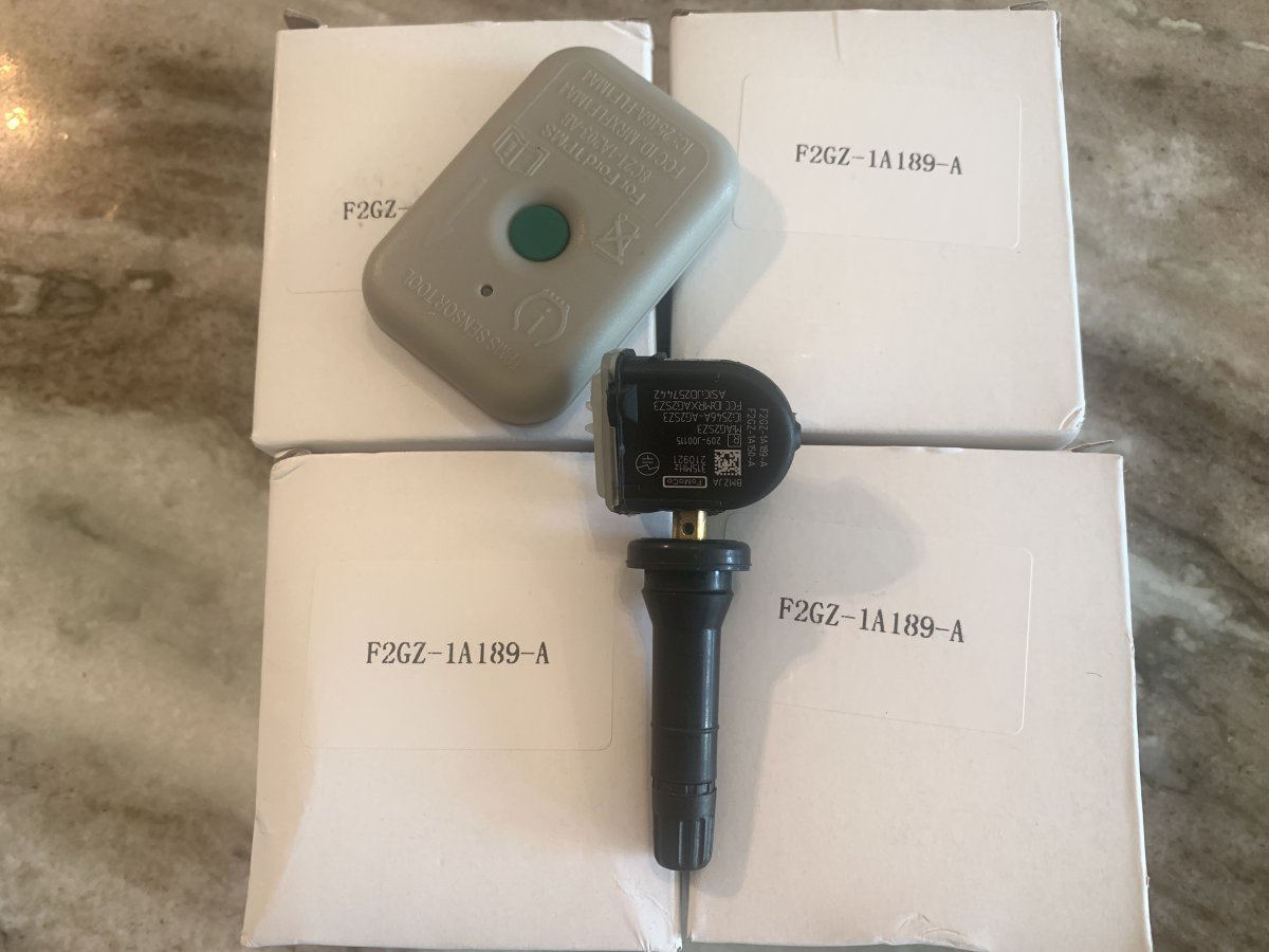

I bought two sensors for my BMW motorcycle and a set of four for my 2017 Sport from Aliexpress.
The ones for the BMW are Schrader and been in service for more than a year, and the four in my Sport have been in service for 3.5 months - no issues.
BMW sells the TPMS sensors for $250 each and I paid $10 each.
The ones you bought from a local retailer most likely came from the same factory in China as the ones I bought.
My "Made in China" iPhone is still going strong.
