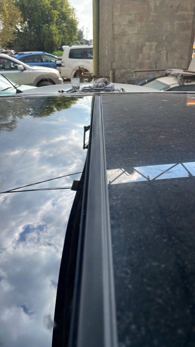

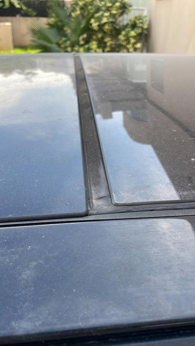

Sunroof weather strip between fixed glass and sliding one
hello,
Did anyone replaced the weatherstrip as diy job?
Without removing the rear fixed glass....

the weather strip is cosmetic only. Even if removed, water will not leak…
I already bought the part, cost me 112$.
the thing is, the weather strip attached with double sided glue to the fixed rear glass, and the gap is tight.
I went to glazier that told me he will have to remove the fixed glass to fix it. And it will be around 800$.
so if anyone done the repair by himself, without removing the fixed glass ( removing the sliding one takes 5 min ), would appreciate some tips and tricks

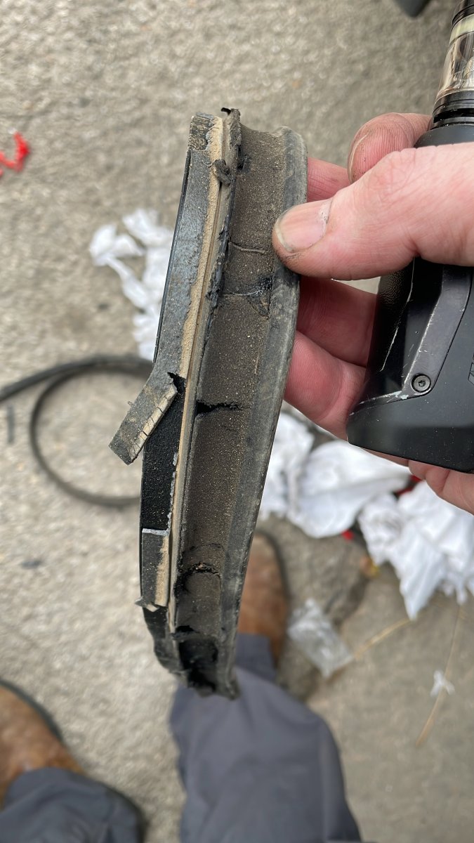

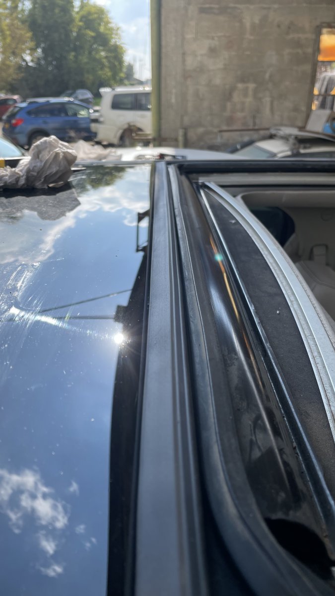

2284A51C-6C67-461E-8C17-3FEF52B6FA56.thumb.jpeg.b733c02d97c9f4bc98bb7ebb5b0605fa.jpegFC8443DF-2AB8-411A-82FD-D3C8847AD042.thumb.jpeg.ae53b0f28df5e3418ca99d1efd70e522.jpegOk, job is done.
Uninstalled the front sunroof glass.
Removed the old weatherstrip
Cleaned the glass from underneath with short blade and wiped with alcohol .
I checked that the surface is cleaned and dried.
Than, placed the new weather strip from underneath the glass and tightened it.
To finish the job, cleaned the rails and used silicone grease generously
