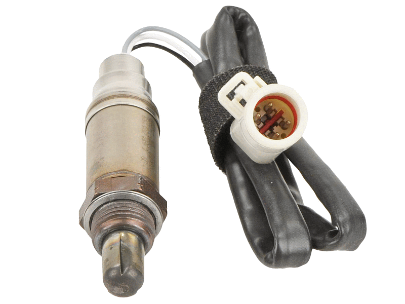

I know for the 2007~2010 Ford Edge\MKX, there are 4 NarrowBand OxSensors, each has a different length 4wire cable,
but the Sensors & the 4pin connectors are all the same & interchangable,
so a Bosch 15719 with the long 24i00 0m610 Cable+Plug is good to replace any of those 4 NarrowBand Sensors
 just use black ZipTies to secure\coil & route the Cable away from Hot\Moving parts.
Of course Ford has different chaotic part numbers for each CarModel + specific sensor & dealerships will gladly sell them at jacked up prices.
Just buy\order equivalent Bosch (FactoryOE supplier) new sensors for the best price you can find.
Yep, these OxSensors do wear out & need to be renewed every 100kMiles\12years
along with Iginition Plugs+Wires, to maintain engine performance & MPGs.

Your 3.5L has a total of four 4Wire NarrowBand OxSensors:
* 2 UpStream, 1 mounted in the top of each ExhaustManifold
+ 2 DnStream, 1 mounted in the side of each CatalyticConvertor.
Al four are operationally the same with the same 4pinConnectors & pinouts;
only difference is FactoryOE sensors have different cable lengths, otherwise they are interchangable.
Again a Bosch 15719 with the long 24i00 0m610 Cable+Plug is good to replace any of those 4 NarrowBand Sensors.
The 2 UpStream OxSensors are used by the PCM\Computer to determine Fuel+Air mix.
The 2 DnStream OxSensor are used by the PCM\Computer to monitor the 2 CatCons, these don't effect the fuel+air ratio, but are required by EPA & most states.

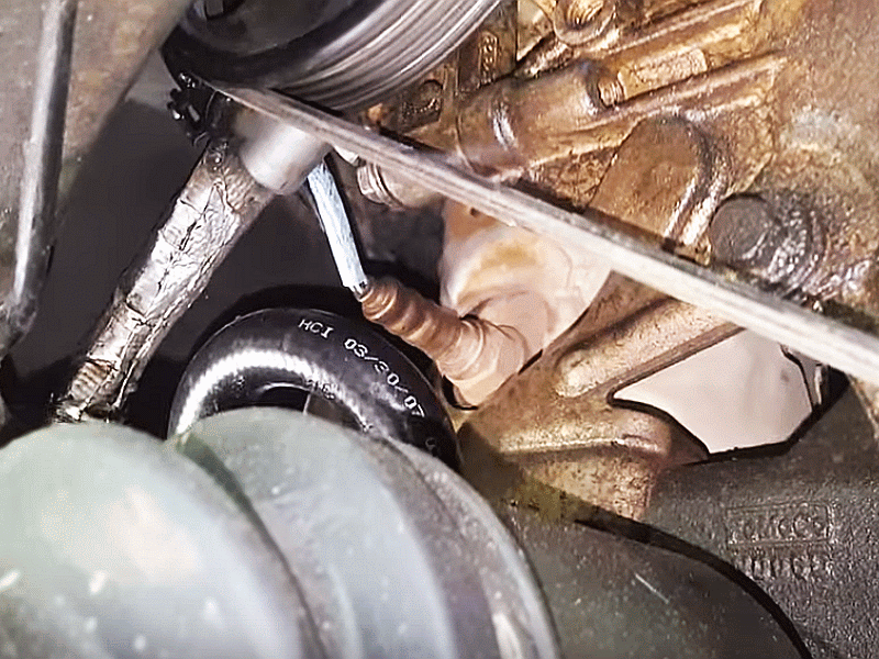

The 2 OxSensors on the front side (Bank2 OxSensor21 + OxSensor22)  are easy to access+change.
The 2 OxSensors on the back side (Bank1 OxSensor11 + OxSensor12) are harder to access+change,; see pic below.
