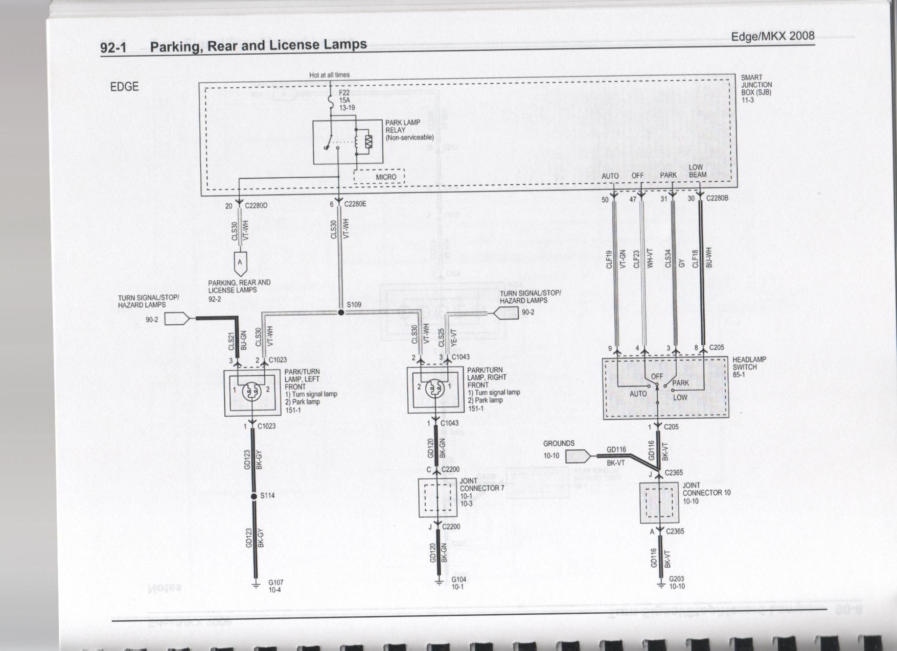

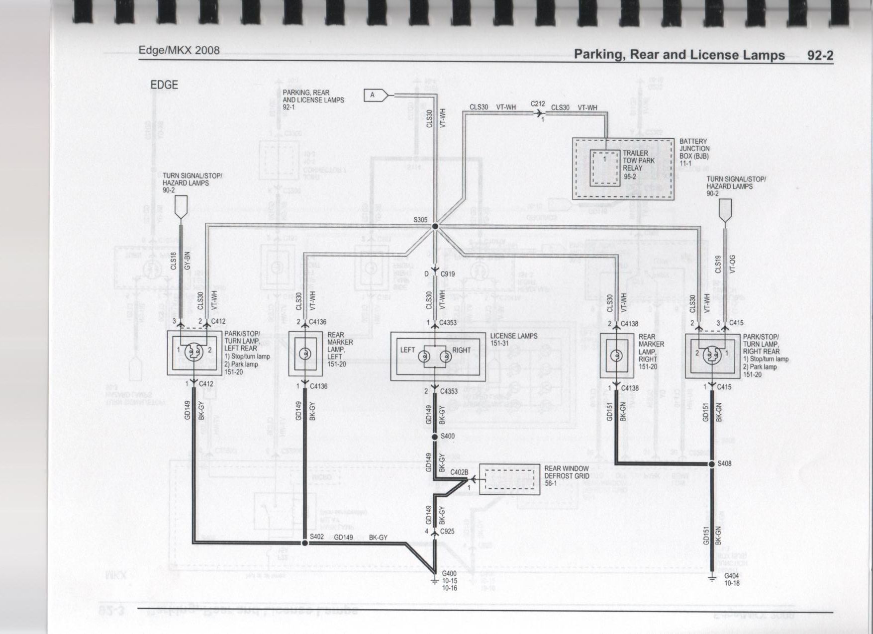

Derek,
I have no license plate lights. I have changed out the bulbs with no luck. Does your manual tell what fuse/circuit these are under? There doesn't appear to be anything else NOT working.
Thanks, John
Sorry for the delay in replying ( I sometimes forget about this thread ! ) I am at work right now and I'll check when I get home. Usually something like the license plate lights would be on the same circuit as something else ( just because they don't draw a whole lot of power ).
Derek,
Thanks, John
Hope this helps
No fair !! Beat me to it ... Here's the short ( no pun intended ) story. If your tail lights light up, so should your lp lights ( same fuse ). The LP lights share the same ground as your rear window defroster. So if that works, the ground should be good. Sorry, but it looks as though you'll have to trace wires. Any violet/white wire back there will give you power.
Thanks for the reply from both weasel and 07crush. If Ford can't fix this under warranty, I at least have a starting point.
7/22/2010 Update:
Turned out that a connector behind the tailgate cover had come loose. Mystery as to how that happened remains.
