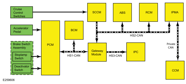

Cruise Control - System Operation and Component Description
System Operation
Adaptive Cruise Control
imagen2.dll?id=E259606_EN&w=650&t=JPG
Network Message Chart
  Network Input Messages - ABS Module
Broadcast Message Originating Module Message Purpose
ACC deceleration request  IPMA Used for cruise control automatic braking.
ACC stop mode request  PCM Used for ACC automatic braking.
Brake pedal applied  PCM Used for brake switch input.
Cruise control overide  PCM Driver overriding cruise control with accelerator pedal.
  Network Input Messages - CCM
 APP  PCM Used for accelerator pedal status.
ACC enabled  IPC Activates ACC
ACC switch comands  SCCM Used for speed control enable/disable, gap settings and operating mode request.
Cruise control override  PCM Driver overriding cruise control with accelerator pedal.
Ignition status  BCM Used for ignition switch position input.
Stability control event in progress ABS module Deactivates cruise control when requested.
Traction control event in progress
Vehicle yaw rate
Vehicle lateral acceleration  RCM Deactivates cruise control when requested.
Vehicle longitudinal acceleration
Vehicle configuration data  BCM Used for comparison checking adaptive cruise control configuration.
  Network Input Messages - IPC
ACC gap distance display  IPMA Data used to generate message center display indicating adaptive cruise control gap setting.
ACC follow mode display  IPMA Data used to activate the follow vehicle indicator.
ACC stop mode display  IPMA Data used to activate the stop and go auto mode indicator.
ACC resume display  IPMA Data used to activate the stop and go auto resume mode indicator.
Cruise control set speed display  PCM Data used to activate the select cruise control display.
Cruise control status  PCM Data used for cruise control indicator status.
  Network Input Messages - PCM
Steering wheel switch speed control request  SCCM Used for cruise control enable/disable and operating mode request.
Vehicle yaw rate
ACC Operation
NOTE: For a complete illustration of the ACC indicators and graphic displays, refer to the Owner's Literature.
The ACC system functions much like a standard cruise control system. The ACC system automatically adjusts the vehicle speed to maintain a set distance gap from the front of the vehicle and the vehicle in the same path of travel. When the ACC system is on and is following a vehicle or a vehicle enters the same driving lane, a follow vehicle graphic is displayed in the message center.
The ACC system does not function if the vehicle speed is below 20 km/h (12 mph). As the vehicle slows down during automatic braking, the ACC system discontinues braking at 20 km/h (12 mph). At that speed, an audible alarm sounds and the automatic braking from the ABS module is released. The driver must take over the vehicle braking control. (EDITED by Haz- See subsequent posts, below)
The cruise control deactivator switch (which is integral to the BPP switch) is an additional safety feature. When the brake pedal is applied, the cruise control system deactivator switch opens and removes the ground signal from the PCM input circuit, releasing the throttle and immediately deactivating the system.
The CCM monitors the yaw rate signal from the ABS module and compares it to the wheel speed and steering wheel angle signals. If the ABS module determines the yaw rate is invalid, the CCM disables the ACC . The message center displays the message COLLISION WARNING MALFUNCTION and/or ADAPTIVE CRUISE MALFUNCTION.
The CCM monitors the environment in front of the vehicle while active. If the radar beam is obstructed by a buildup of snow, ice, rain or other debris or the vehicle is driven in a desert environment with no other traffic for extended periods of time, the sensor triggers an "ADAPTIVE CRUISE NOT AVAILABLE SENSOR BLOCKED SEE MANUAL" message in the message center and disables the ACC . The ACC resumes once the obstruction is cleared and the radar is able to detect targets or upon a key cycle.
The ACC system does not engage properly if the front radar sensor is not aligned correctly and the message center displays FRONT SENSOR NOT ALIGNED. The ACC resumes once the radar is aligned and is able to properly detect targets.
The ABS module estimates brake temperature by monitoring applied brake pressure over a period of time and sends a message to the CCM when the estimated temperature is above a given threshold. An alarm sounds and the ACC system is deactivated until the estimated brake temperature returns to cooler operating conditions. This condition can happen in a hilly or mountainous driving terrain.
All CCM Diagnostic Trouble Codes (DTCs) are sent to the IPMA on a dedicated private CAN . The IPMA acts as a gateway.

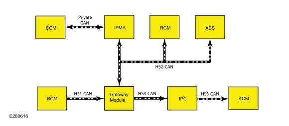

Collision Warning and Collision Avoidance System - System Operation and Component Description
System Operation
ACC With Pre-Collision Assist
imagen2.dll?id=E280616_EN&w=580&t=JPG
  Network Input Messages - ACM
IPC chime  IPC Data used to command a warning chime during possible collision event and audio mute so that the warning chime can be heard.
Collision avoidance and driver support camera status  IPMA Data used to command the pre-collision assist system fault status in the message center.
Collision avoidance and driver support chime status  CCM Data used to command a warning chime that a collision event is possible.
Collision avoidance and driver support radar blocked warning  CCM Data used to command a radar blocked message in the message center.
Forward collision chime request  CCM Data used to command warning chime during possible collision event. When this message is received, the IPC sends the audio mute message to the ACM .
Forward collision warning message request  CCM Data used to command warning chime and messages during possible collision event.
  Network Input Messages - IPMA
Collision avoidance and driver support radar status  IPMA Data used to communicate the function status of the camera in the IPMA .
Collision mitigation by braking deceleration request  CCM Data used to enable the brakes to slow vehicle speed when the pre-collision assist system determines that a collision is imminent.
Collision mitigation by braking brake pre-charge  CCM Data used to enable the ABS module to pre-charge the brakes to prepare them for rapid braking by the driver.
Pre-Collision Assist System Operation
The pre-collision assist system is offered as a camera-only option without ACC . An additional safety feature on vehicles equipped with ACC uses both the CCM (radar) and the IPMA .
The system is active whether the ACC system is on or off. If the system detects a vehicle, pedestrian or other object in the vehicle path of travel, the system provides three levels of functionality:
  • Visual and audible alert
  • Brake support
  • Active braking
Vehicles equipped with ACC uses object detection information from the radar sensor integrated in the CCM and the forward-looking camera in the IPMA located on the windshield, below the interior rear view mirror. The CCM and the IPMA scan a designated area in front of the vehicle. Network messages are sent between the CCM and the IPMA on dedicated CAN circuits, which determine whether an object, vehicle or pedestrian is in the path of travel, the approximate distance to the object and how fast the vehicle is approaching it.
Vehicles equipped without ACC uses object detection information from the forward-looking camera in the IPMA only and is located on the windshield, below the interior rear view mirror.
When the vehicle approaches the object, the IPMA sends a message through the GWM to the IPC module to turn on the red pre-collision warning indicator in the message center and to sound an audible alert. The IPMA also sends a message to the ABS module to pre-charge the brakes in order to prepare them for rapid braking. If the system determines that a collision is imminent, an active braking message is sent from the IPMA to the ABS module. The system reduces the gap between the brake pads and discs, applying the brakes to slow vehicle speed without driver intervention.
The pre-collision alert system uses image recognition software that differentiates shapes, which allows the system to determine if the approaching object is a vehicle or a pedestrian. If the camera does not recognize the shape as a vehicle or a pedestrian, the system does not provide full function. The system may not work properly at night, in direct or low sunlight, when camera vision is reduced due to weather conditions or due to a blocked CCM radar sensor. If the IPMA camera module is obstructed, the pre-collision system does not respond properly to pedestrians or stationary vehicles and reduces the ability to recognize moving vehicles. Unconventional vehicle types, pedestrians in groups or with complex backgrounds or partly obscured pedestrians may not be detected by the system.
The pre-collision assist system is active at speeds above 5 km/h (3 mph) and pedestrian detection is active at speeds up to 80 km/h (50 mph).
The pre-collision assist system has three levels of sensitivity detection (HIGH, NORMAL and LOW) that can be changed through the message center display in the IPC . The alert sensitivity is adjusted and active braking can be turned OFF in the IPC . The active braking function reverts back to ON at the next ignition cycle.
When a system fault is detected with the pre-collision warning system, the message PRE-COLLISION ASSIST NOT AVAILABLE SENSOR BLOCKED or PRE-COLLISION ASSIST NOT AVAILABLE is displayed in the IPC message center.
