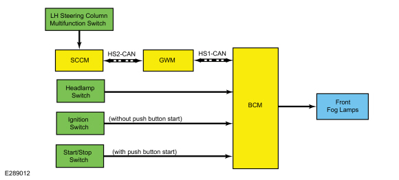

From the 2020 Edge Workshop Manual...
Moving your device cursor over capitalized acronyms should yield an onscreen full-word description.
Fog Lamps
System Diagram
imagen2.dll?id=E289012_EN&w=580&t=JPG
Fog Lamps
The front fog lamps can be turned on when the ignition is in ON, by placing the headlamp switch in any position except OFF and pressing the front fog lamp switch.
The BCM monitors the headlamp switch position by sending voltage signals on multiple circuits to the headlamp switch. There is one circuit for each headlamp switch position. At any given time, one of the signal circuits is switched to ground to indicate the headlamp switch position.
When the BCM receives input from the headlamp switch indicating a request for the front fog lamps, the BCM provides voltage to the front fog lamps.
The BCM also provides an Field Effect Transistor (FET) protection of the fog lamp output circuits. When an excessive current draw is detected, the BCM disables the fog lamp output circuit drivers.

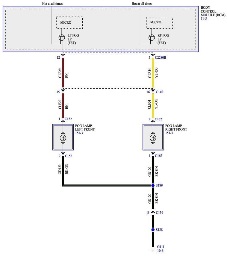

Fog Lamps Wiring Diagram

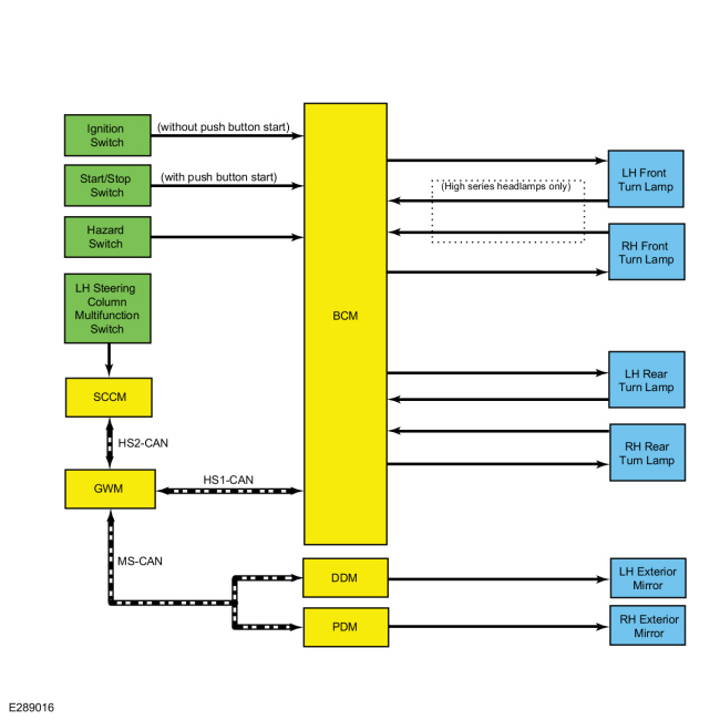

Turn Signal and Hazard Lamps
System Diagram
imagen2.dll?id=E289016_EN&w=650&t=JPG
Network Message Chart
  BCM Network Input Messages
Broadcast Message Originating Module Message Purpose
Turn signal switch status  SCCM Indicates the turn signal stalk position on the LH steering column multifunction switch (left/right lane change or turn signal on or off). The BCM activates the left/right turn signals based on this input.
  DDM and PDM Network Input Messages
Turn indication request  BCM A command to the DDM or PDM to activate/deactivate the exterior mirror turn indicator.
Turn Signals
The SCCM monitors the LH steering column multifunction switch position. When the LH steering column multifunction switch is in the LH TURN or RH TURN position, the SCCM sends a message over the HS-CAN2 to the GWM then the GWM sends the message to the BCM over the HS-CAN1 indicating a request for the LH or RH turn signal.
For high series headlamp turn lamps and all rear turn lamps, when the BCM receives a request for a turn signal, the BCM supplies on/off voltage to the appropriate turn lamp Light Emitting Diodes (LEDs). The turn lamps are Light Emitting Diodes (LEDs) and have an outage circuit that tells the BCM when the Light Emitting Diodes (LEDs) are inoperative. During normal operation, when voltage is applied to the turn Light Emitting Diodes (LEDs), the feedback circuit sends the same voltage back to the BCM through the outage circuit. If the Light Emitting Diodes (LEDs) are inoperative the BCM will not receive this voltage feedback through the outage circuit.
When the BCM receives a request for a turn signal, the BCM sends a turn indicator command message over the HS-CAN1 to the GWM then the MS-CAN to the door modules for the exterior mirror turn lamps.
When the BCM receives a request for a turn signal, the BCM supplies on/off voltage to the appropriate turn lamps.
If a front or rear turn signal lamp is inoperative, the IPC turn lamp indicator fast flashes at approximately 150 times per minute to indicate a bulb outage to the driver (the exterior turn lamps will still flash at approximately 70 times per minute).
The BCM also provides Field Effect Transistor (FET) protection of the turn lamp output circuits. When an excessive current draw is detected, the BCM disables the affected turn lamp circuit driver.
