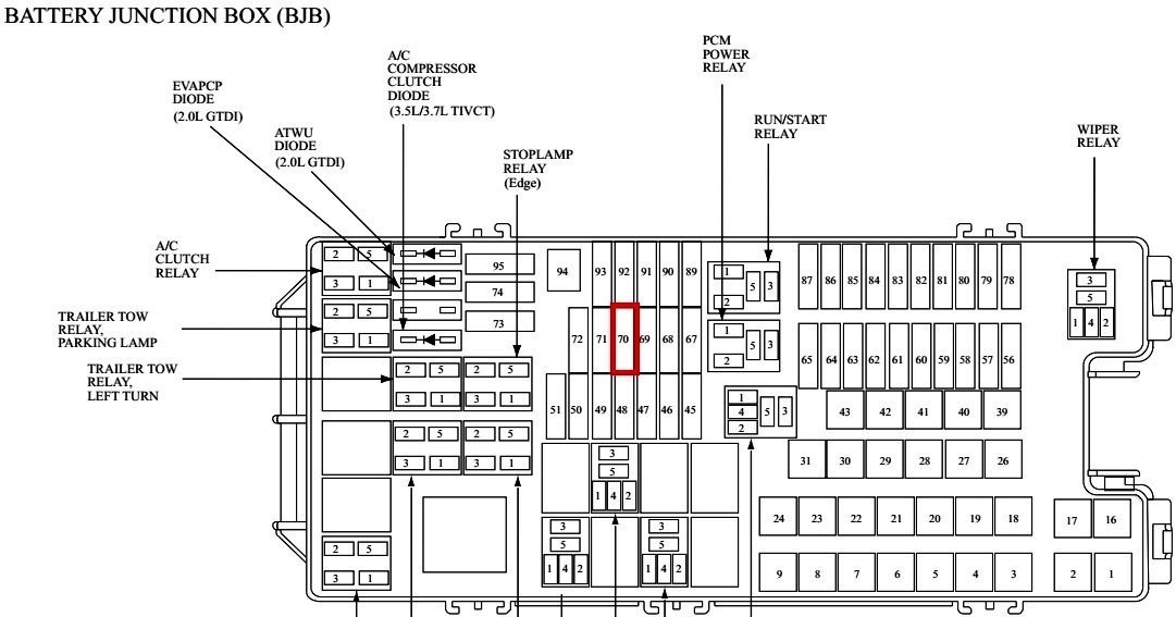

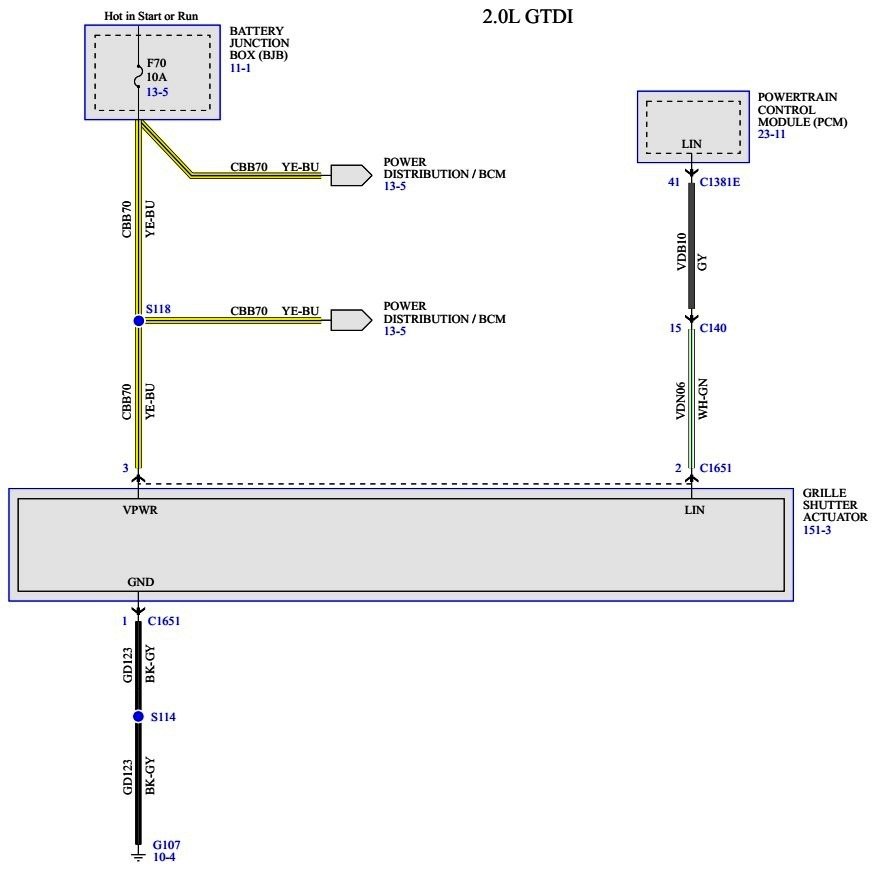

Active Shutter Actuator Wiring Diagram
627453679_GrilleShutterActuator-WiringDiagram-2013EdgeWorkshopManual.thumb.jpg.6bce34bab300d763015af97a4713139d.jpg
Underhood Battery Junction Box Fuse 70 Location
222973788_BatteryJunctionBox-ActiveShutterActuatorFuse70Location-2013EdgeWorkshopManual.thumb.jpg.a41f8a47a47c4ec459935bd67d8afa07.jpg
