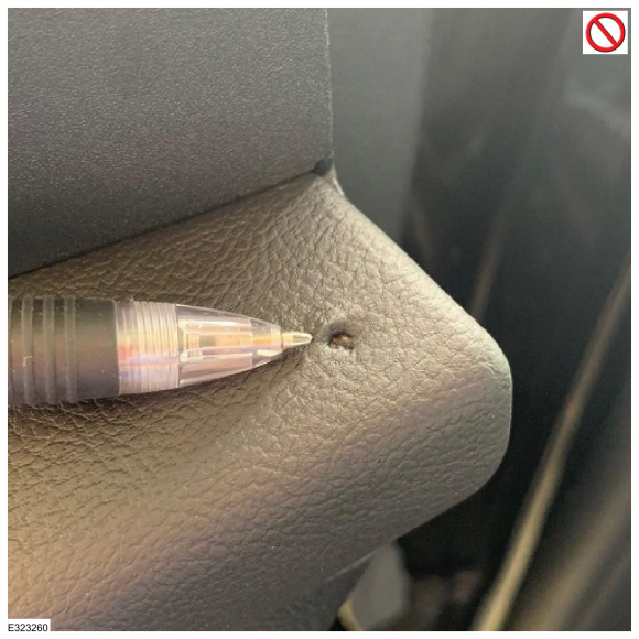

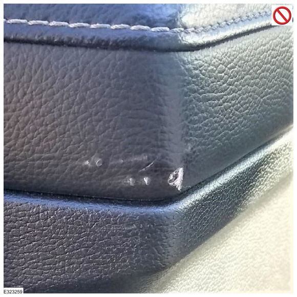

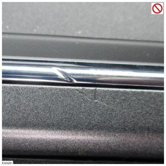

Cuts, Scratches, Scuffs, Tears Or Punctures (Non-warrantable) (Figures 1-3)
Figure 1
imagen2.dll?id=E323259_EUR&w=580&t=JPG
Figure 2
imagen2.dll?id=E323260_EUR&w=580&t=JPG
Figure 3
imagen2.dll?id=E323261_EUR&w=580&t=JPG

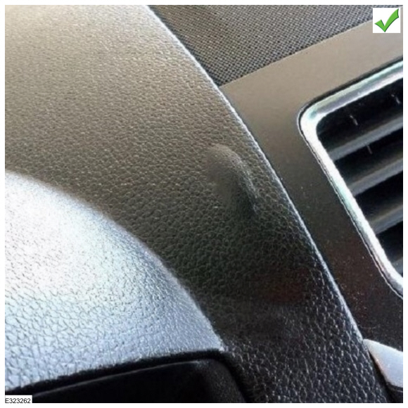

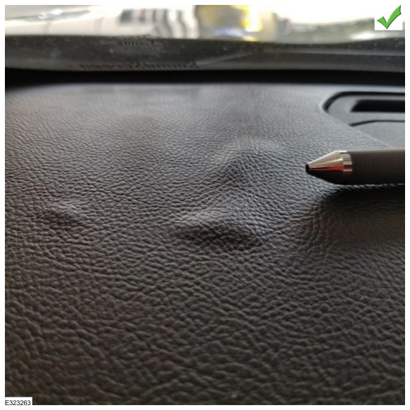

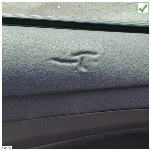

Bubbles (Warrantable) (Figures 4-6)
Figure 4
imagen2.dll?id=E323262_EUR&w=580&t=JPG
Figure 5
imagen2.dll?id=E323263_EUR&w=580&t=JPG
Figure 6
imagen2.dll?id=E323264_EUR&w=580&t=JPG

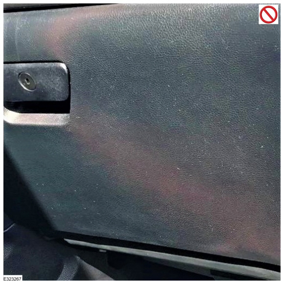

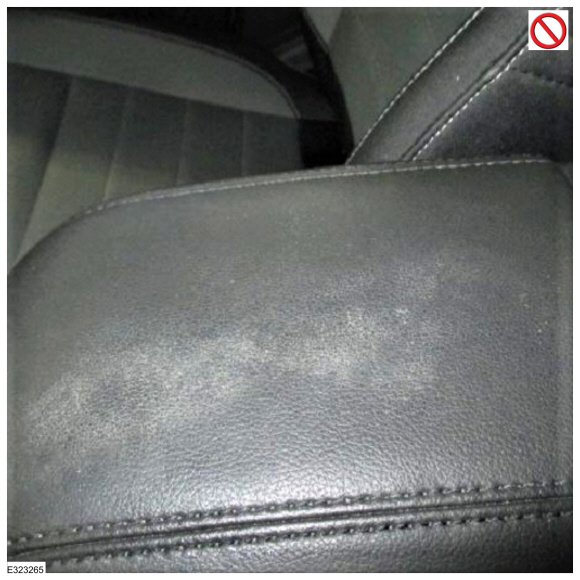

Stains From Chemical Influence (Non-warrantable) (Figures 7-9)
Figure 7
imagen2.dll?id=E323265_EUR&w=580&t=JPG
Figure 8
imagen2.dll?id=E323266_EUR&w=580&t=JPG
Figure 9
imagen2.dll?id=E323267_EUR&w=580&t=JPG

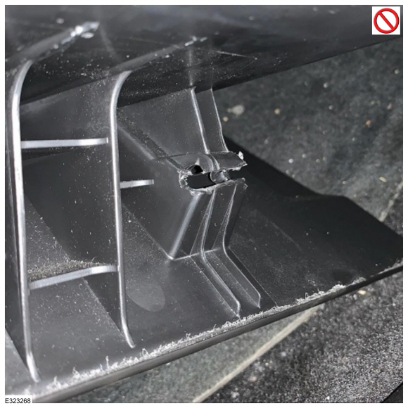

Broken Attachments (Non-warrantable) (Figure 10)
Figure 10
imagen2.dll?id=E323268_EUR&w=580&t=JPG

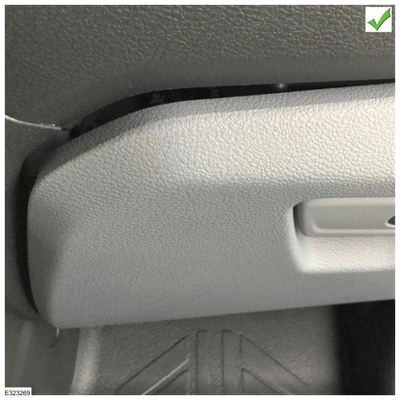

Alignment, Fit, Warped (Warrantable) (Figures 11-13)
Figure 11
imagen2.dll?id=E323269_EUR&w=580&t=JPG

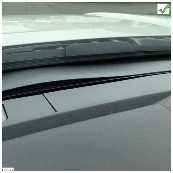

Warped instrument panel (Warrantable) (Figure 12)
Figure 12
imagen2.dll?id=E323270_EUR&w=580&t=JPG

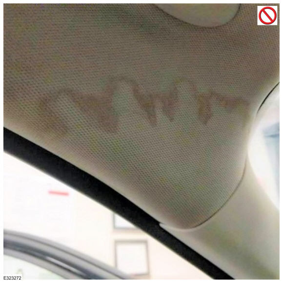

Stained Headliner (Non-warrantable) (Figure 14)
NOTE: Staining as the result of a defect would be covered as related damage.
Figure 14
imagen2.dll?id=E323272_EUR&w=580&t=JPG

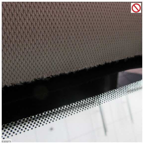

Rough Cut Headliner, Normal Appearance (Non-warrantable) (Figure 15)
Figure 15
imagen2.dll?id=E323273_EUR&w=580&t=JPG

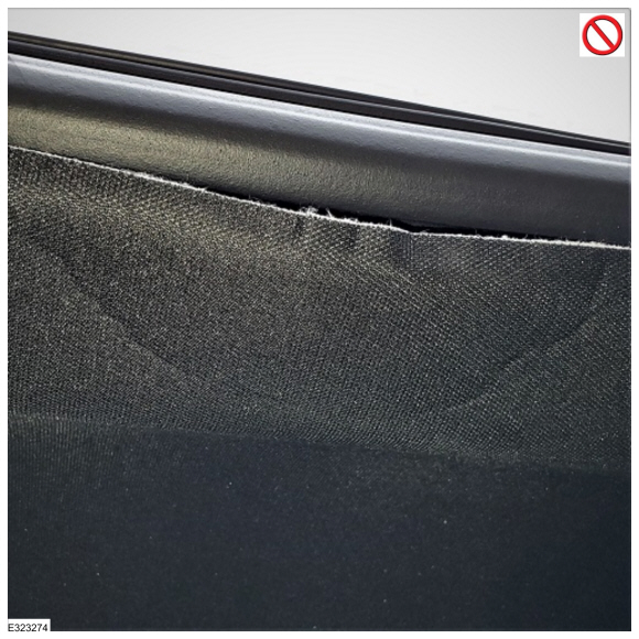

Creased Headliner (Non-warrantable) (Figure 16)
Figure 16
imagen2.dll?id=E323274_EUR&w=580&t=JPG

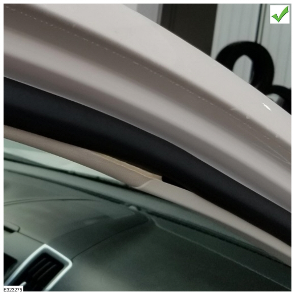

Headliner Edge Visible (Warrantable) (Figure 17)
NOTE: Complete removal/installation may be required to ensure proper alignment.
Figure 17
imagen2.dll?id=E323275_EUR&w=580&t=JPG

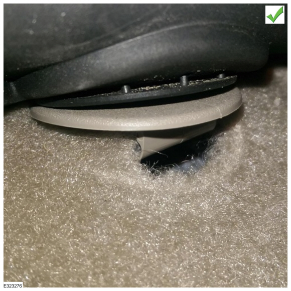

Loose Mat Anchor (Warrantable) (Figure 18)
NOTE: With no associated liquid staining present.
Figure 18
imagen2.dll?id=E323276_EUR&w=580&t=JPG

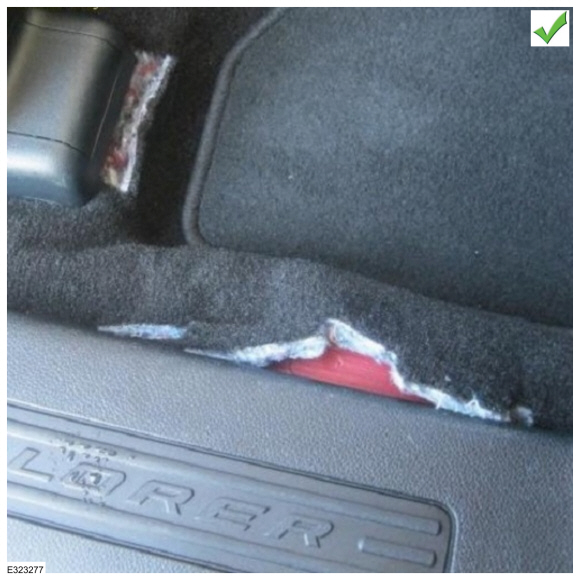

Loose Carpet (Warrantable) (Figure 19)
NOTE: Compete removal/installation may be required to establish a proper fit.
Figure 19
imagen2.dll?id=E323277_EUR&w=580&t=JPG

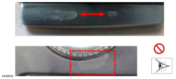

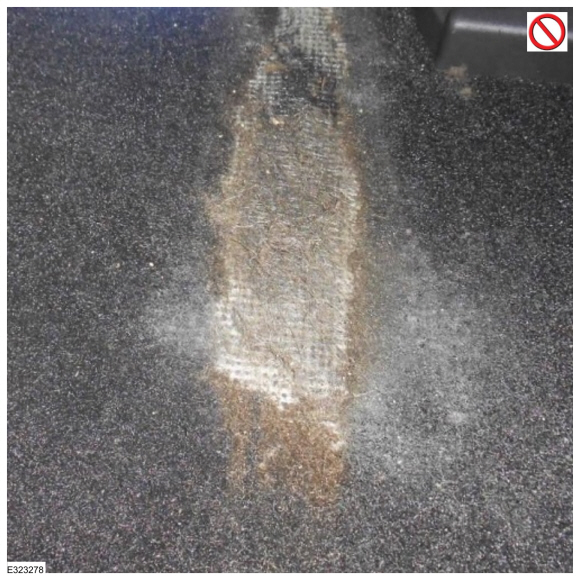

Stains (Non-warrantable) (Figure 20)
NOTE: Abrasive liquid may dissolve carpet fibers.
Figure 20
imagen2.dll?id=E323278_EUR&w=580&t=JPG

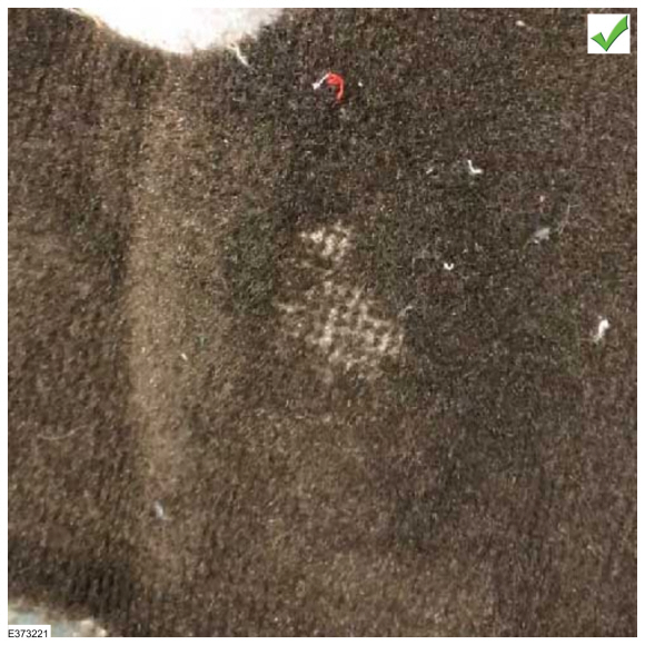

Carpet Matted Appearance (Warrantable) (Figure 21)
NOTE: This appearance may be the result of depressed fibers. This can be corrected by cleaning and reanimating the fibers using a carpet/steam cleaner (with temperatures under 350 degrees Fahrenheit) in the area. If a carpet/steam cleaner is not available, this procedure can be sublet out to a local interior/detail shop. If a shop is not locally available, a steamer such as Rowenta steamer or equivalent can be purchased and used to correct this condition. This tool purchase should be claimed as an outside service part (OSP).
Figure 21
imagen2.dll?id=E373221_EUR&w=580&t=JPG

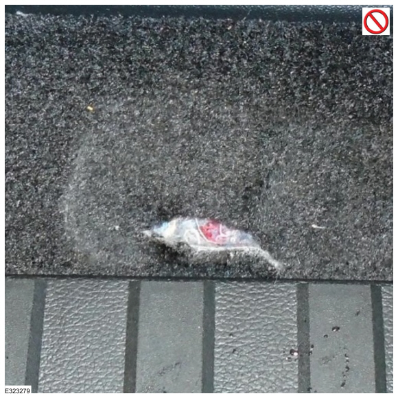

Carpet Cut (Non-warrantable) (Figure 22)
Figure 22
imagen2.dll?id=E323279_EUR&w=580&t=JPG

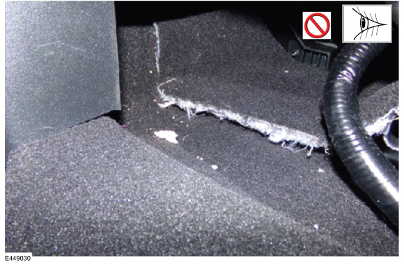

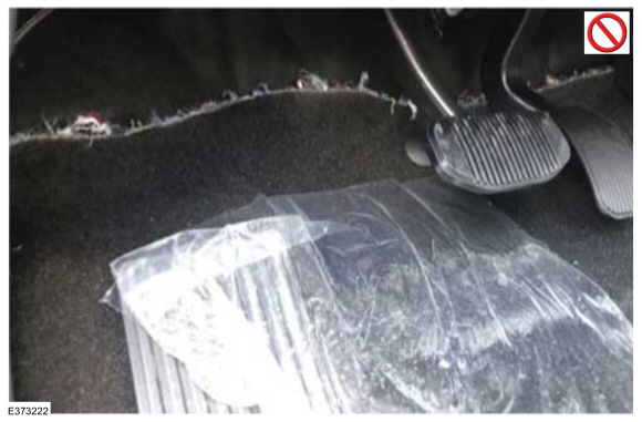

Carpet Edges Fraying (Non-warrantable) (Figure 23)
NOTE: Carpet edges are considered an unfinished edge and fraying at the edges is a normal appearance (frayed fibers can be trimmed for satisfaction) and does not require carpet replacement.
Figure 23
imagen2.dll?id=E373222_EUR&w=580&t=JPG

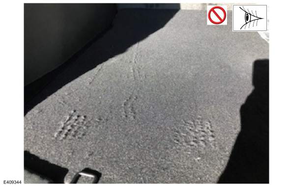

Carpet Pile Appearance (Non-warrantable) (Figures 24-25)
Frayed appearance can be corrected by mild brushing of the pile in a forward direction. This would be considered part of vehicle care and not eligible for warranty. (Figure 24)
Figure 24
imagen2.dll?id=E409344_EUR&w=580&t=JPG

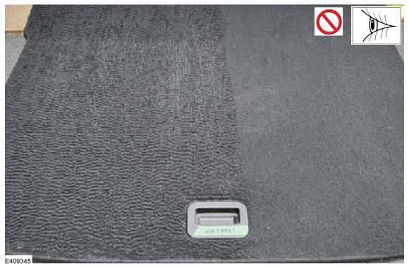

Frayed appearance on left side of image can be corrected by mild brushing in a forward direction as seen on the right side. (Figure 25)
Figure 25
imagen2.dll?id=E409345_EUR&w=580&t=JPG

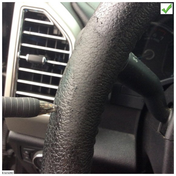

Leather Steering Wheel Worn Or Peeling (Warrantable) (Figure 26)
Figure 26
imagen2.dll?id=E323280_EUR&w=580&t=JPG

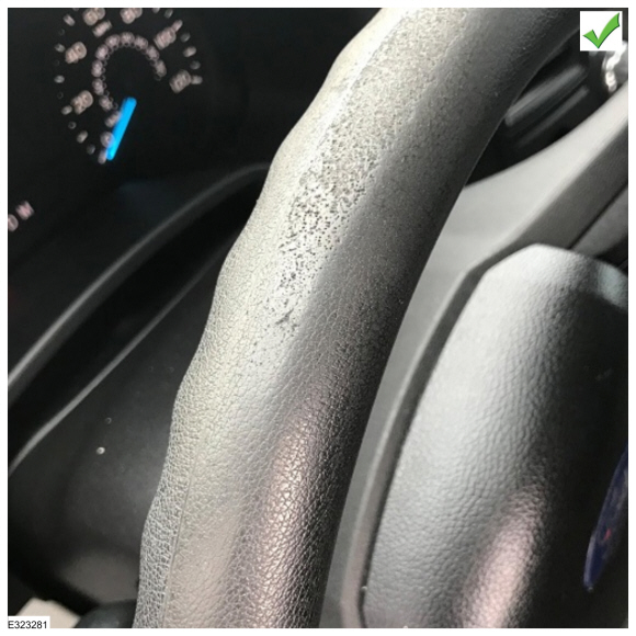

Urethane Steering Wheel Worn Or Peeling (Warrantable) (Figure 27)
Figure 27
imagen2.dll?id=E323281_EUR&w=580&t=JPG

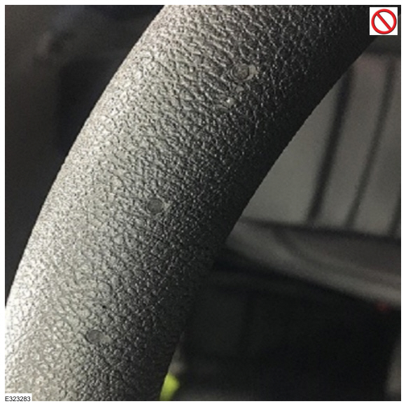

Urethane Steering Wheel Mold Marks (Non-warrantable) (Figure 29)
Figure 29
imagen2.dll?id=E323283_EUR&w=580&t=JPG

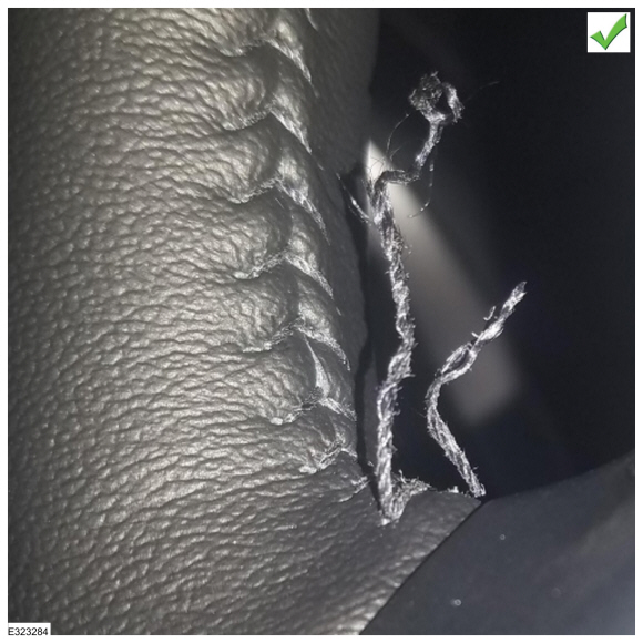

Leather Steering Wheel Loose Thread, Originates At The Knotted End Of The Thread (Warrantable) (Figure 30)
Figure 30
imagen2.dll?id=E323284_EUR&w=580&t=JPG

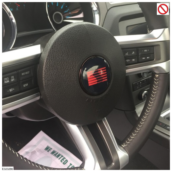

Steering Wheel Modification (Non-warrantable) (Figure 32)
Figure 32
imagen2.dll?id=E323286_EUR&w=580&t=JPG

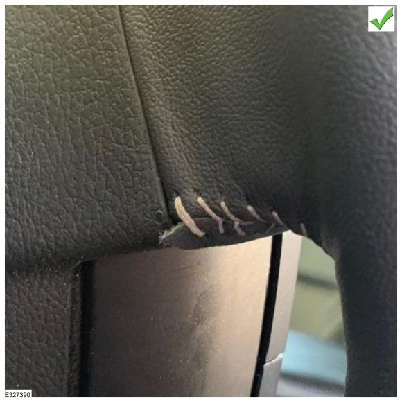

Steering Wheel Cover Repair (Warrantable) (Figure 33)
Can be repaired per the Workshop Manual.
Figure 33
imagen2.dll?id=E327390_EUR&w=580&t=JPG
